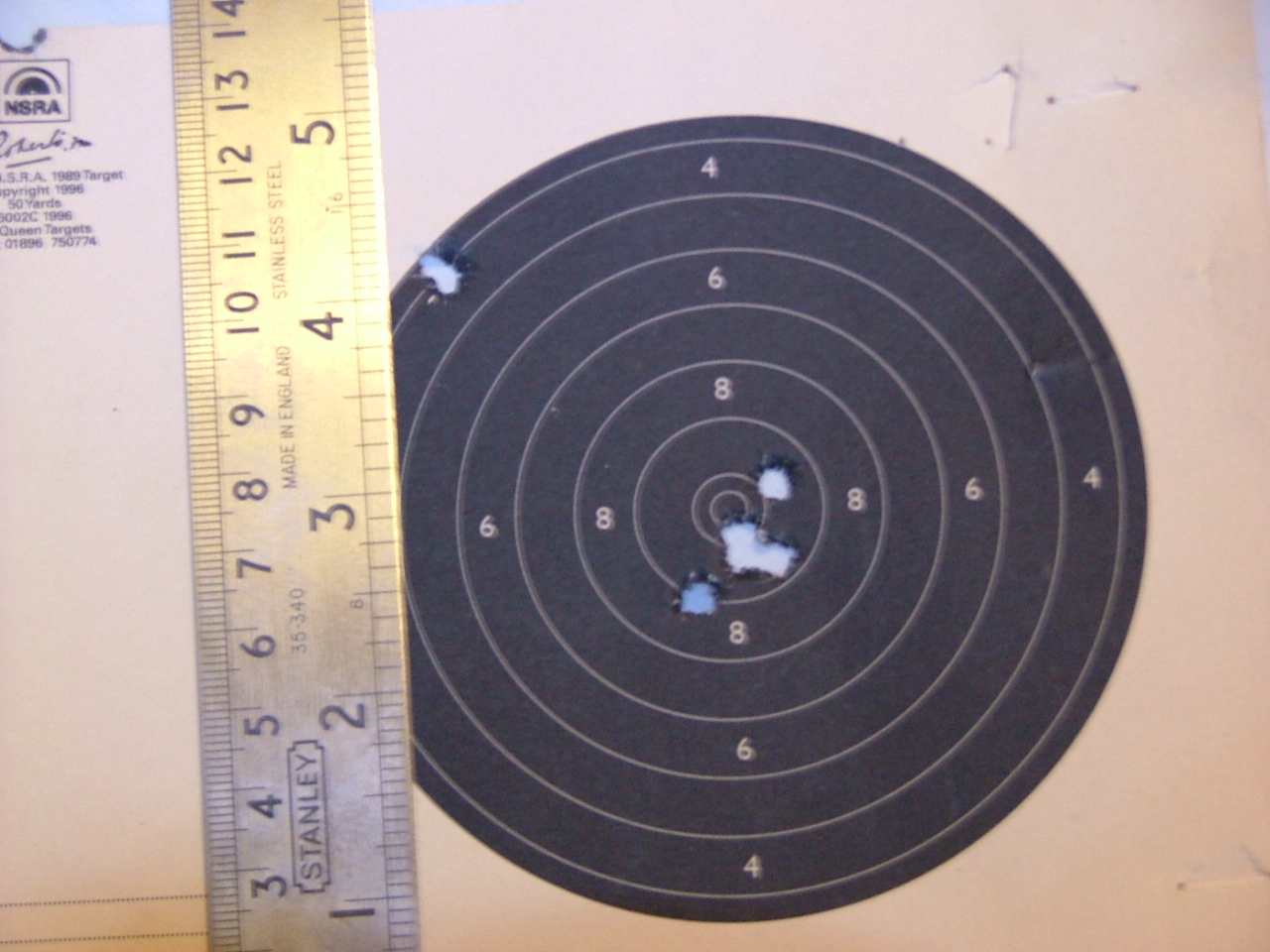

    Yes, use the 'flip up sight' it has a far smaller 'hole' so you are more accurate.
    Start at (say) 20 yards get on target, move out to 50 yards, get on target, move out to 75 yards, get on target move out to 100 yards and you'll still be on target.
    Unless you are using original MkVII military ammunition the sight calibrations will not be accurate, you need to make up your own crib-sheet for sight settings - you may find (just as an example) that at 50 yards you need the sights set at 200 yards, whilst at 200 yards you need the sights set at 250 yards.
    With the 'flip-up' sight my Savage is capable of under 1 MoA (when I do my part)
    2 warming rounds at 10' Oclock then 5 rounds.
    Wind 10mph right to left
    Lying Prone with only elbow support.
    PPU 174gr BT FMJ factory loaded ammunition.
