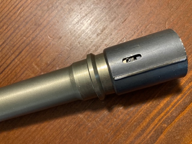

    They are the same as the AR10, those roll pins go in and the end slips off. One side would do perhaps, then when cleaned you tap them back from outside. Make sure they're flush before using them.
    (Sorry, not familiar with the AR10.) The role pin is accessed only on one side. If the pin is tapped in - clear of the piston and piston is removed I assume the pin is then free to fall out? After disassembly the pin is re-inserted and tapped back in?
  3. #42
    Today @ 10:06 AM
    31,009
    04-28-2025
    09:33 AM
    Quote Originally Posted by Madcap View Post
    Yes. It shouldn't be too magic either. Almost just that easy.

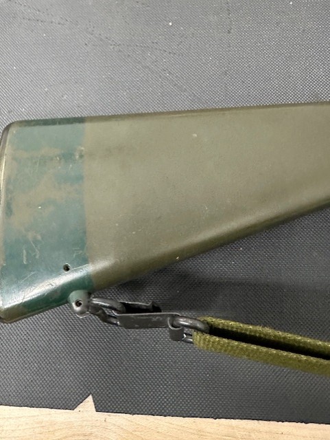

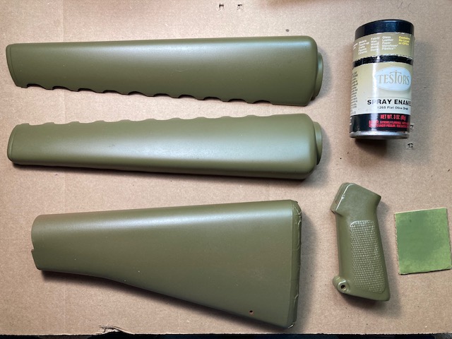

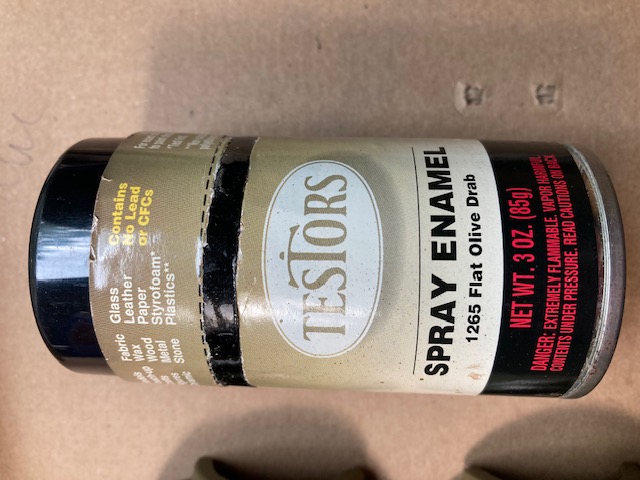

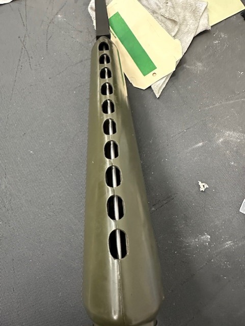

    Paint
    I had an old can of "Testors 1265 Olive Drab Flat Spray Enamel" I've had several years. After a few minutes of shaking, it sprayed well enough for a few light coats, and it looks like a perfect match. Another can is on order and that should finish it up.
    Photos include initial first light coats the Testors OD Flat that I that look very good. The first can is getting low and I don't want it to spit so I have another small can of the same stuff on order.
    The independent square paint swatch is the ANA 611 that was ordered for comparison. It isn't very accurate compared to its online example that was offered.
    The first coats of the Testors OD will be lightly sanded and given one or two finish coats and cured. Then the receivers can be assembled, after I find a Colt full-length buffer tube and spring.
    The last couple photos are a handguard and stock of an original USAF 601 a friend took for me. I t appears the Testors OD enamel model paint a perfect match.
    The Brownells 601/602 dimpled front pin came it the mail and fits perfectly. That only leaves a safe/selector switch to be drilled and fitted to add the correct period detail hardware.

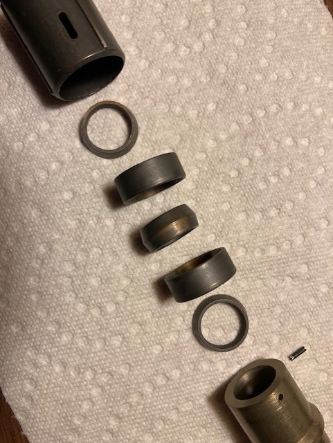

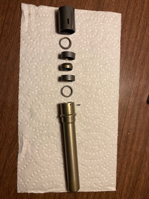

    Egdewater Buffer Disassembbly
    The internal parts of the Edgewater Buffer
ID:	136001   Click image for larger version
  9. #47
    Today @ 10:06 AM
    31,009
    04-28-2025
    09:33 AM
    There you go...

    There you go...
    Even after thinking it out several times I was hesitant, not knowing some unique engineering method would mess up a very difficult item to replace if I wasn't cautious. I thank you for your alway continued advice and assistance.

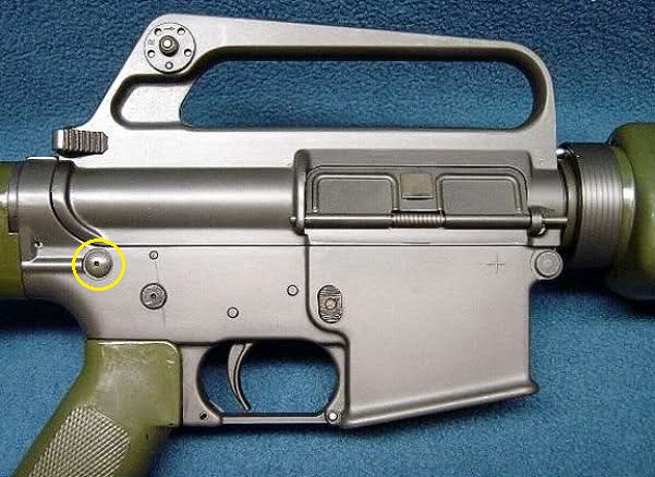

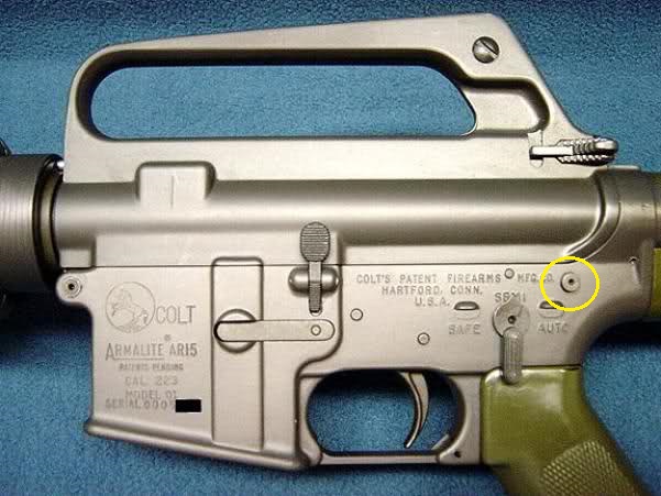

    Dimpled Taedown Pin
    Jim - or anyone have experience drilling a standard takedown pin to convert to the earlier one with divot or dimple?
    Thanks
ID:	136070   Click image for larger version
  13. #50
    Today @ 10:06 AM
    31,009
    04-28-2025
    09:33 AM
    Those are hard so stand by...and a lathe would work best too.
