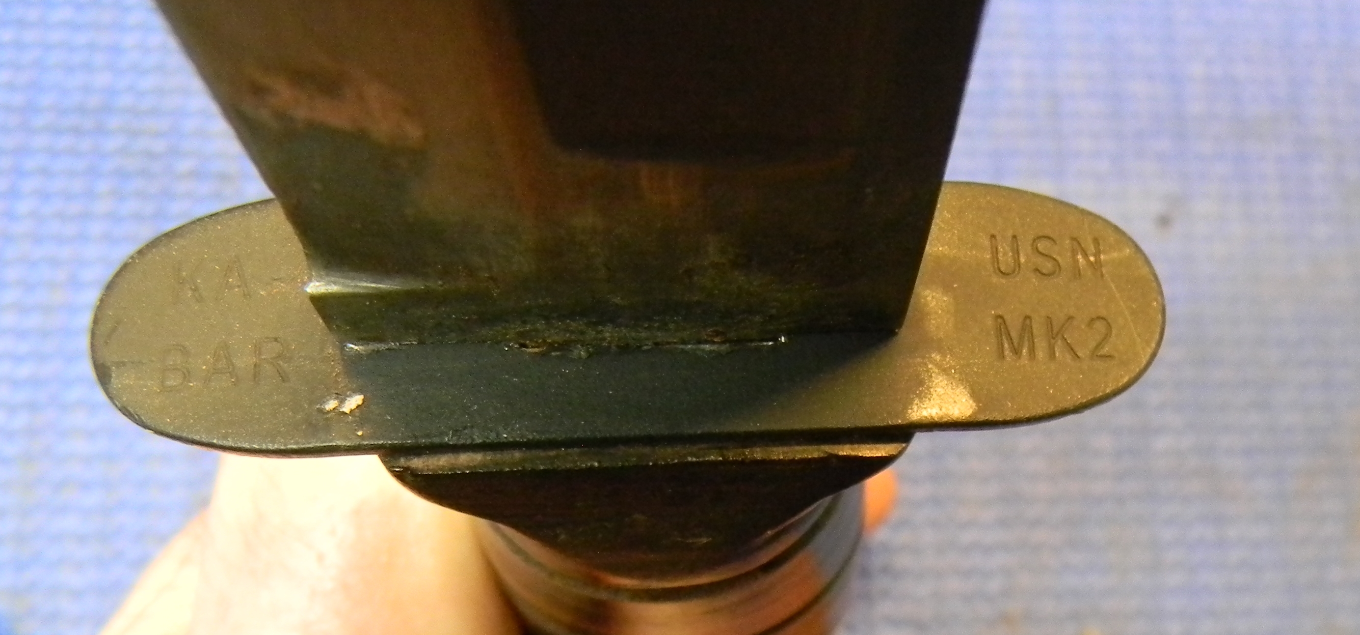

    Engraving turned out well

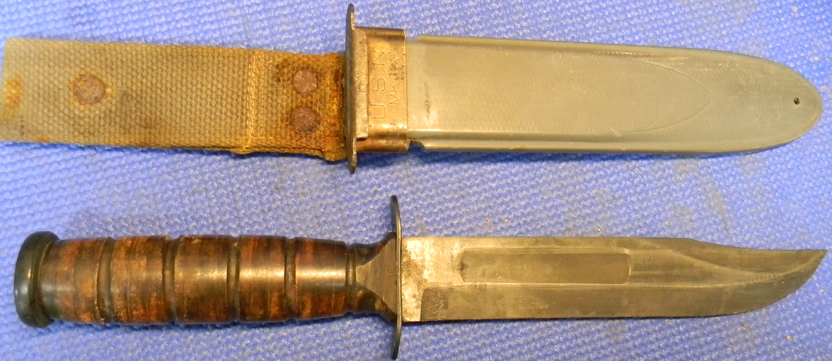

    Fairly pleased with the result. Pleased with the distressed handle. The slots in the handle could be truer.

    HOH, That looks great! Good work--
    Yes, very nice. Very close to original. Here's mine...

    Turned nothing into something. The handle taper/flare at the pommel is off and the handguard at the blade has a gap though not loose. The engraver matched the font and placement very well on the new handguard though slightly shallow. Very rewarding project which I hope to repeat if I can find another donor. Ka-bar is to be congratulated for providing the rehab kits at such a reasonable price.

    It looks really good. How exactly did you polish and cut the leather?
  14. #130
    06-30-2025 @ 05:46 PM
    4,093
    07-02-2025
    08:31 AM
    Built a jig an(essentially a long tang with no blade) waxed the tang to ease installation and removal and glued and clamped the disks together with crazy glue. I then sanded it down on a 1" table top belt sander (Harbor Freight) with increasingly fine grit taking frequent measurements to ensure profile matched that of an original sample . Final sanding with jig held in a vice using 1" sandpaper alternating sides. Relief cuts using a chainsaw file. The groves are the weak spot must be a better way to increase precision. The ability to take the glued handle of and onto the jig is very helpful. Died the leather with alcohol based leather stain. The dye might have worked better if I had soaked in stain before I glued them? Finished off with a coat of beeswax and buffing with a strip of towel in the same manor as the final sanding. I hope this proves helpful to others.
