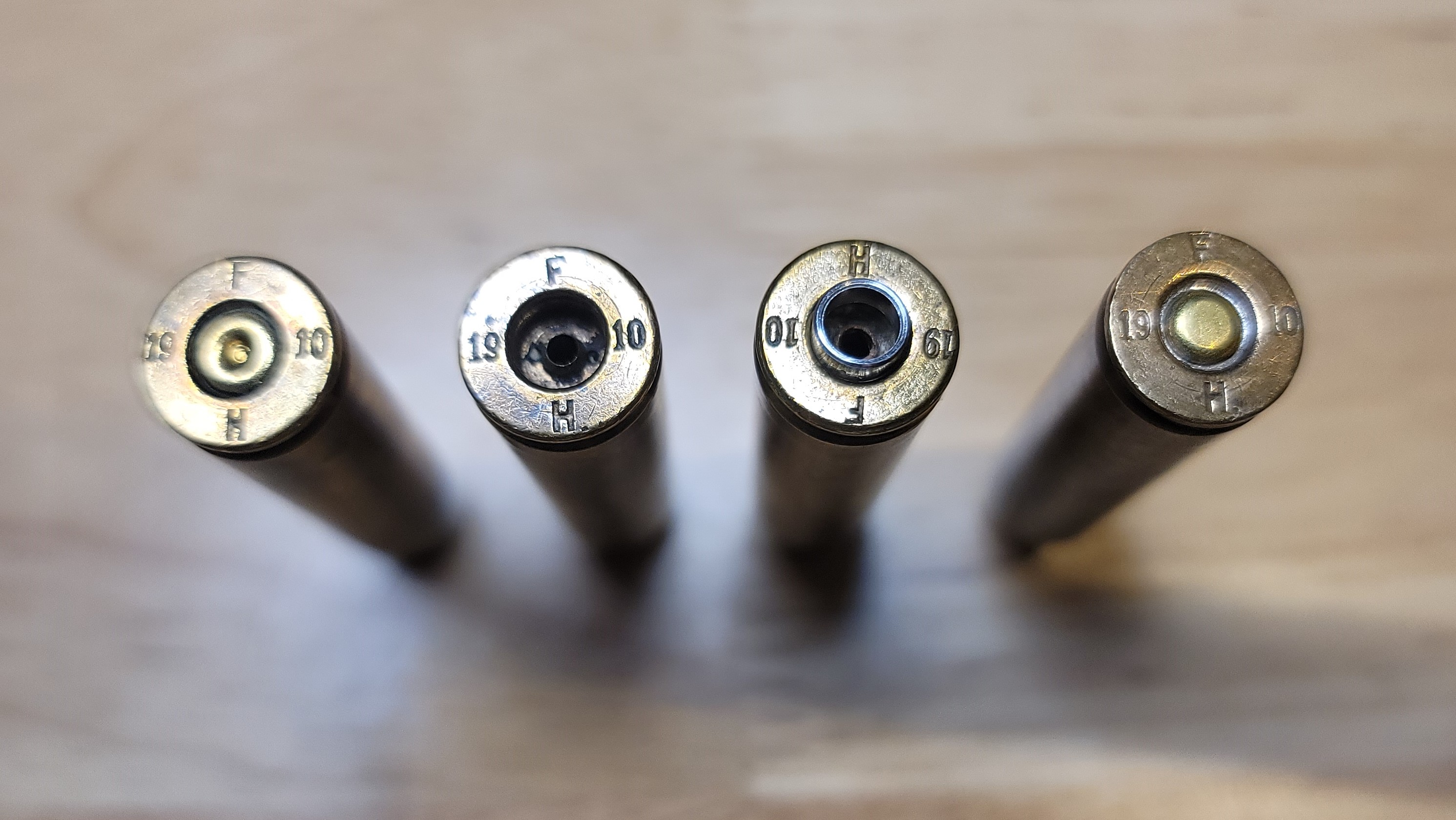

    Quote Originally Posted by Strangely Brown View Post
    Given the rounds will be Berdan primed is this even a possibility?
    These are Boxer primed with a 4-stab crimp.
    I think I will bang a primer on bright steel to check if corrosive. Assuming it goes bang, of course.
    Then reload the case.

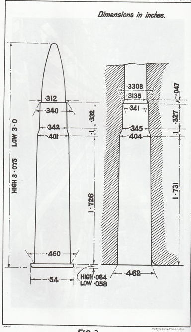

    Quote Originally Posted by Steve762 View Post
    Question: Is commercial .303 from the UKicon and Common Wealth countries thin compared to that countries .303 military?
    In the UK I think the most common, non US, commercial 303 is Prvi Partisan (PPU) which is manufactured generally to the mil-spec, and that is not just wall-thickness, but rim thickmess as well.
    The mil-spec for rim thickness is 0.064" max, 0.058" min, however SAAMI specify 0.064 and 0.054" min.
    Much of the US 303 appears to be manufactured to SAAMI standards and towards the 'bottom end' of the dimensions - in fact some of it would be rejected if the mil-specs were applied.
    The difference between the two (in the picture) would increase the 'effective headspace' by about 5 thou.
    I wonder how many thousands of tons of brass are saved by manufacturing to minimum tolerance - built to a price !
    Thanks for the info on rim specs.
    Here are the full (mil) dimensions of the 303 cartridge and the chamber
    And, for comparison the SAAMI drawings :
    Yes, SB there are a couple of companies that make Berdan to Boxer conversion kits. https://22lrreloader.com/products/be...reign-domestic is one that I use.
    https://www.milsurps.com/images/impo...artridge-1.jpg
    it seems as if the mil drawing has not come over :
Name:	Military MkVII Dimensions.png‎

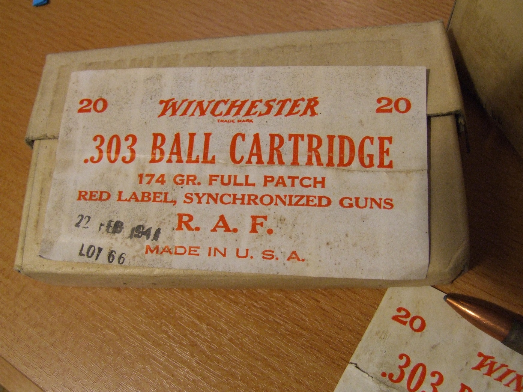

    Here's a box of the Winchester Red label .303 for synchronised guns!

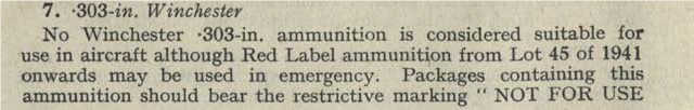

    Quote Originally Posted by 30Three View Post
    Attachment 138415
    But it was 'last resort' ammunition and only to be used in an emergency ;
