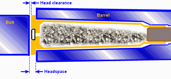

    An animated 'gif' produced some years ago by forum member Parashooter, showing why / how a sloppy head space COULD cause separations, particularly when combined with thin wall (SAAMI) cases.
    Your headspace could be in spec at 70 thou, but using a thin rimmed case of (say) 58 thou means you have a 12 tho 'head clearance' allowing the case to stretch by 12 thou, and the weakest part (just above the web) goes 'pop'.
    For me it is an excellent learning aid.
    And of course the case is often is not fully enclosed in the chamber when ignition occurs; the amount of unsupported case wall at the base in such instances is more like the final position shown in the GIF.
    And just off hand I suspect that larger chambers in conjunction with excessive heads space are even more prone to this kind of separation as the farther the case has to expand before chamber wall adhesion takes effect the longer the rearmost portions of the case are exposed to the full(?) pressure of the charge.
