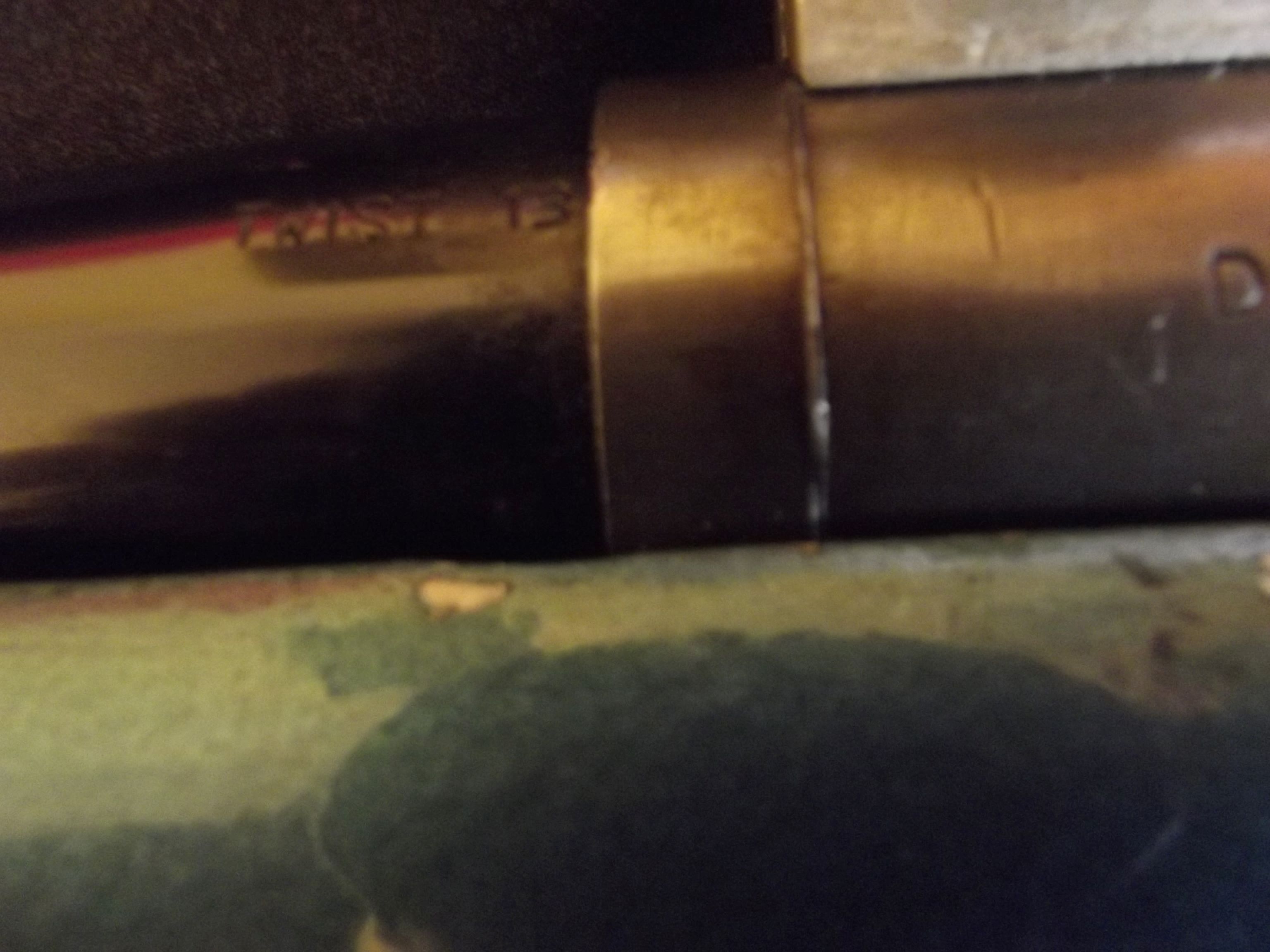

    OT, but related, sort-of. Omark 44
    Just scored a couple of barrels for the Omark 44. Old-style, integral locking lugs and all.
    Both came out of waxed paper wrappers and appear to unused.Interestingly, the Lithgowicon-made, hammer-forged Black Mountain tube is about an inch shorter than the "Sportco / Omark one
    Does anyone have any record of the twist rates and how, if at all, that might be marked on these barrel.
    I know early barrels were 1:14 inch, RH, but that changed to 1:12" at some time.
    A couple of "revival projects" await. One of these is intended for FTR competition ("Poverty-Pack division) and thus may end up being fed longer, "VLD" style bullets which may not like a 1:14" twist, even from a 27" barrel.
    Any thoughts?

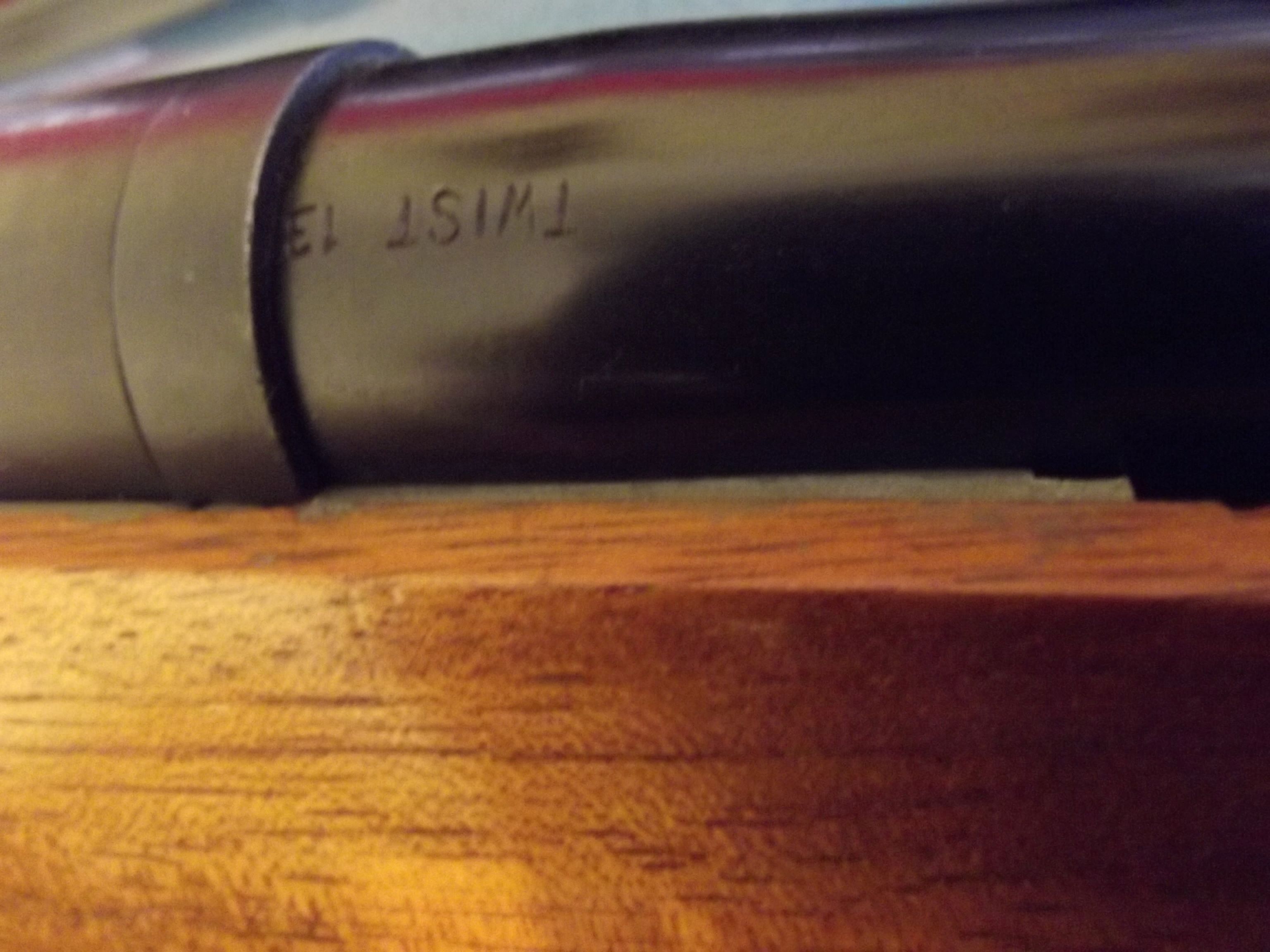

    Bruce, Early barrels were 1.14 twist designed to stabilise the 144gr. military round on issue.
    When the L2A2 round was disallowed in competition and replaced by the F4 round at slightly lower velocity the 1.13 twist began appearing.
    By the time reloading became the norm and the 155gr. projectile appeared a 1.12 twist was needed to accommodate the increases in barrel length and heavier projectiles.
    The twist was usually stamped on the R/H side on Sportco/Omark barrels and varied from side to side on Black Mountain,
    I would need to check, but I think Shultz and Larrsens were on the left.
    The three twist rates all proved suitable for competition.

    Bumm drumed you Bruce, played on my mind all night so had a look at my seven remaining Omarks and a read of my Armourer notes.
    No twist on new barrels, to be stamped if requested......in line with serial number for both right and left handed actions.
    This was due to final lockup position determined by recoil plate thickness on assembly setting up both headspace and primary extraction.
    I even recall one twist stamp being at six o'clock when screwing a used barrel.
    I was in the habit or changing barrels at 5000 rounds, as was the practice with hard jacket projectiles.......then came reloading and suddenly the softer jackets with longer bearing surface gave these old girls a new lease on life......so now I have 15 or more spare barrels with low round count plus the stainless ones, I adapted a few to fit mausers, bought my new barrels as blanks, machined a long reinforce when profiling and kept rechambering when accuracy was lost.
    One barrel in a target rifle has had two rechambers and about 20,000 rounds and is just showing slight crazing in the throat, a rechamber and recrown would get more use out of it as it is just under 29 inches, starting at 32inch long.
