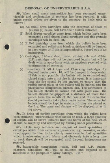

    Quote Originally Posted by togor View Post
    No pierced primers. All of the rims were right at .060", some Win '41 primers leaked
    Once the rounds started exuding it was the death sentence - irrespective of age.
    They would be de-bulleted and fired off and the brass and bullets sent for recycling.
    I recall reading in this forum that some degree of primer leakage was normal for .303 military ammunition, especially in wartime. Is it not so?
    You can never tell 'what those foreigner armies get up to ', but as you can see from the document I posted - the Britishicon army, on its regular inspections, would reject rounds exhibiting signs of corrosion or exudation and they would be sentenced for scrap / disposal.
    There are pages and pages and pages in the armourers manuals explaining when, where and how often ammunition must be checked and 'proved' (quantities from each batch fired and performance measured)
    It's not much use having 10 million rounds in the stores if half of it is beyond its use by date, has swollen cases, leaking primers and, if it actually fires, is innacurate.

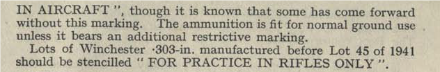

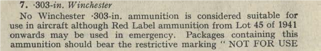

    Fair enough as far as that goes. Very sensible.
    But from what I can tell, as a reloader and engineer, the 1941 Winchester primers are very hard, and the 4 primer stabs are fairly aggressive. I think the primers in some cases are getting deformed enough to permit small amounts of leakage. Most likely it was this way from the beginning.
    Winchester ammunition has a very poor reputation in Britainicon.
    Lots prior to 1941 were banned from front line use and relegated for 'practice use only' and post 1941 the dimensional variation meant, except for the Red Label, it was forbidden to be used in aircraft, but could be used by infantry.
