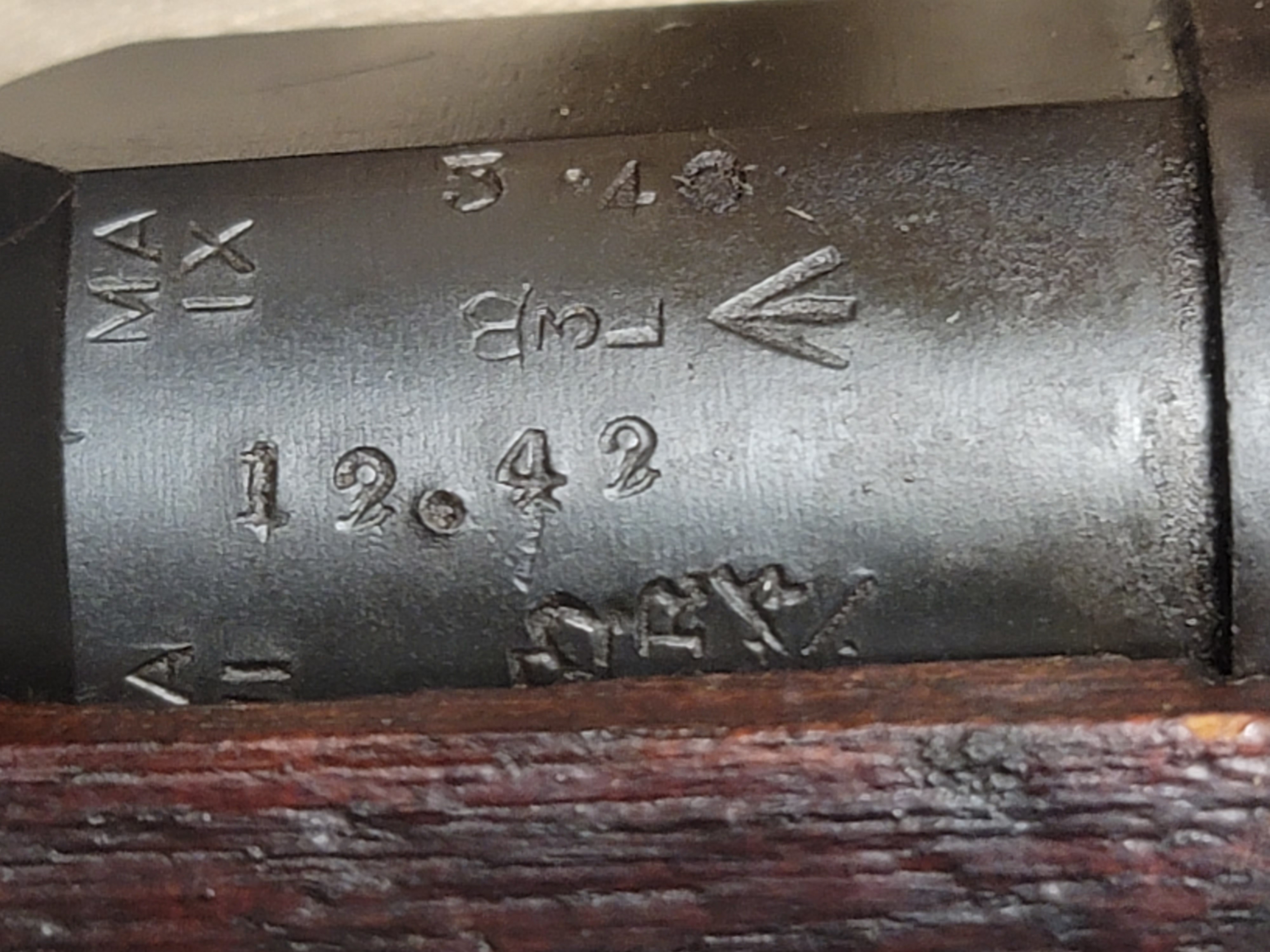

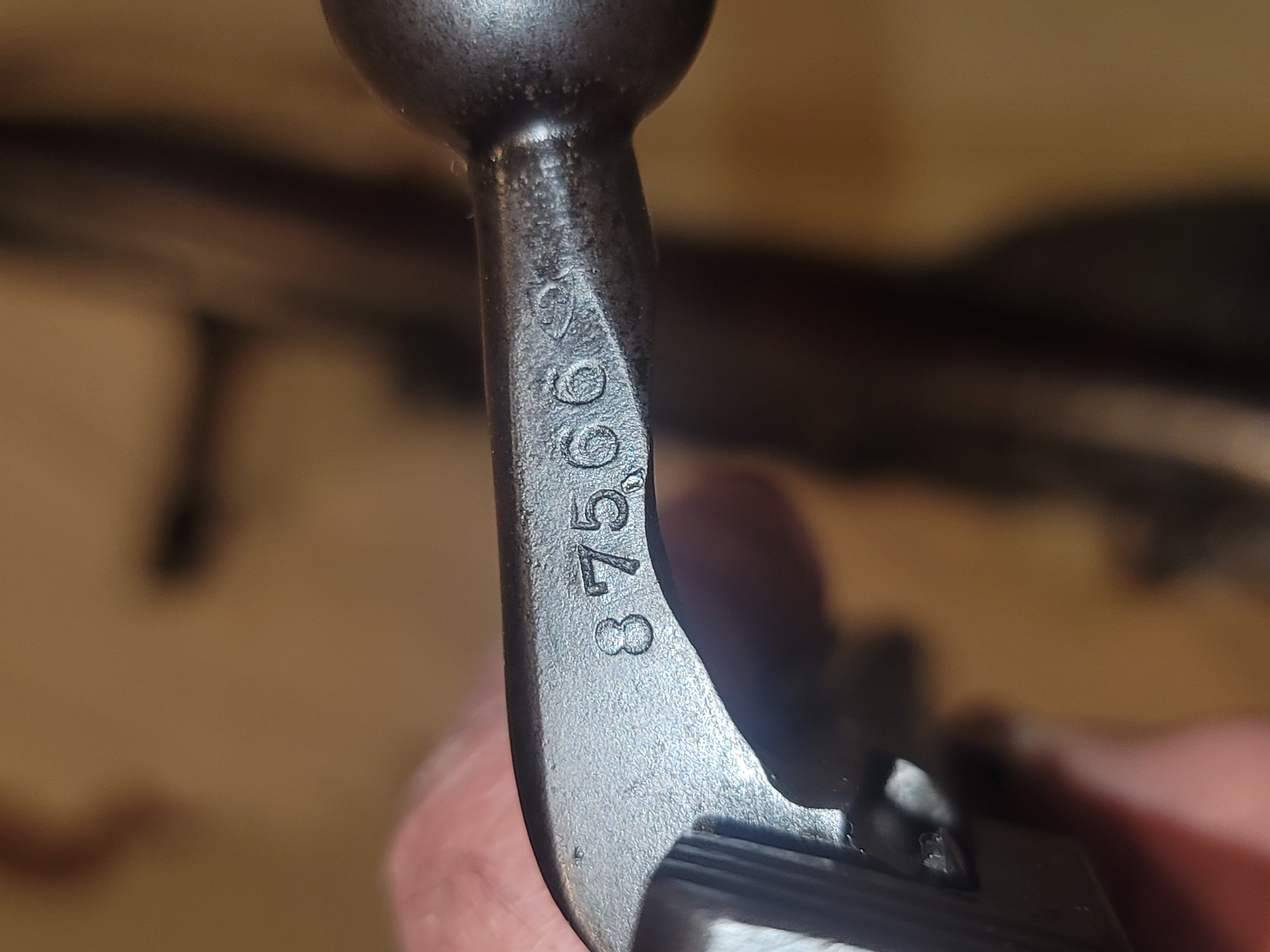

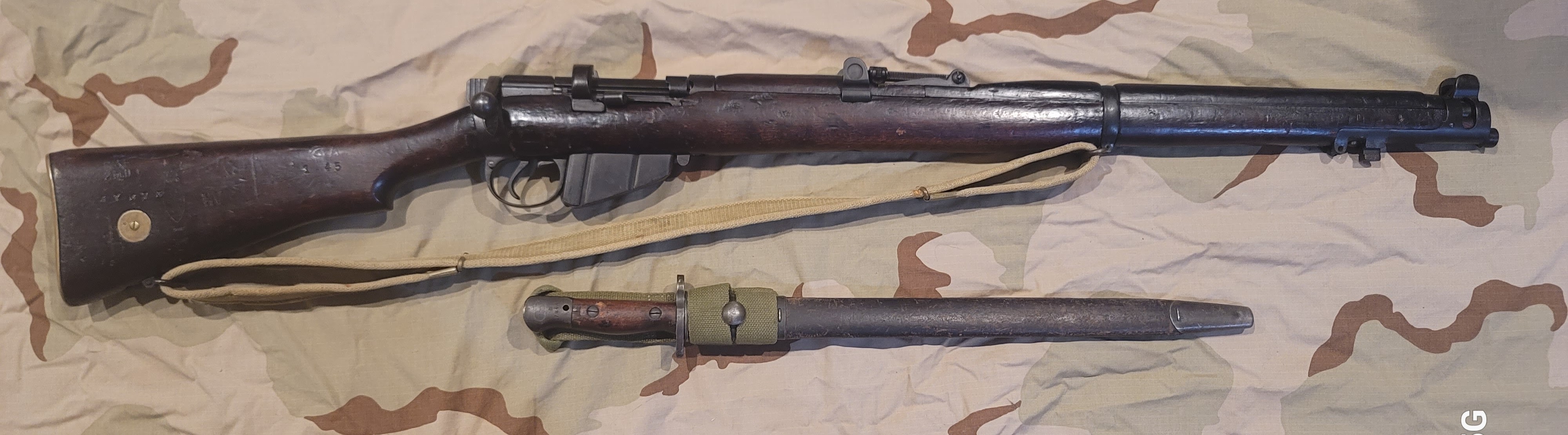

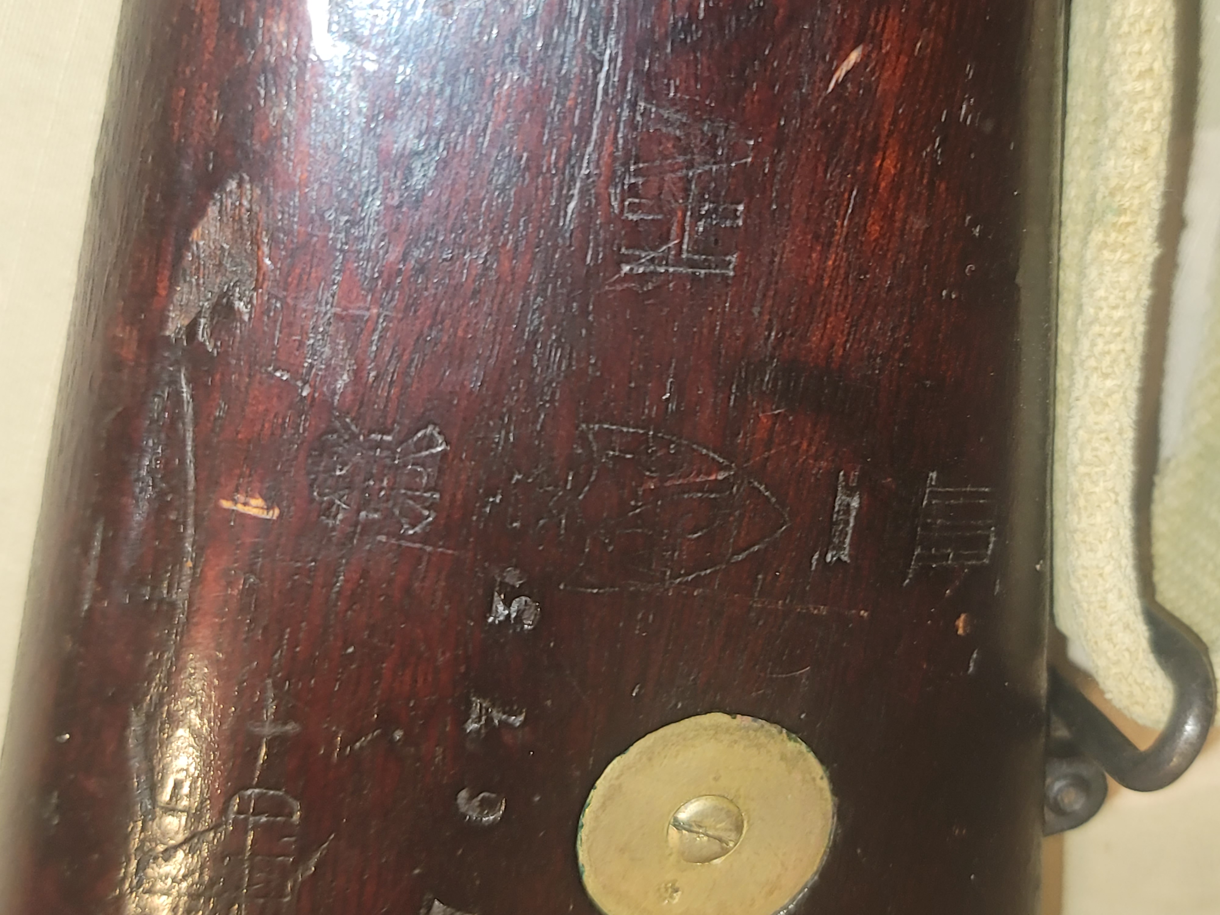

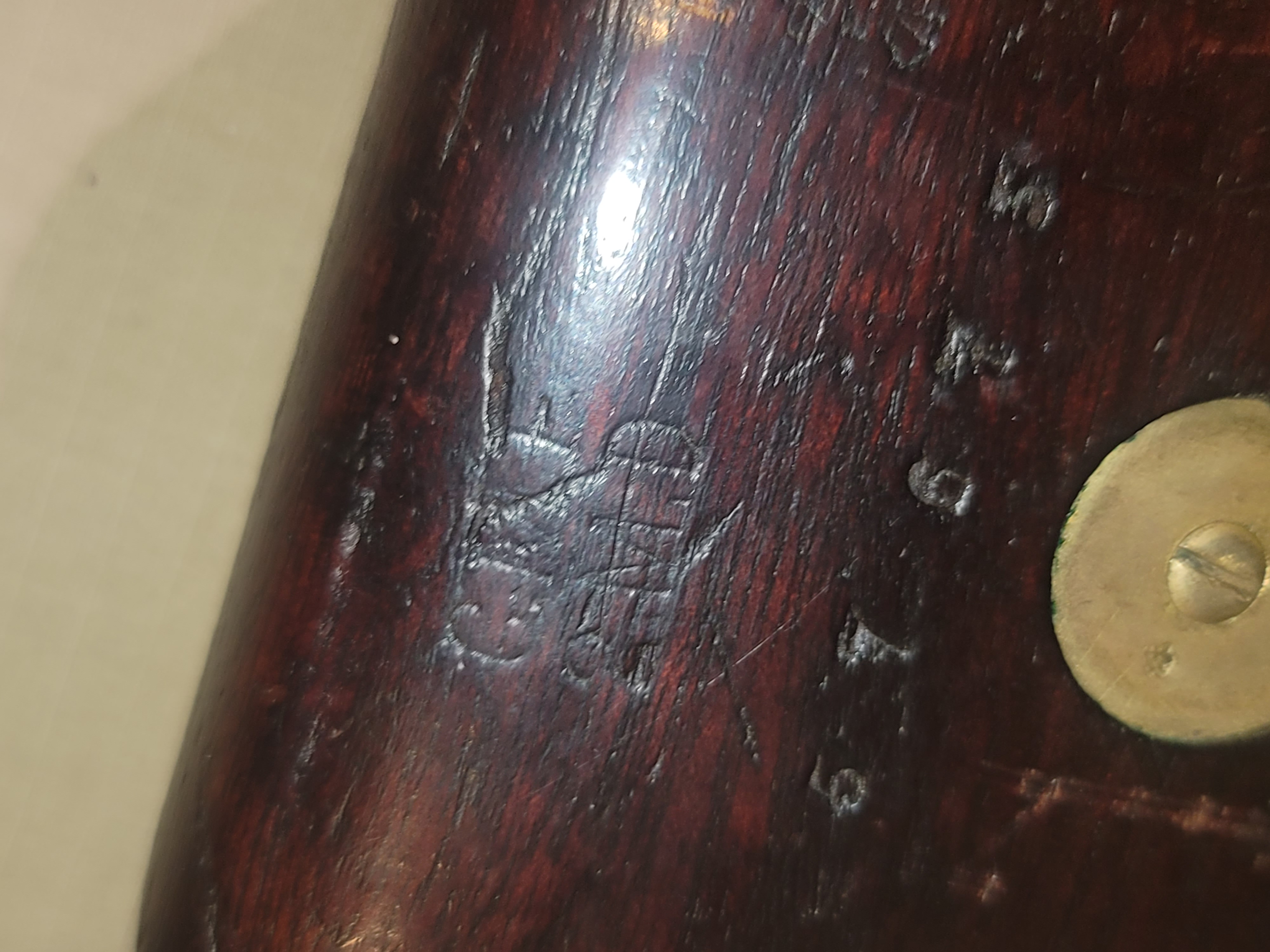

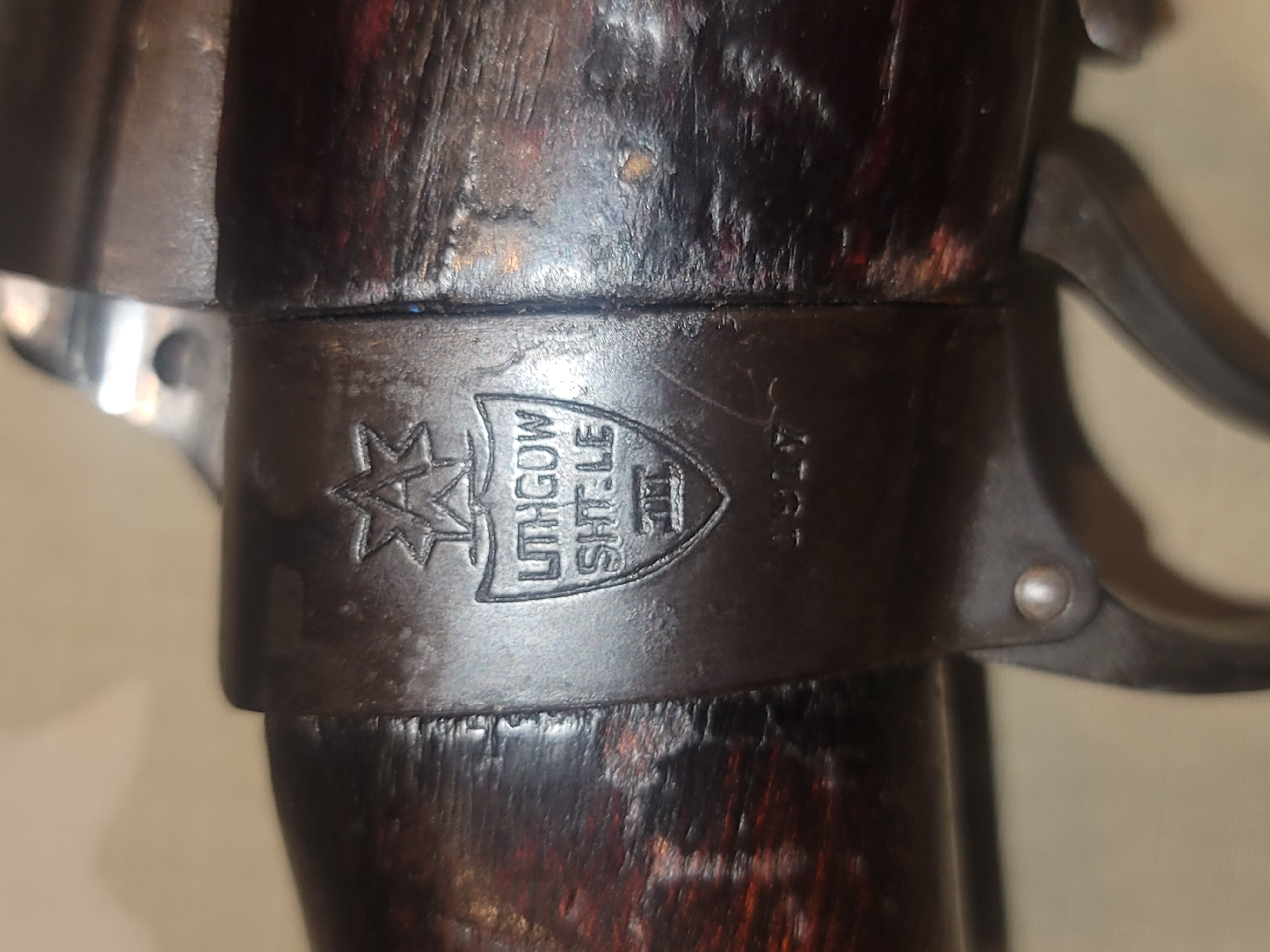

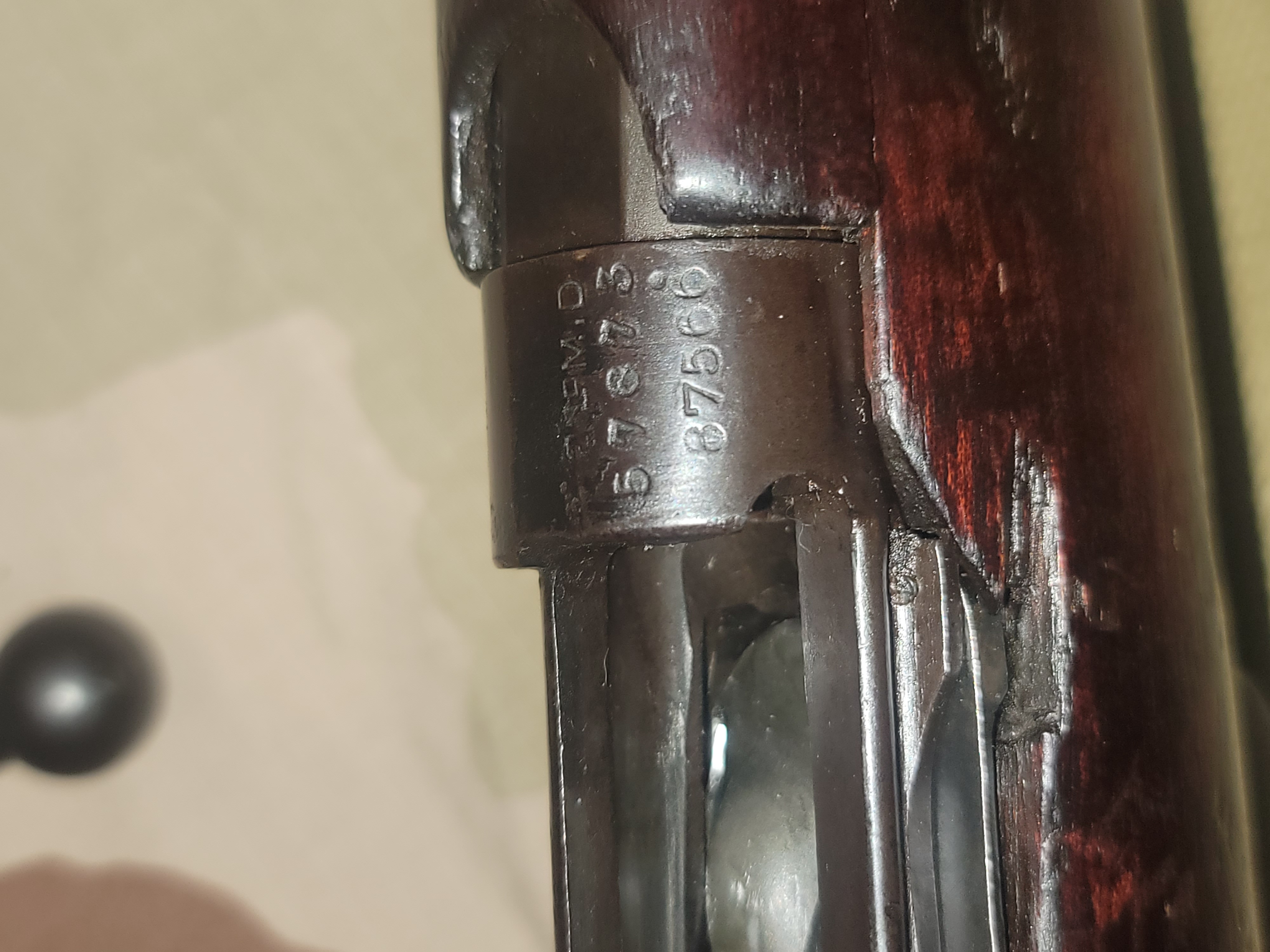

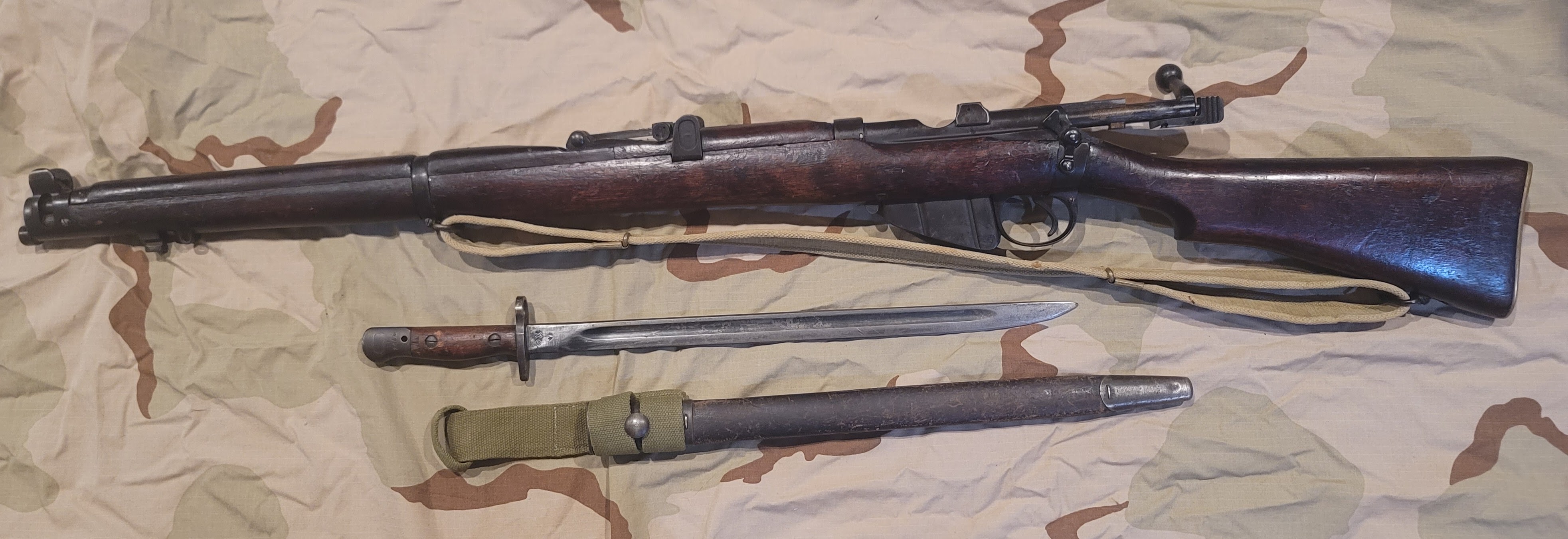

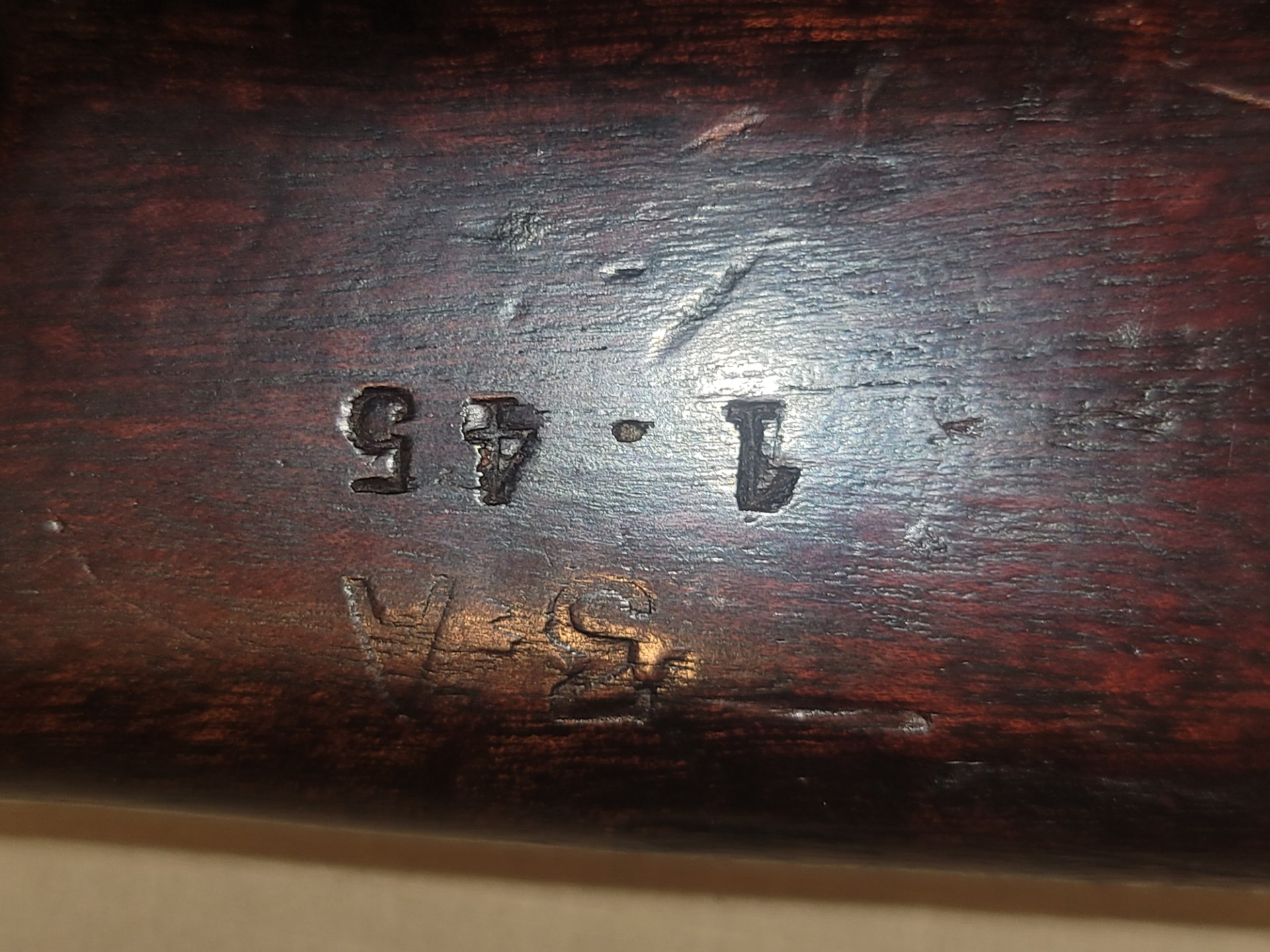

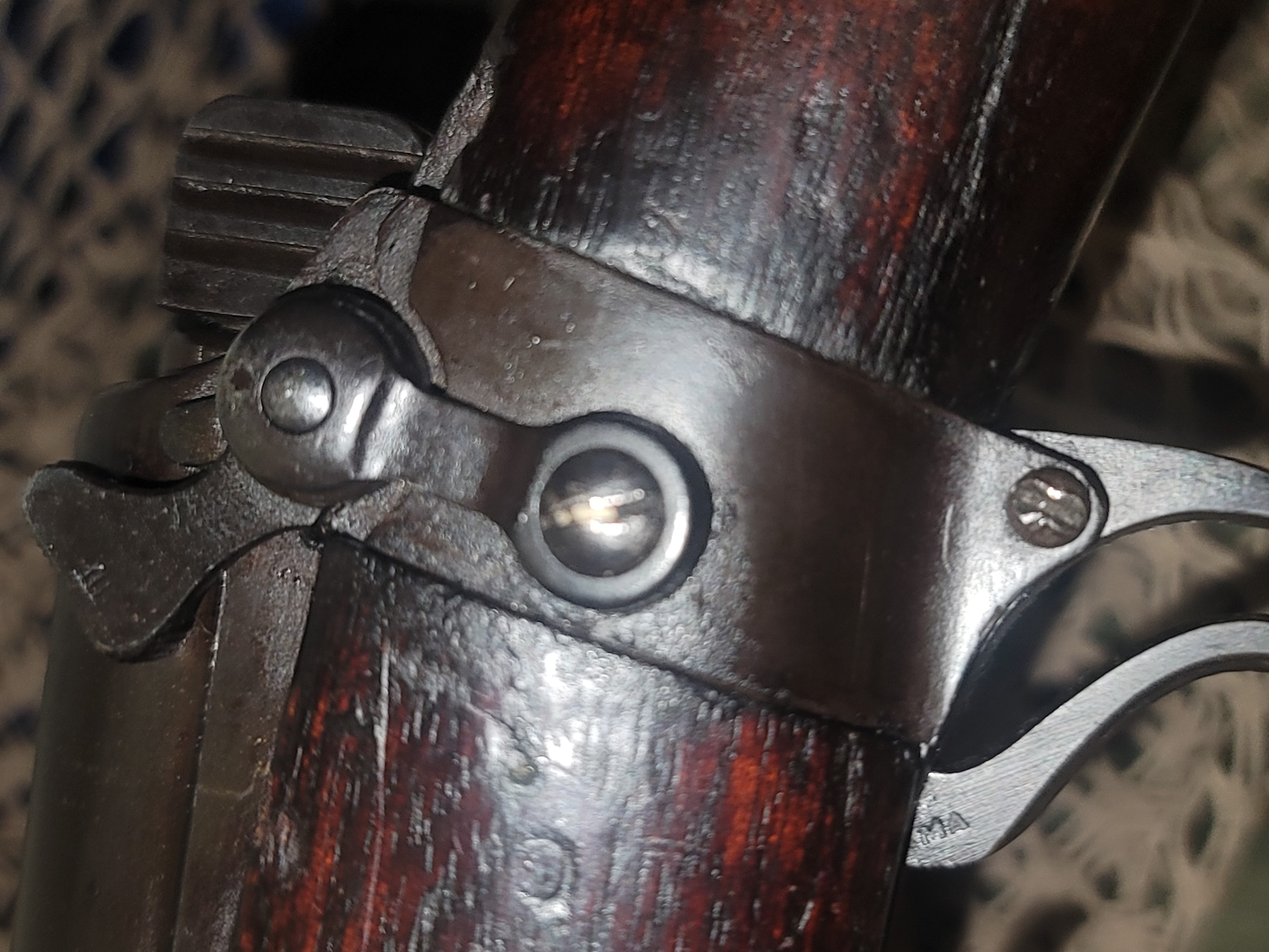

    OK, Pics are here. These are the OPs rifle. Well handled veteran...

    Nothing wrong with that one. Good honest rifle.

    That is a great honest example I say.
    I note the MA IX stamp which I've been leaning towards over the last couple of years that it signifies an inspection stamp for reused barrels from other rifles. And the 2 barrel fitment dates does go with this theory.
    Lithgowicon star VII / MA VII - Barrel fitted at factory as new
    MA IX - Barrel fitted but reused from another rifle.
    I have 4 SMLEs with MA IX stamped barrels and all have been reused and have other serials on them and some have the newer stamped alongside.
    Is there a different rifle serial number on the other side?

    mattyboy, from what I can tell there is only one serial number on the right side of the barrel in it's usual place and nothing on the other side. I give you more of a definitive answer when I have rifle in hand as right now. "Mostly" I only have the same photos that you have.
    The wood is very dark albeit the light in the photos might be throwing me off a bit but I'm wondering if it's stocked in coachwood but just very dirty. Lots of impressions in the wood leads me to think that it is soft but this rifle has been around the block a time or two, so hard to say. I do have a couple other photos that were not posted and they are taken of the underside of the forearm, looks to be a "Crown" and a "E" and thats about it.
    Another question I have is the 2 dates on the barrel knox, 12.42 and 3.40. what do they refer too?
    I was told by a very reliable source that the 1.45 (stamped on the butt) is the date when this rifle went thru an FTR and most likely received the barrel change. So could one of those dates be the manufacturing date of the barrel?
    Mattyboy82 your thoughts are this was re-barreled prior to 1.45?

    The 1.45 on the butt will be a 'storage date'. Along with the '3.A' which from research, it appears this stands for '3rd Australianicon Ordnance Depot'. I have a lot more info on this period and why we often see SMLEs with mid-1944 to early 1945 stores dates.
    The 2 barrel fitment dates will be for the original rifle fitment date and the 2nd one will be when that barrel was placed on your rifle. It's not unusual for it to not have the new serial number stamped on it especially as time was rather precious for Australia during 1942....
    On the subject of an FTR, the wartime markings will often have an R/MA with a date to signify refurb at Lithgow and in the 1950s there was an FTR program for rifles to be used by the National Service Scheme. But there nothing to indicate an refurb or FTR on yours.
