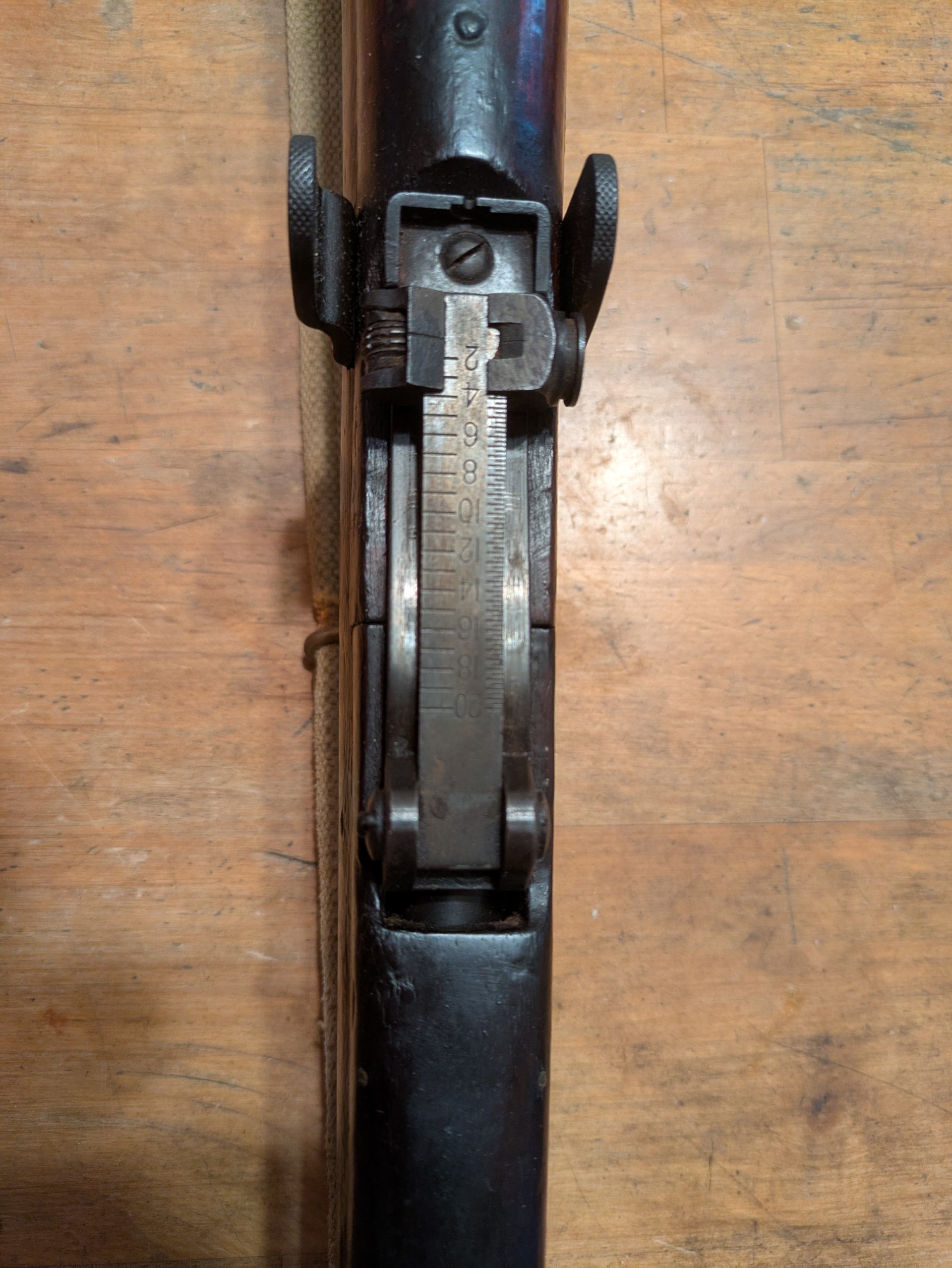

    Only looking at my phone but I’m not so sure that’s coachwood, more like very dark qld maple. Hasn’t been through an FTR or refurb. What type of rear sight does it have?
    Here's pics of the rear sight for the OP...
    Thanks. Just looking again it’s qld maple not coachwood

    It is a bit odd that it "retains" a cut-off.
    Part of the WW1 "temporary" change from lll to lll* was the deletion of the cut-off, dial sights and the "windage" rear-sight aperture / "cap"..
    Some time in the mid / late 1920's, it appears that Lithgowicon went back to "full" lll (no star) spec. This was again reversed with the onset of the Second Great Unpleasantness.
    Does it have any sign of it having spent time as a "range" rifle? Depending on the pattern and "brand" of rear-aperture base plate, Lane, Central, etc, sometimes the wood on the left rear of the fore-end was "relieved" a bit.
    Also, somebody has been at the trigger-guard whilst not knowing that the trick is to remove the FRONT screw first. Otherwise, the rear screw head gets mangled, just like yours.
