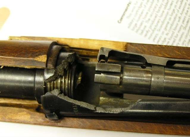

    Quote Originally Posted by Edward Horton View Post
    Vas ist los Bubba
    Inherent weakness or oiled cartridges and bolt thrust.
    (Or did he shoot his Mauser in the rain?)
    Your photo is a Swedishicon Mauser that I believe that was blown up with defective PMC factory ammo. There were a series of photos in a magazine about this one.
    This a Spanish FR8. A former M93 Mauser Converted to a Cetme look alike.
    less a few oz of shrapnel.

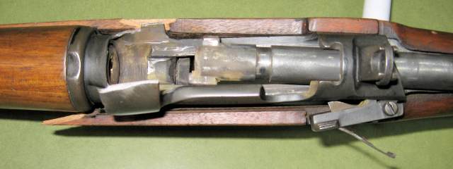

    Protection of the SMLE against the elements
