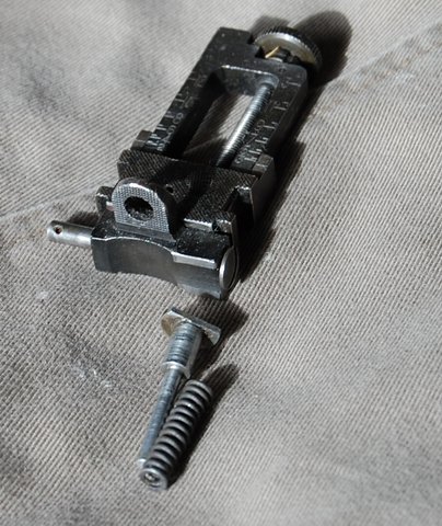

    You can see the plunger under the right of the sight base
    sight components (actually a rifle one but it's the same)

    Quote Originally Posted by Mk VII View Post
    Excellent! Thank you very much!!! Now, what is item #16 in that drawing you sent me?
