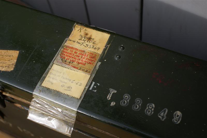

    Here are the pics. I found out its from a estate of a lawyer that had 132 guns. Apparently he's had it for a while. Any feedback is most welcome

    looks correct - scope and can match but obviously not to the rifle. Not sure what the pic of the loose scope is doing

    Whooops that M73B1 pic got mixed in. Guys the problem with this rifle is there is no Stamping on the left side of the receiver besides the T. I dont think this is a century made gun but the no identification on the side of the receiver is throwing me off. Also the different color stock pieces is driving me nuts lol.
