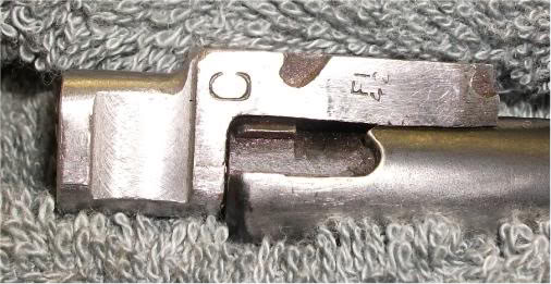

    Is this a common failure?
    In suppose this sort of thing should be expected from a rifle almost 70 years old.
    Today @ 08:41 AM
    31,034
    05-11-2025
    06:02 AM
    Just crystalization of steel. Metal fatigue. I had a #1 Mk3 that broke a bit further back. Shed a tear and change the part. Someone here will have a Savage piece for you.

    Yep, most common failure next to bent foresight protectors......... Cause, exactly as BAR says

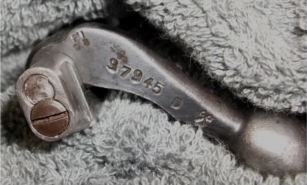

    Another common failure seems to be the guide stud or boss (as seen above) on the cocking piece either wearing or breaking off. Safeties seem to be next in line to give real dramas. (loose, worn, or missing)
    Captain Lailder has seen a blue million more than I, however!
    I wonder if there were studies done on common failure modes, more to the point, were any studies written up and distributed! I know things like that get done all the time for aero propulsion bits. Makes keeping proper inventory levels of spares rather easier.

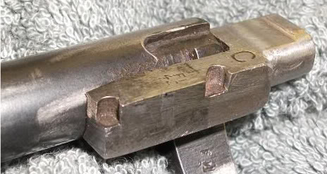

    I would think this might be a little unnerving in the middle of a fire fight. Three rounds then the bolt does not close.

    The metallurgy failure was due over time so was not likely to occur when they were in front line service

    If you want to play a bit, and have a range rifle where original military configuration isn't important, then save that cocking piece and make a short fall speed lock. I had a Wolff "Blitzschnell" mainspring, and a broken cocking piece like yours- a bit of "whittling" and voila! Coolio speed lock that works great, except for the safety, which now only works if the rifle is uncocked.
    Press forward is stiffer, but if you're vigourous, it's no drama.
    I did remove even more metal than required for function, just to lighten things up. If I go altogether mad: a titanium firing pin!
    Does it help accuracy? It doesn't hurt any, mostly it was just a functional experiment.
