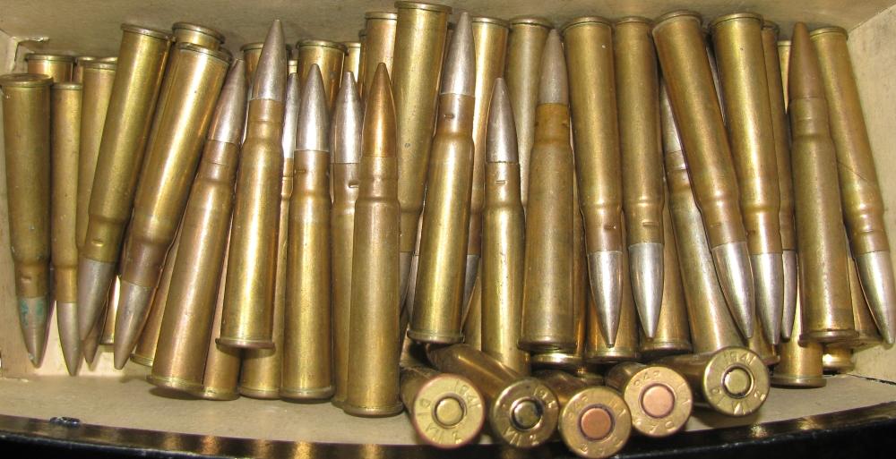

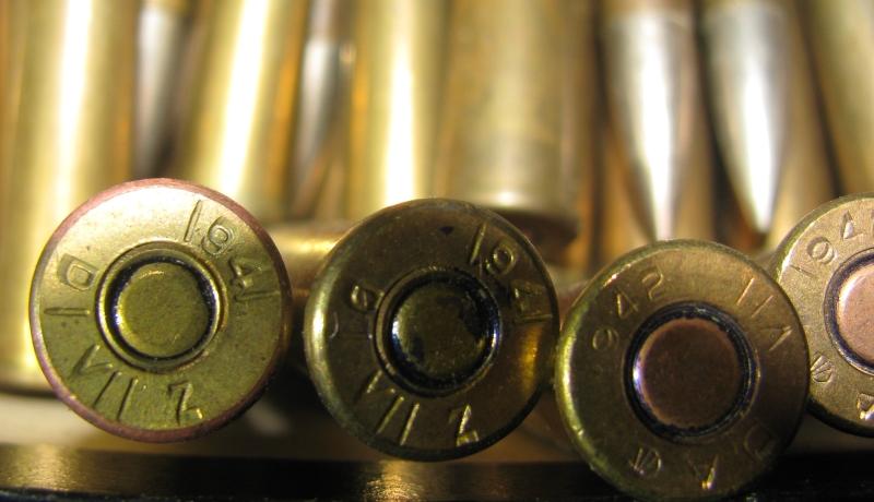

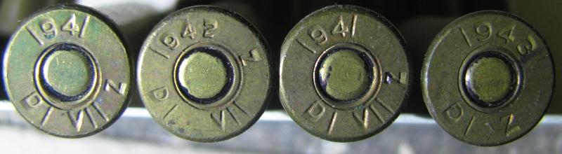

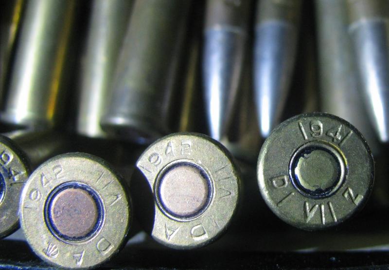

    I can buy some WW2 ammo:
    municion.org says:
    DI = Defense Industries Ltd Verdun (Quebec). Z = Nitrocellulose
    DAC = Dominion Cartridge Co. Ltd Brownsburg (Québec)
    in my region .303 is pretty uncommon, it can be possible, that those rounds are parachuted Britishicon help for Partisans during WW2. What do you think?
    What would be reasonable price (about 100pcs.)?
    Regards,
    Robert.
    DocAV's Avatar
    May 2008
    08-18-2017 @ 01:06 AM
    102
    05-10-2025
    02:19 PM
    The DI cartridges are all Boxer, Noncorrosive, and Nitro Powder Loaded ( probably IMR4740 or IMR 3031, Bulk Powder---not the same as the Retail "canister" Powder).
    Some of the ones shown have had their Mk7 FMJs replaced with Soft Points ( aftermarket)...commonly done by Interarms in the 50s and 60s, at their Lapua Associates.( Finlandicon) and also by Belmont (NZicon) in the 1990s.
    The DAC^ Cartridges are all Berdan (.250") Corrosive, and Cordite...although DAC did make some Mk7z (Nitro) beginning in the 1950s, also with the .250" primer.
    Both types of ammo are of better quality than Britishicon-Made .303, lasting longer, and with less
    primer failures or case splits. The Boxer cases, once annealed, will still get 10 + reloads.; as will the DAC^, but only if you can get the RWS#6000 .250" Berdan primers.
    Collector cartridges....every collector should have a complete Year and Factory collection of Canadianicon WW II production...there is enough still around to do so, but it is fast being burnt up...( as seen with the HXP Greek .303 ammo of the 1980s sales.).
    They "ain't makin' 'em no more!" so, save some, and shoot the rest ( and reload if you can!!!)
    Regards,
    Doc AV
    (Down Under, a recipient of 1,000s of DI and DAC^ ammo back in the early 70s...some collected, the rest shot and reloaded to extinction as Ball and finally Movie Blanks )
