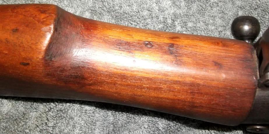

    Might just go ahead and find a Canadianicon buttsock as well. The one shown in the photos has been sanded enough to make the grip area look a bit odd. Alternatively, you might try to reshape it, but it would probably move the grip area too far back.
    Here's the grip area on a Fazackerly, but the contours should be the same:
    The only side view I can find is of a Long Branch N0.4 Mk.I* (T). Just ignore the cheek piece..:
