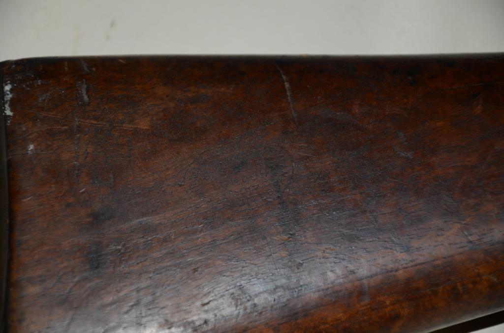

    Here are some pics of the Long Tom that is on the planning board for resurrection.

    Gunnie: Looks like a very worthwhile project! I assume it still has its "Metford" rifled barrel. How is the bore? I'm still searching for a decent L.M. (that won't require me taking a second job to pay for) but have found some decent parts for my Long Lee Enfields on good old e-bay including complete cocking pieces, handguards, etc.

    Some ofthat surface rust will come off with some light 3 in 1 oil and a razor blade.
    Good Luck with the restoration

    Use a sharpened brass scraper instead of a steel razor blade which will scratch. Keep the brass scraper sharp and wipe the
    "blade" frequently as rust will imbed and cause scratches too if you aren't careful. I use Hoppes No.9 instead of oil as it's a rust buster of sorts too. Then just clean it up with fine steel wool removing the traces of brass, and "Bob's your Uncle"!

    Old museum restoration trick: turpentine on a coarse rag or canvas. It works !!!!!
