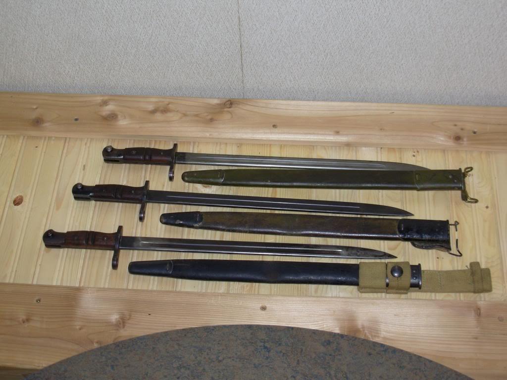

    the US scabbards are only different in the chape/belt hanger , the brits used the frog/button the same as the P1907 [its parent design] , i have all three early versions [onlty the brit and early two in the photo] the others not been included in an update yet - there are actually four counting the late version of the fiberglass M1917 scabbard
