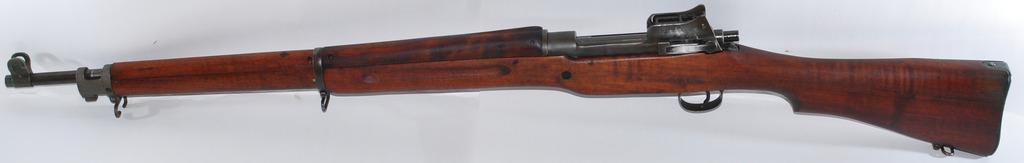

    The reason I got it at a good price as the gun is/was a bit rough condition wise. The most obvious issue is the stock was refinished with some kind of shellac or something while the bands were still on and the receiver was still in the gun. The hand guards were stuck to the stock and this goop was all down in the action! The other is that the bore is a bit questionable though using a .30-06 dummy round as a rough guide the muzzle doesn't seem to be TOO bad.

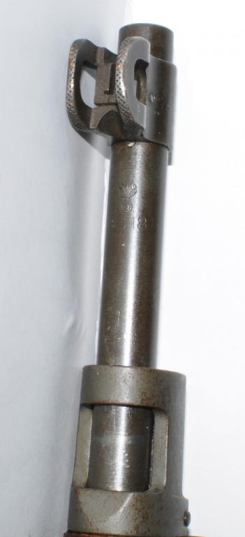

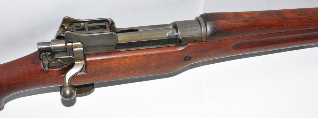

    As for the stock and metal, it cleaned up great. Some denatured alcohol cleaned the nasty refinish up on the wood and the over application onto the metal. It did raise the grain a little but since the original finish seems like it is there under the wood I see no need to sand it, just rubbed it down in some BLOicon and called it a day. No before pictures but it was pretty rough looking before so this is an improvement. The parkerizing actually doesn't look too bad on the action aside from a couple odd wear spots on the left and the bolt stop, with the bands and barrel having the expected wear. Look as good as I can expect after oiling it, given it's approaching 100 years old and probably went through two World Wars.
    Gun is mostly matching. The barrel and stock are original Eddystone as are most of the small parts, though the rear sight ladder/elevator is Remington. Notably it appears the bolt was replaced with a WWII K bolt which is a slight bummer but better for the gun as a shooter, though all the parts on it with visible external markings are Eddystone. The buttplate was painted black but I don't think that is correct either. Aside from the E on the end the stock it has a "C" with a cartouche above the trigger guard and a "9B" below it, near the heel and no P to indicate a refurb.
    Not all of the pictures came out but here are a few, post clean up.

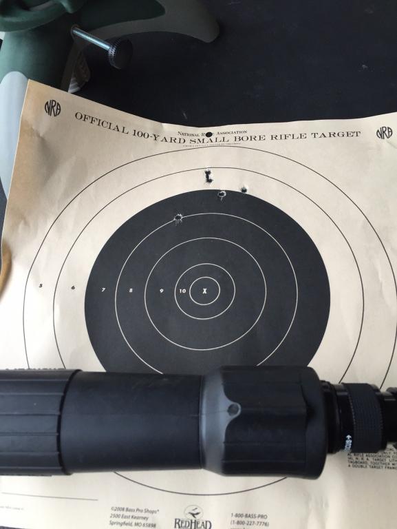

    In taking it shooting I was happy with the end result. Group at 100 yards was pretty solid with off the shelf ammo. Took 6 shots, one sight in shot and one for the group. Averaged out to about 2", including the shot off to the left. Note the top left is not from keyholing, it's from the chicken wire tearing the paper when I took it off the target stand.

    Well, it sure cleaned up well! I have a question about the bolt. Can you explain better about a K bolt? I've never heard of it.

    My understanding is bolts stamped with K or USMC (United Shoe Machine Corp) are replacement bolts fitted to the guns when they were overhauled around WWII, as apparently the originals were prone to galling the receiver. I do not know if this gun actually ever was overhauled at an arsenal or was just a part someone put on afterwards.

    Nice 1917. Above average.
    A letter "K" stamped on the underside of the bolt handle would identify this as a Kingsbury bolt made in WW 2.
    If a letter "K" were stamped on the top side of the bolt handle, it would be an Eddystone bolt made during WW 1.
    Eddystone stamped the top side of their bolts with letters A through Z for some reason.

    Thank you for the compliment. The K is on the underside as is the proof, so it would then be a WWII bolt.

    Your 1917 is a great shooter. 2 inch groups at 100 yards is excellent for an Enfield. I am getting 4 inch groups with my low serial Eddystone and quite content with that.
