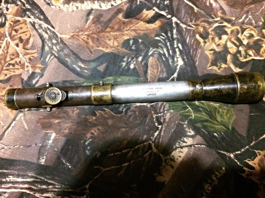

    Well today I had the good fortune of acquiring a PP co. scope at a auction. Glass is clear and the range drum and capstans move freely. My question is, is there a source for a reproduction mount? I have seen in the past that DRP has posted that he had a repro mount but where would one find one?

    It would be good to know which PPCo scope you have, to know which mount to suggest. As you might be aware they had a larger scope for the SMLE sniper, but also the smaller type for the P.14 sniper.

    I am currently looking in to getting a few more PPCo mounts made, but we are still just at the discussion stage so far - nothing will happen for some months at best. However, when I had the last batch done a few friends had some as well, so I can always ask around if Mr emoose would like! PM me if you'd like me to pursue it.....
    Incidentally, as Promo says, there are two distinct types of sniper scope that were made by the PPCo during WW1 - I tend to refer to the earlier model as 'the PPCo' & the later one as 'the Model 1918' (its official designation), as this serves to lessen the potential for confusion. (In fact both designs were cribbed from the Germans - the earlier scope for the SMLE was an anglicised & slightly modified Fuess Helios 3 & the Model 1918 was derived from the Hensoldt 'light' telescopic sight).

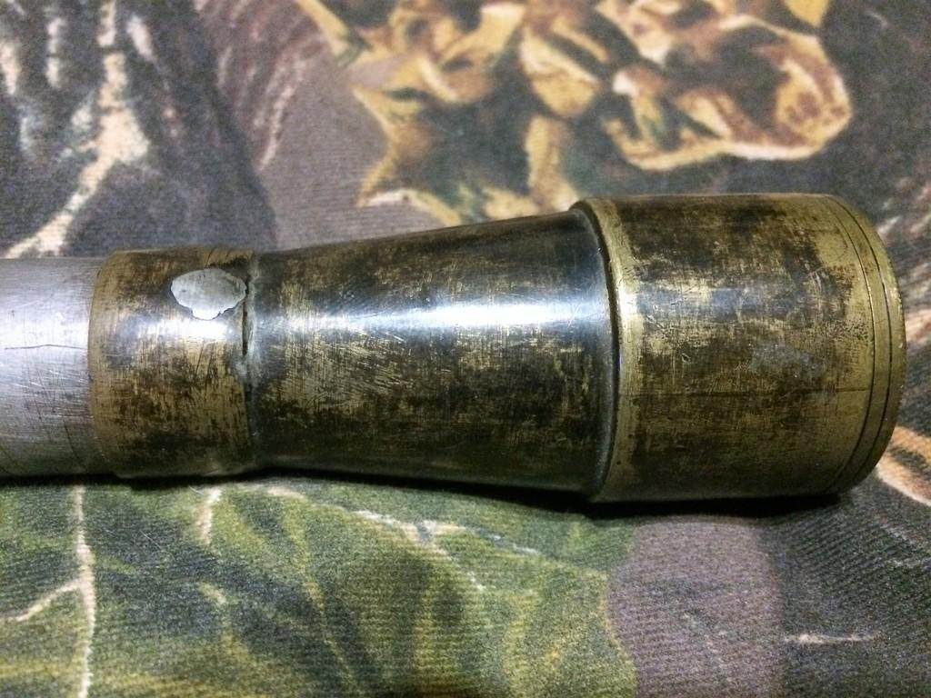

    This scope is definitely the early larger version with the stepped ocular for the SMLE and not the model of 1918. The range drum appears backwards from examples that I have seen.This is in as found condition and will need some TLC, I just wish that whoever had it didn't steel wool the patina off of it.
