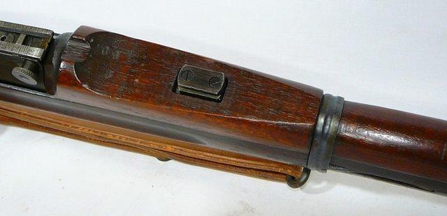

    What dimensions are you trying to figure out? Like the dimenstions of the blocks or how they were installed on the rifle?
    The handguards are all identical on real USMC 1903A1 Snipers. I took my real one over to the retired Professor of the Machine shop at Purdue University, and he is quite certain that the handguards were made on a horizontal Mill with a 3'' cutter.
    He actually tried to make a few duplicates to see if he could duplicate the cut and they were identical in everyway.

    Quote Originally Posted by cplstevennorton View Post
    What dimensions are you trying to figure out? Like the dimensions of the blocks or how they were installed on the rifle?
    That's incredibly beautiful! I was curious as to how big the mounts were LxWxH and how the front and rear compared to each other, also the center to center distance between the mounting screw holes. Having never seen one in real life its the only way I can get a good picture in my mind. Your picture is the first great picture I've seen of just the mount and the handguard all the others have been angled side views at best.
    That looks so good! LOL I watched an AGI video on YouTube and the guy flubbed up the rear mount and then tried to play it off "You can just grind or file off the end of the ring base so it will fit" type stuff. He made a video drilling and taping 1903 having never done it before, "following the instructions" I'd of been ticked-off if it was my rifle.
    His handguard mount looked nothing like this or even clean.
    Thanks for the picture the visual really helps.

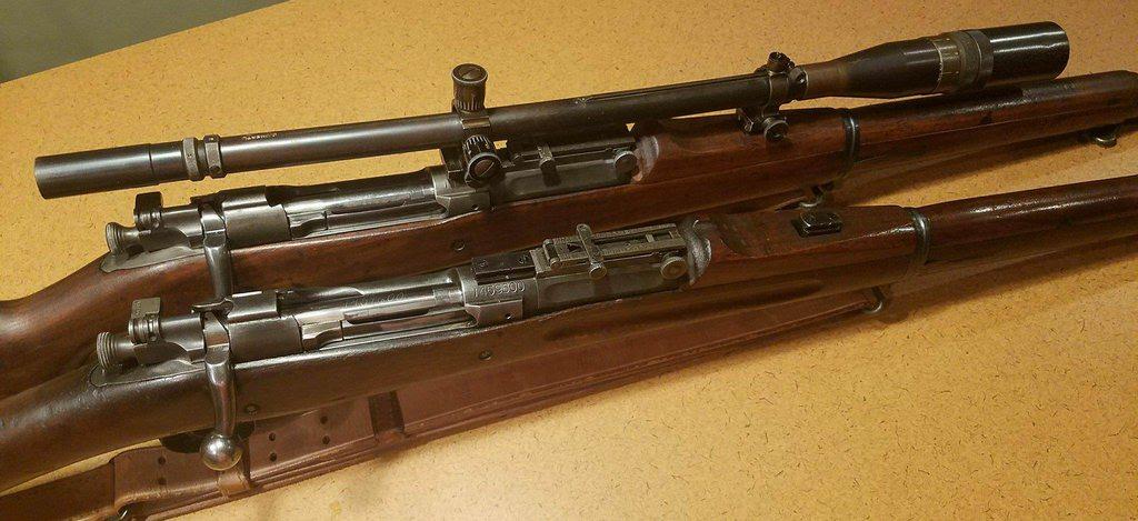

    Yeah as Herschel said, they are just O and E Unertl blocks. On the real rifles you see two different rear sight bases. Both appear to be made by Unertl as both are marked as such. But one has the WRA hole on both sides of the block for the thumb screw, like on the A5. It also has more square ends of the block. The other has more rounded ends and only has the WRA hole on the left side of the block. The more round with one hole is more common, but both are found on real rifles. I believe the more square might be earlier as it has holes on both sides, and that was an outdated style even in WWII. So I think the one hole was a revision, maybe wartime production. But I can't find any documentation on them. They are spaced 7.2 inches center to center of the blocks. Which yields 1/4 adjustments for each click on the 8X USMC Unertl 1 1/4 target scope.
    But here are two side by side. So you can sort of get a look of them. These are the two variations the Marines used in Sniper Conversion. Both are NM rifles. But the top still maintains it's orignal Star Gauged barrel. The bottom is a NM that the barrel was replaced by the Marines with a standard barrel. The Marines did not buy star gauged barrels from SA to rebarrel the NM rifles. The Marines called these Rebarreled NM rifles, special targets. Both types of rifles were converted to snipers in WWII by the Marines.
    But the top still maintains it's original Star Gauged barrel.
    cplstevennorton, This is fascinating! The scope is so long I was wondering how the geometry worked, the center to center you provided really helps me visualize this now. From looking at the pictures it looks as though the mounting block is not level with the rear mounting block, that the front mount is parallel to the barrel taper; our id this just because of the angle of the picture?

    Quote Originally Posted by usabaker View Post
    I'm not 100% sure what you mean, but the blocks are level on top of the barreled receiver. I'm guessing what you see is an illusion, just from being taken with a cell phone camera and just downloading and cropping the pic, and resizing it to fit here.
    I'm still quite ignorant when it comes to the 1903, which of course is the reason I'm so curious. Good books on these things are so freeking expensive, so my 'vast knowledge' ;P has been limited to what I have learned from everyone here on the forum and the military manuals. I'm guessing when you write NM that means National Match (unlikely Narlly Marine)
    Yes Sir, National Match.
    When you say "original Star Gauged barrel" is that the little star on the crown? I've always wondered why that was there if it is.
    YEah they had the star mark at the muzzle, and under the handguard, the star record number. Which is usually a letter followed by a 3 or 4 digit number. It just meant that SA used a special tool to make sure to check the barrel. Basically a quality control to make sure it was a good barrel for accuracy.
