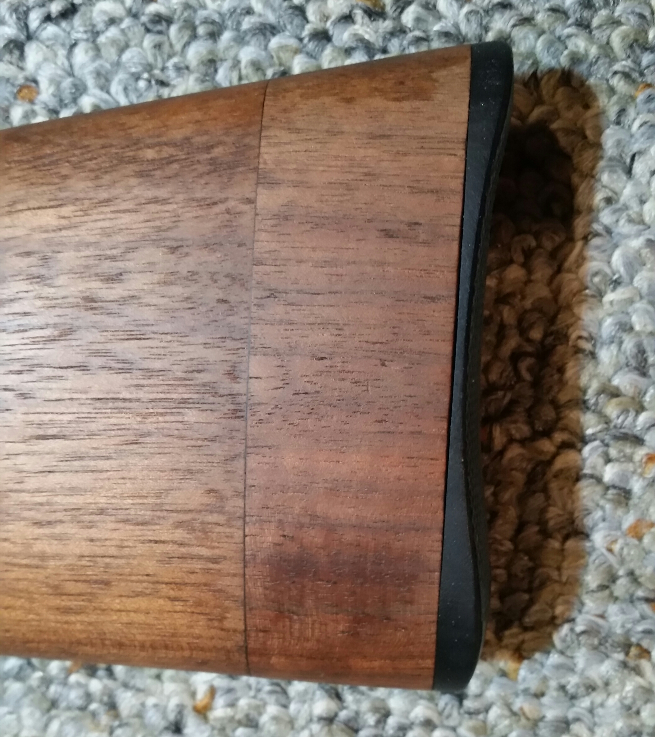

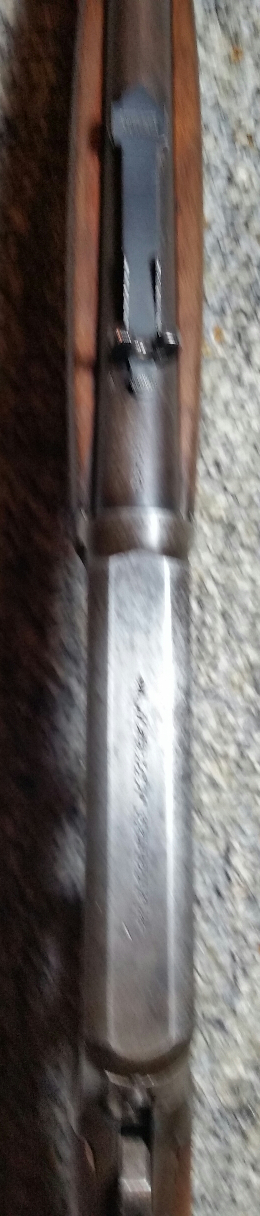

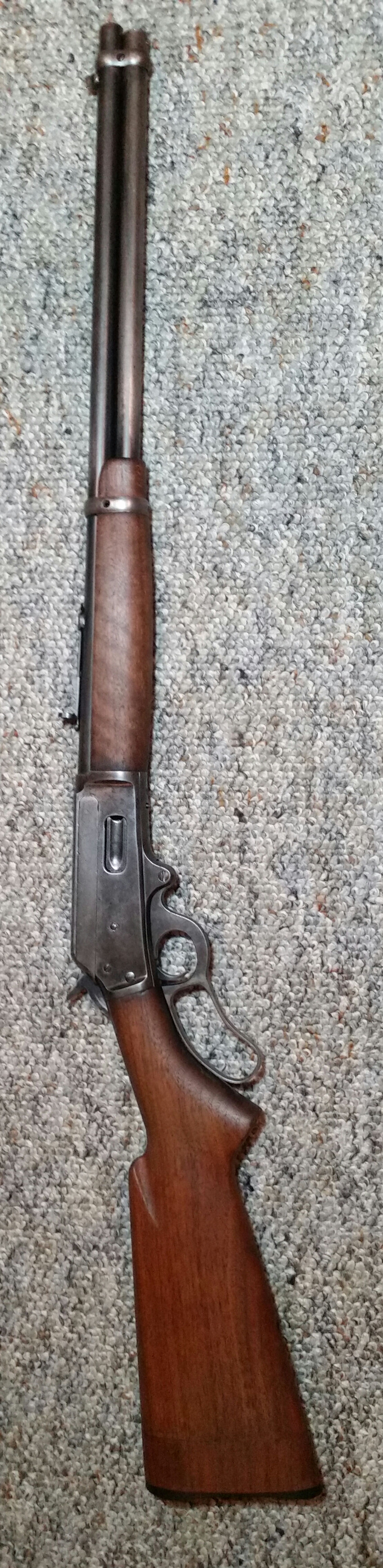

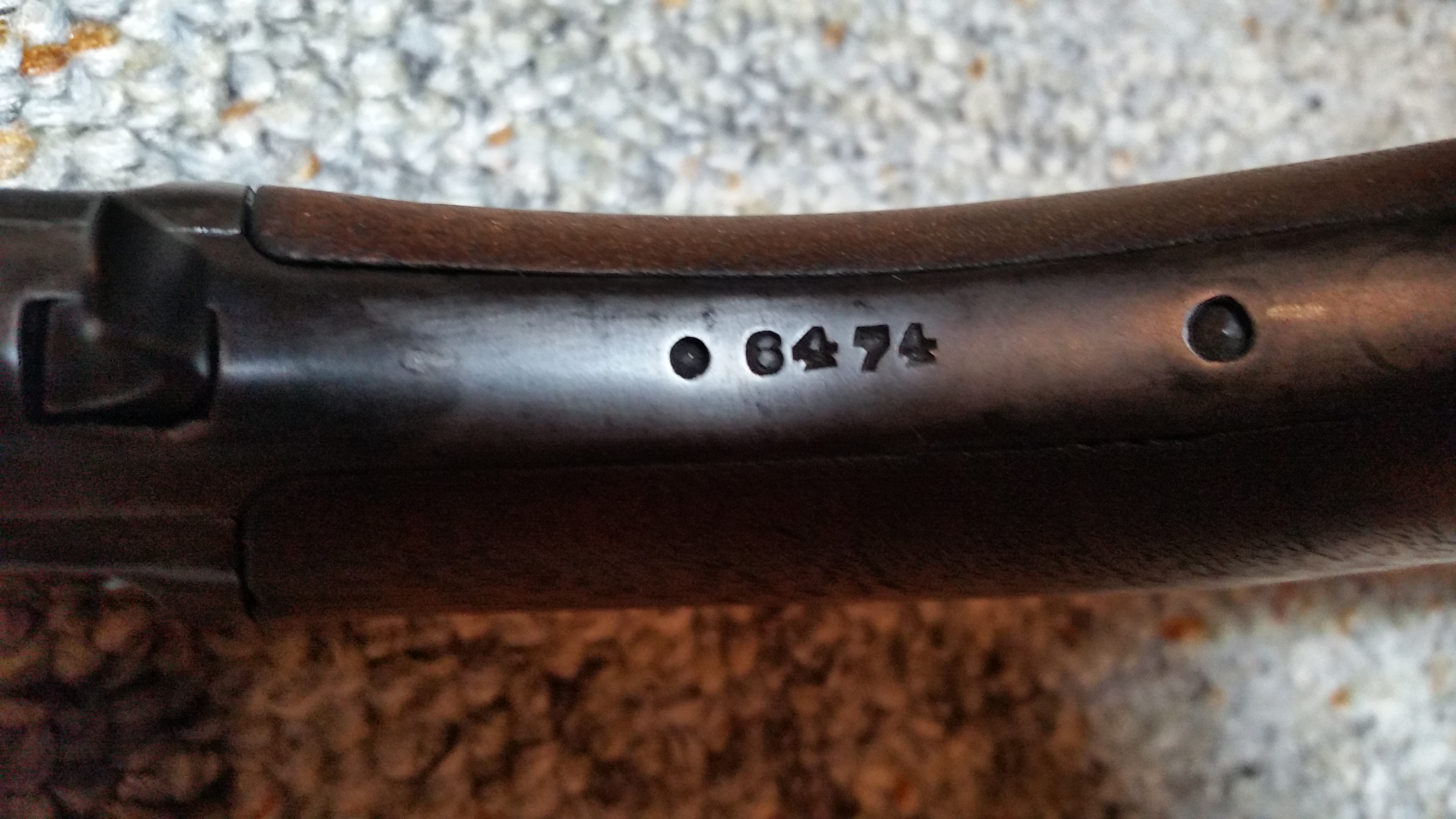

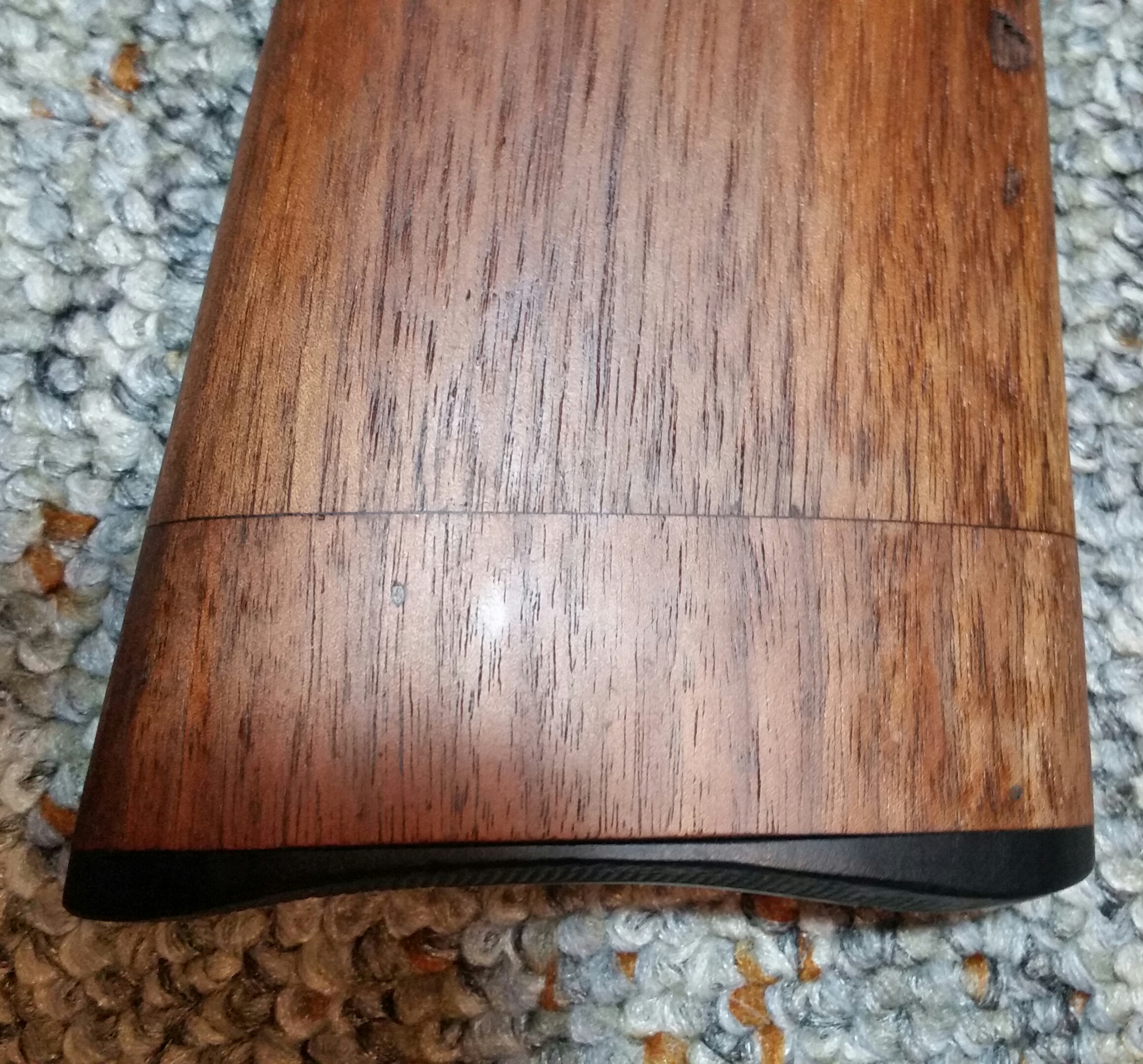

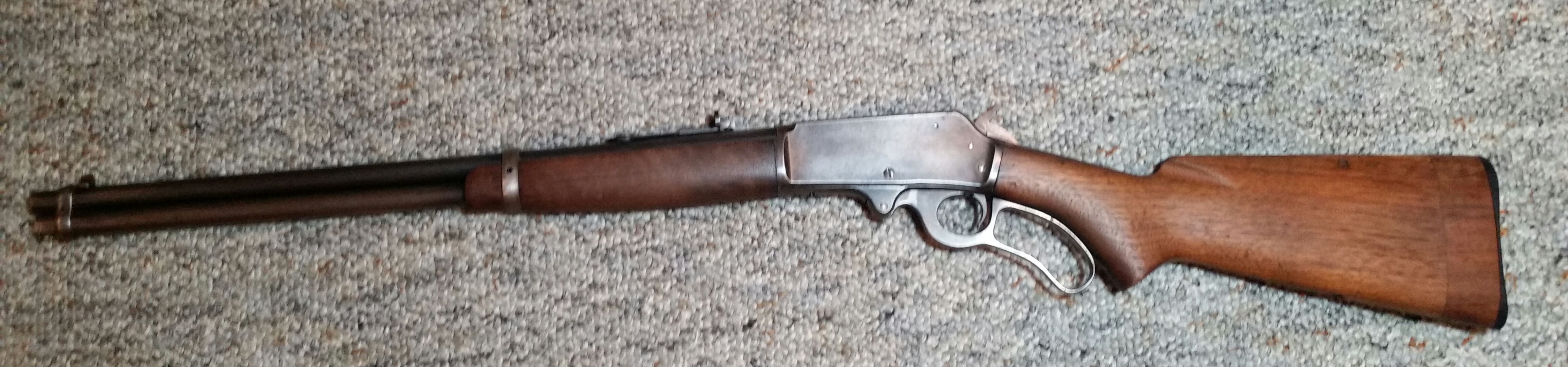

    That's the one. I had no choice when I rescued this one from a small interior town in B.C. Came from a farm where the wife used it to pot deer. It needed about everything. SURPRISE, the bore is very nice and very tight. I wanted a Marlin that had a Ballard barrel and now this one and a 336A from 1948 as well. Price on this worn old piece was $500 shipped and a bunch of parts that members here helped me procure. Anyway, here it is. Yes, low number and no prefix. 1936.

    She's a beauty Jim, nice clean stock extension work. I can almost feel cycling the action.

    I appreciate that Bill, I have seen much work by others here and still feel mine looks rudimentary. I have a friend here that's a cabinet maker and gun guy, refused to do the extension for me. He did guide me though and told me to use an epoxy instead of glue so I see a line. Used an existing busted 336 stock that had the same grain. Anyway, I agree that yours is much simpler to use a stock that is ready drop in. I'll bet you can still sell that high comb stock to someone.

    I saw a thread here or somewhere where someone first coated the surfaces of a repair with glue (so to minimize the visible line), then put epoxy in the holes where the internal metal support was. The epoxy held the pieces together very tight, and the glue filled all the microscopic pores at the seam, and blended it all together.
