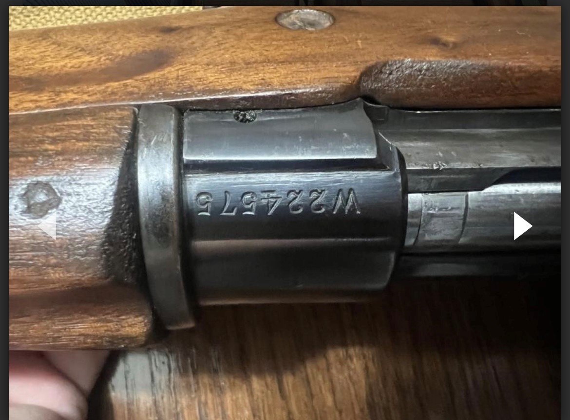

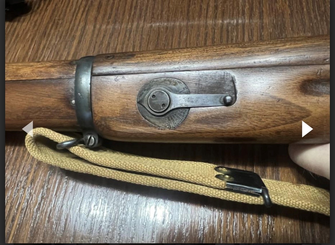

    I would like to see the very end of the fore stock, looking from the muzzle to the butt end, there should be a stamping in the wood there. As well it would be nice to see a picture in the area where the butt stock marking disc is, and if you feel so inclined maybe a nice picture of the left/right side of the rifle in it's entirety.
    Not sure where you found that one but I've been looking and advertising for a non-Weedonized P14 in the same country as you......good for you for coming across that one!

    Perhaps a few more pics will help then.

    Quote Originally Posted by M1lover View Post
    That post was from a different rifle that I ended up passing on. This is a different rifle.
    Well then back to my original request please and ignore the edited portion of my original post......please more pictures if you are able to do that

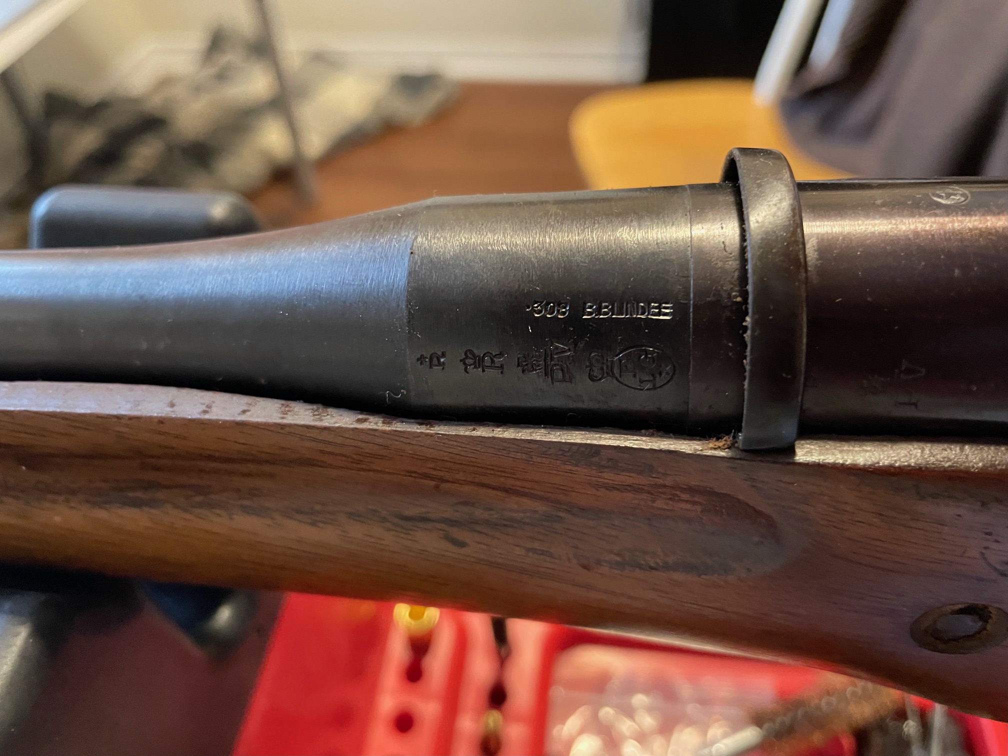

    Pictures to follow...I did take off the furniture and saw that it has been chambered for .308, not .303. It has BB LINDEE stamped on the barrel above the acceptance marks. Has anyone seen that before?

    Given the crown proofs and "B[alle]Blindee" mark I'd guess a Belgian rework. The phrase refers to jacketed bullets by the way.
    Perhaps related to this sort of conversion: https://www.milsurps.com/showthread.php?t=64858

    Yes, That's a Belgian marking with the reference to it's caliber.
