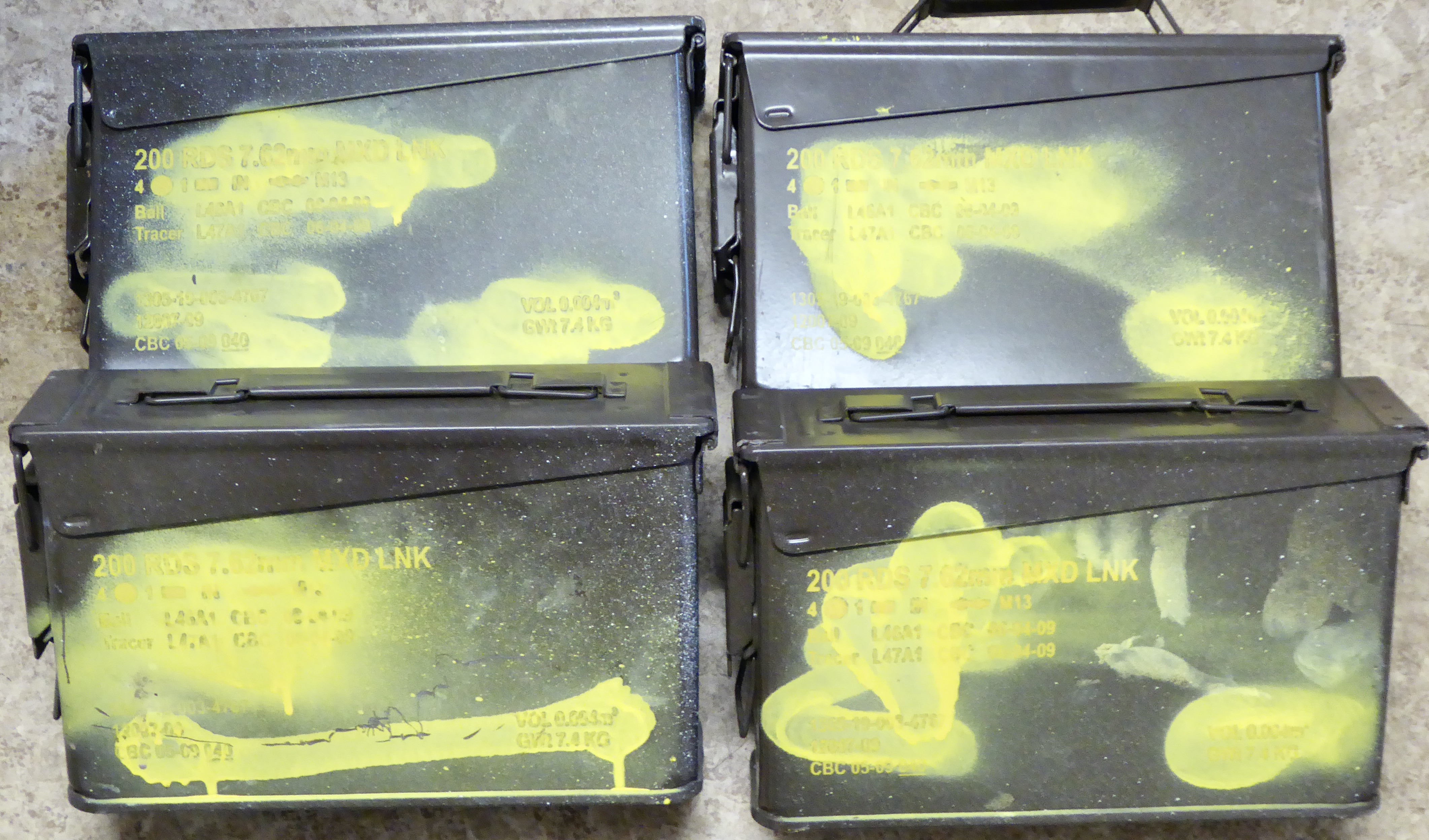

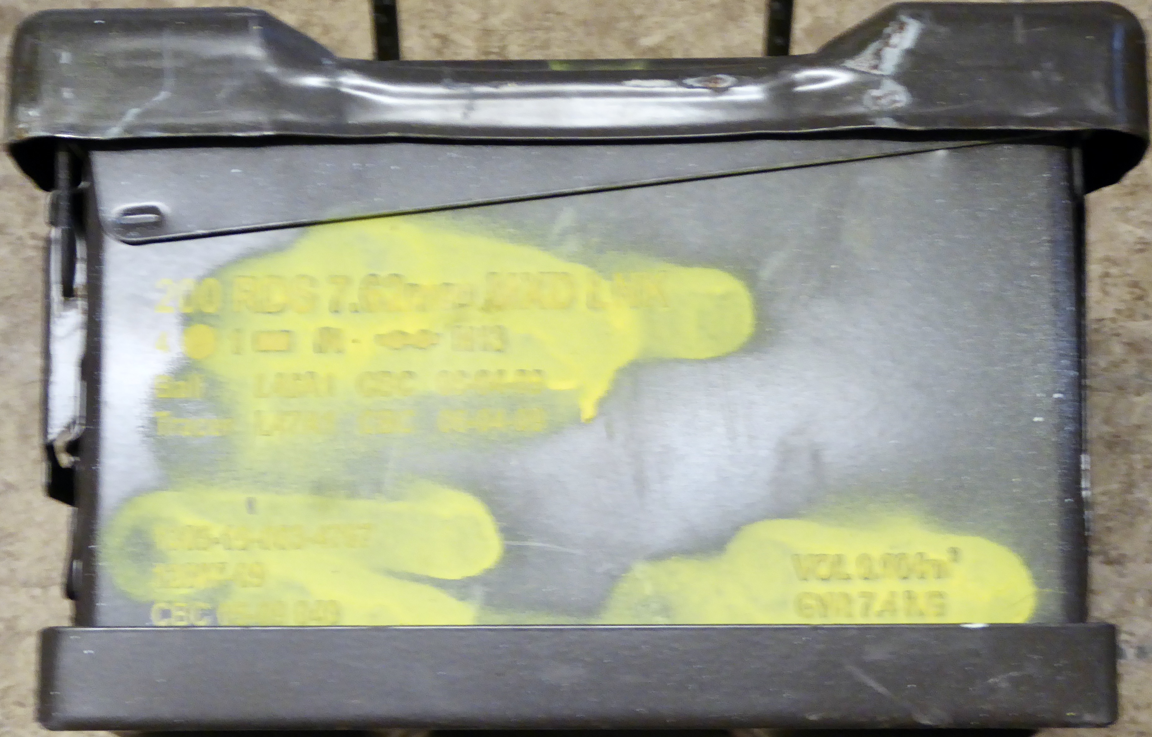

    Unfortunately there appears to be some sort of "silly rule" that UKicon surplus ammo cans that are sold off nowadays on the surplus market have to have the markings covered in yellow paint. So far I haven't discovered a good way of removing the yellow paint without removing the markings that are below.
    You could try a brake cleaner spray that has acetone as it's best ingredient, it lifts paint but isn't as heavy as pure acetone on a rag...

    They didn't use to do it but for some reason they have decided to spray over the markings nowadays.

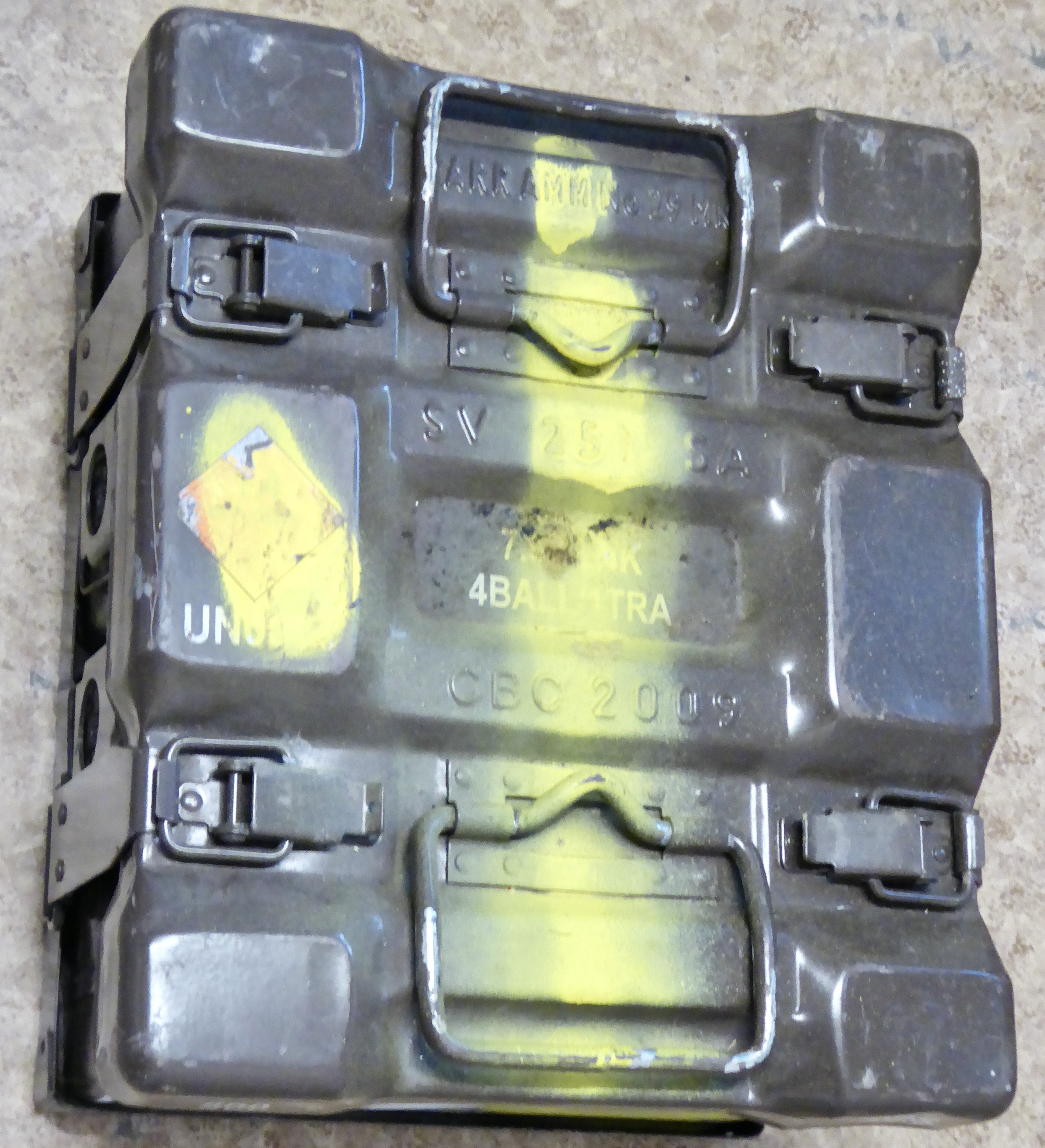

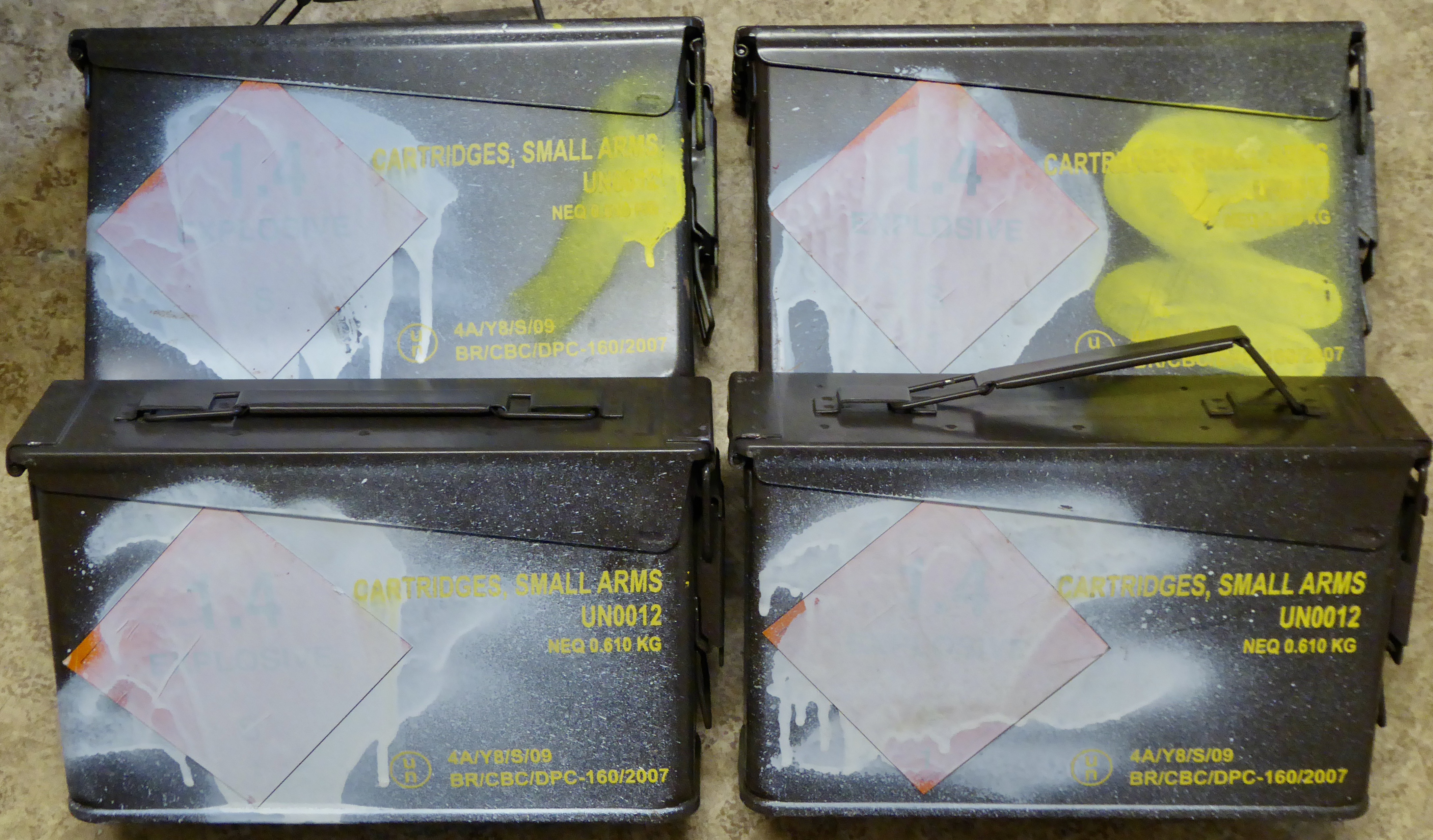

    This is one example.
    If memory serves me correctly the dealer who was selling these packs of 4 ammo cans said that they were for armoured fighting vehicles.
