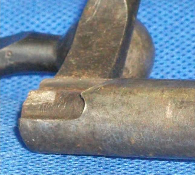

    The 4th and 5th pics show the exact same failure as my SMLE suffered. I've had the rifle since 1996 and that little lug fell off on about the second time I cycled the bolt; I'd not even fired it at that time. I can't immagine how many rounds I've put through it since, but it's never been a problem.

    Quote Originally Posted by harry mac View Post
    Photos 1.3a and 1.3b, yes? (Post #1)

    And here's yet another link to a bolt with a broken cocking piece guide tab. Complete with a good failure analysis on Post #12:
    No.1 MkIII Bolt Tab near cocking piece broke
    Thanks, RobsTV.
    Here's a repeat of Photo # 1.3a showing the area in question:
