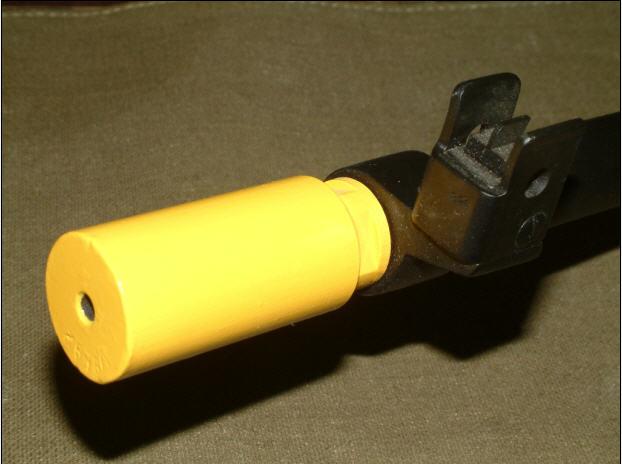

    Here's one of the barrel's with the BFA attachment.

    I don't remember the BFA''s beinbg painted yellow in my school CCF in the early 60's but they certainly were by the mid to late 60's as we had them for training and definately for our L4 guns.
    The old original masher barrels had a tapered insert welded into the flash hider muzzle. As I said, they weren't either secure or safe. The one in the picture looks like the current one without the foresight block.
    CSM, what's the origins of yours as I have never seen one like it. It's certainly nothing like ours. But on the basis that it traps a wooden bullet and breaks it up should suffice. But that wooden bullet certainly imparts some energy into the BFA.
    As I said, in the Battalions, we hgad about 6 per Company and they were kept in an oil bath and meticulously inspected for cracks prior to being issued. I have just been to the Armourers shop and they are busy spraying the GPMG BFA's with hard wearing road marking yellow paint. Doesn't last as long as the bake paint but when done after every exercise, they are always clear yellow and not black

    Peter
    They appear to be made from Mk II barrels that have been threaded in front of the foresight block to take the restrictor.
    I have 3 of this type of barrel. When I first acquired two of them, they were painted red all over. I stripped them and have used them for reenacting ever since. To date we must have put close to 20,000 rounds through them, with not a hiccup. I have had them since the late 90's and apart from a thorough boiling out and cleaning every time they are used, they keep functioning reliably.
    Judging by the stampings on the barrel, they look like they were converted from old spare barrels , probably from ones that were shot out or otherwise unserviceable.
    I'll get some more pictures in the next week or so, but if you take a look in the forum here, you'll find a video of it being used in a History Channel shoot with the wooden blanks and the screw on restrictor.
