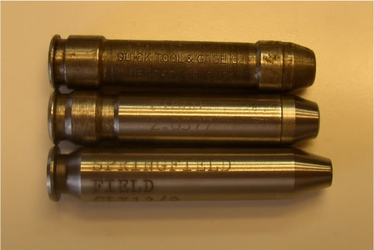

    I found a link to a CMPicon page that indicated that they recommend Clymer over Forster headspace gauges for military rifles. I went ahead and ordered one from Brownells.
    The Clymer's 30.06 field gauge arrived today and the Match 1903 WILL NOT close on the Clymer gauge. Wheeeww.
    For information, the Forster Field gauge lists a spec of 2.0577.
    The Clymer gauge lists a spec of 2.0587.
    Guess I'll stop worrying about it. but I did order some Redding 30.06 neck sizing dies and 100 rounds of Remington 30.06 brass--for accuracy sake, I'll go ahead and neck size for this rifle.
    Thanks for the help, guys.

    So I guess the headspace on this chamber/bolt combination is <.001 out per the Forster gauge.
    Ignoring the Clymer gauge for the moment, is .001 out of headspace significant?
  11. #17
    Aug 2009
    11-27-2022 @ 11:10 AM
    Yuma , Arizona
    1,402
    08:45 PM
    No...
    ...but it does mean that after every 100-500 rds you would prob'ly want to check it again.
    Chris

    I'll keep my Clymer gauge handy

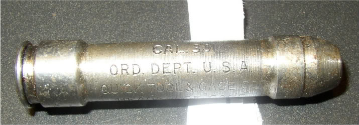

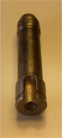

    I obtained a US Ordnance field gauge. It is marked "1.950", so I'm guessing that it indexes on a different part of the chamber than the Clymer (marked 2.0587) and Forster (marked 2.0577) field gauges.
    At any rate, the 1903 does not come close to closing on the US Ordnance gauge. Even more so than the Clymer.
    Here are a few pics of the US Odrnance gauge.
