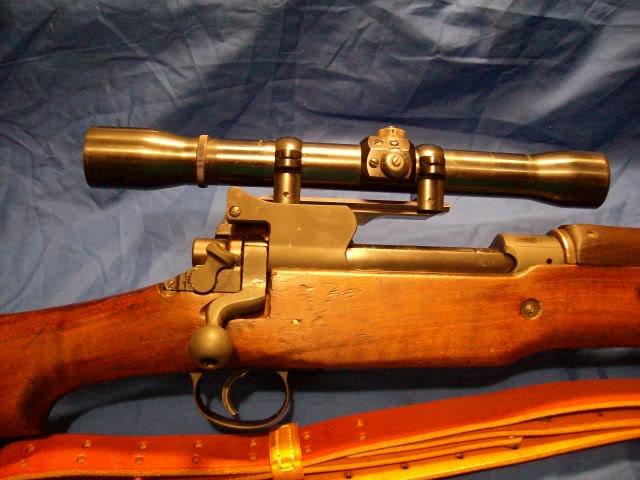

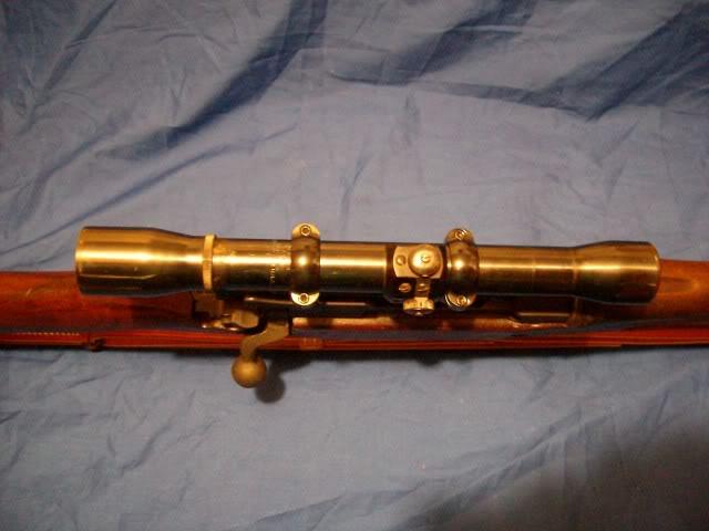

    Back with a better looking scope and more photo's...
    Scope is a old Weaver K4 with Weaver low rings.
    Thanks for the great pictures documenting your scoped '17, Trickster.
    You'll have to let us know how she shoots.
    I'm working on a similar set-up. I already have the S&K mount, and a 1960's Weaver K4-60B post-and-cross-hair scope is on the way.
    Right now I'm trying to find a set of rings that will work with the S&K on my Eddystone. Found that a classic Weaver Sure-Grip ring like yours interferes slightly with the Eddy's sight ears at the rear of the mount. Same is true with Leupold PRW rings.
    I'm hoping that a set of Burris Signature Zee rings or Weaver Grand Slam rings, which are not as bulky, will install without interfering with the sight ears.
    ______________________________________________
    Edited to add:
    I ended up going with a set of Burris Signature Zee rings, the only rings I could find that would fit without touching my Eddy's sight guards where the ears begin to sweep up toward the back.

    The Burris Z rings are the way to go (thanks Chuck). Mine came Monday and fit and look much better than the weaver rings. They do place the scope a bit higher than the weaver rings, but it is still at a decent height. unfortunately it will be a couple of weeks until I will get to try it out.

    Trickster, that is a great looking setup.
    Thank you for the inspiration.
    Should have a similar rig as soon as my Weaver post & cross-hair K4 60B arrives.
    Although I'm very happy with the original M1917 peep sights, a scoped "sniper" variant will come in handy for deer hunting and the rifle is easily convertible back to original.

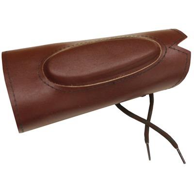

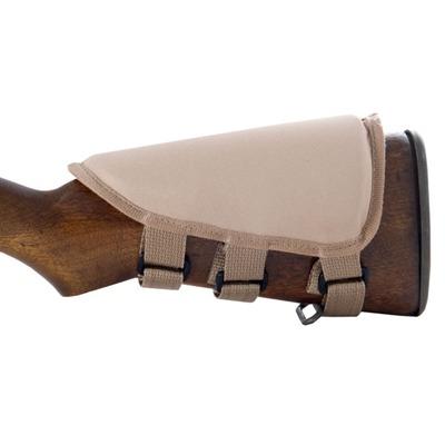

    Brownells has a couple different strap on cheek rest. It would be nice to find one that didn't require any holes in the stock. If the Garand one doesn't work out, I may try the leather one here.
    SMITH ENTERPRISE : STRAP-ON CHEEK PAD - World's Largest Supplier of Firearm Accessories, Gun Parts and Gunsmithing Tools
    BRAUER : LEATHER LACE-ON CHEEKPIECE - World's Largest Supplier of Firearm Accessories, Gun Parts and Gunsmithing Tools

    That wood cheek rest sounds interesting,is it something that is readily available,or do I have to make something like that?
    I like tricksters first picture too,that made of leather would look and function(hopefully)very good,and being hand made,one could customize the height of the pad.Thank you sirs,for the good ideas,keep em coming.
