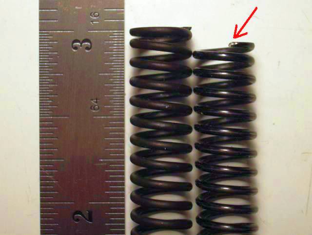

    Below, a brand new military firing pin spring (left) and the spring from my Turkishicon Enfield (right) please notice the the broken tip of the spring which could cause misfires. The broken spring piece had wedged under the spring and was dragging on and scoring the firing pin of my Turkish Enfield.
    If this Enfield had been in Britishicon or Commonwealth hands I would never have found the bolt in this condition when BRITISH Enfields were inspected yearly by a TRAINED ARMOURER.
    Please note above the new spring on the right has no rub marks on the outside of the spring, and the used spring has only faint rub marks or missing bluing on the outside of the spring. If the outside of the spring has more bluing worn off it means the spring is dragging and rubbing the inside of the bolt and it should be replaced with a newer and stronger spring. Again, a weak spring will expand when compressed and drag and rub the inside of the bolt and this hurts accuracy.
    Now tell me again I'm over-exaggerating an issue that doesn't really exist, when the used spring is much shorter and weaker than the new spring. I have tested thousands and thousands of of military springs and I "DO" know what I'm talking about.
    Wolf Springs sells replacement firing pin springs for the Enfield Rifleicon rated at 18, 20, 22, 24 and 28 pound ratings and lock time does effect accuracy.
    If my Enfield misfired I wouldn't be in a forum asking questions, my Enfield bolt would be torn down looking for answers and NOT guesses.
