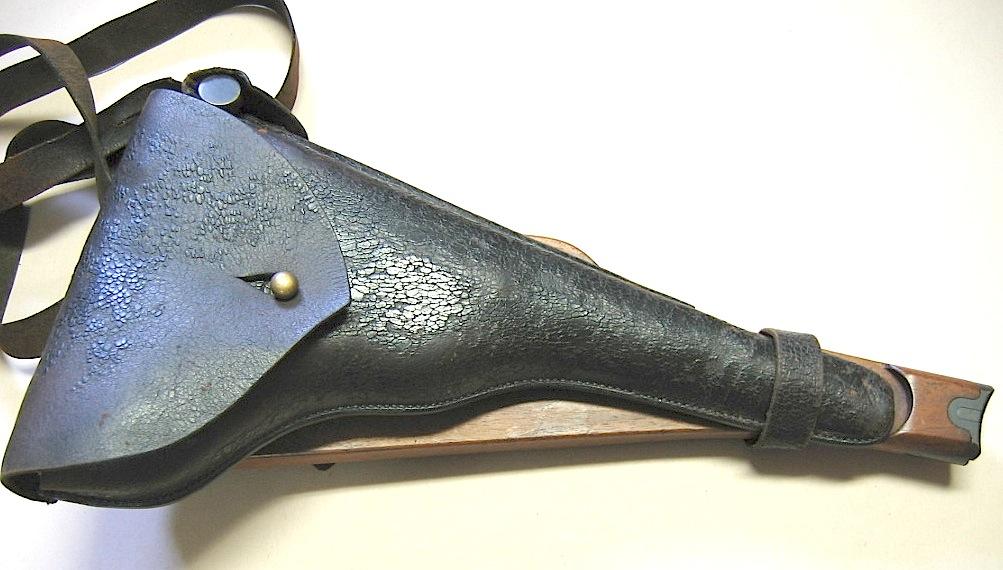

    Some advocate that using no preservative is best for the leather, but in some cases that is not an option. This is a rare Luger holster that was so dry that the outer glaze was falling off. Even keeping it carefully wrapped in a towel, the leather continued to flake off. Finally it was treated with Pecards, and the leather is now stabilized. Some don't like Pecards, but in this case it works.
