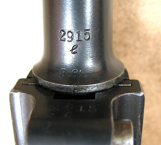

    The better picture of the right side shows the GERMANY export mark, and another of the front of the receiver showing the serial number location would help. If it has a letter suffix, the letter will not be in the serial number, but under it.

    The front of the frame, not the trigger guard. This is where the serial number is stamped.

    Under the barrel on the front there should be a mark telling us what the actual bore diameter is...

    The bore gage marking is on the barrel right under the serial number. This one is 8,82 mm.
    Well, that would be pretty awesome. But as you can see, there are no markings on my barrel. I also don't see any suffix to the serial number.
    I looked around for any other markings. When I disassembled it, I found another 53 on the trigger, and a mark I can't make out on the underside of the slide. Its something you wouldn't see unless you took it apart. It looks sort of like an I or an E, or it might not be a letter at all.
    So does any of that mean anything?

    So Johnny, with no bbl mwrkings, does that indicate a replacement barrel? I would think the Germans would mark even a replacement with the bore diameter?
