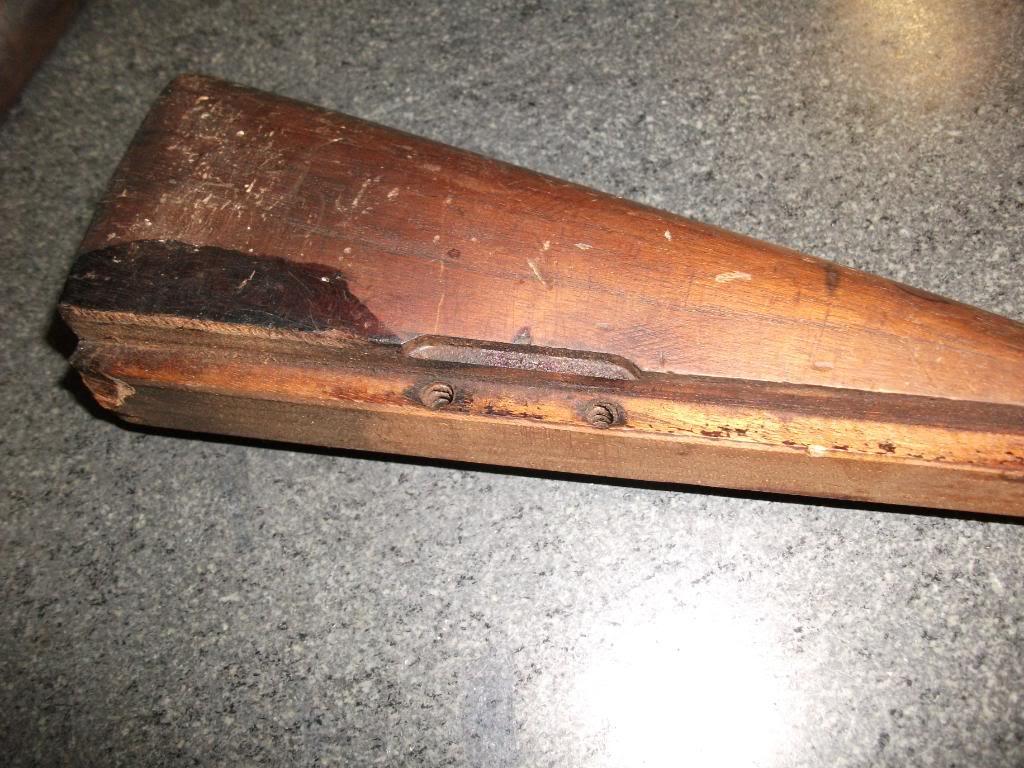

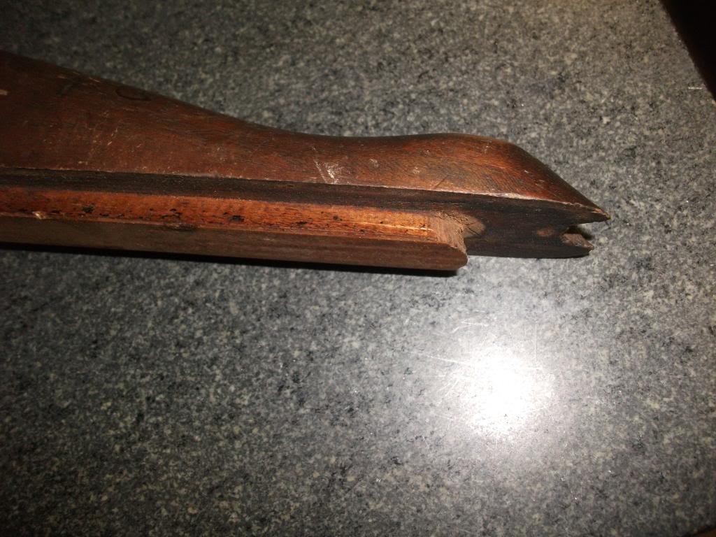

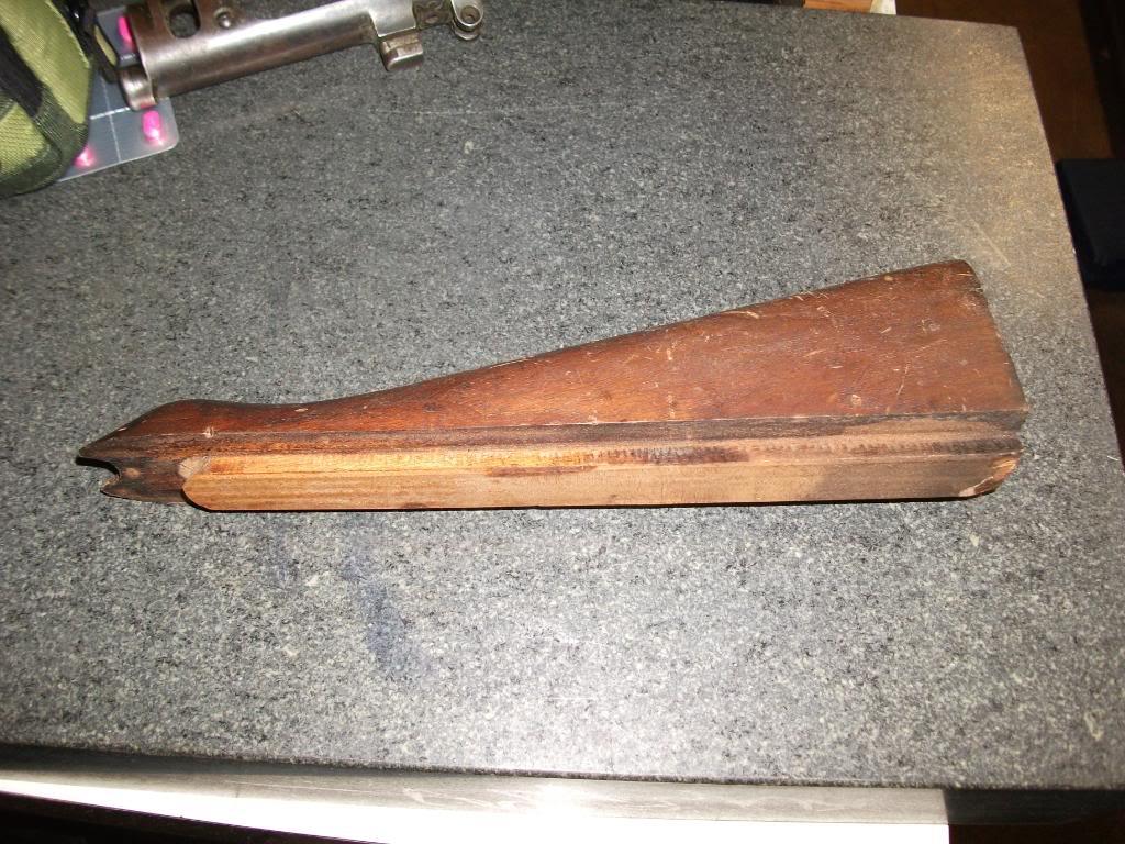

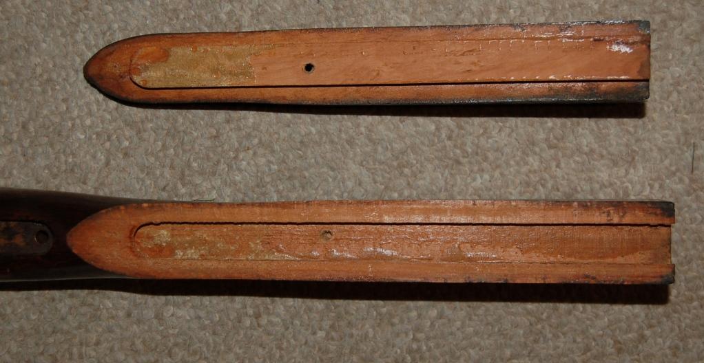

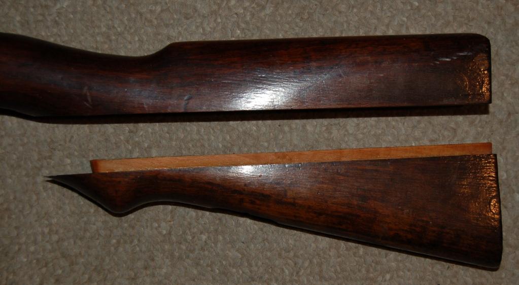

    I was cleaning the rifle a bit last evening and discovered the butt joint was loose and it slid right off. Having never seen this before I figured maybe you guys hadn't either so for those less daring perhaps, this is what the butt joints look like on at least the Italianicon stock, I would expect the Japaneseicon stocks to be very similar.

    Under that finish, as you've likely seen, is an orange hued wood that closely matches the "Italianicon Walnut" used on some US Kragicon rifle stocks circa 1900 and a bit later.
    Not in the case of a Type I! Thanks for the "techie" photos.

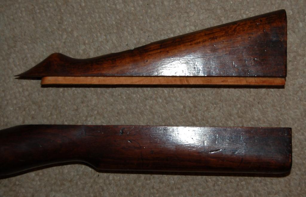

    Here's a Japaneseicon Type 38 lower section for comparison. (I think it's been shortened in the back, though.):

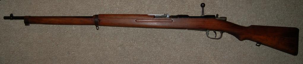

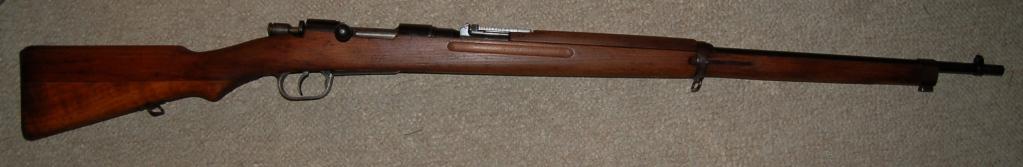

    Guys, I just couldn't stand it anymore. After taking it apart and seeing what was in there, I had to get that varnish off of it. While it may have looked nice in the photos, it was cloudy in spots, had large runs, had a few fingerprints and a few scuffs in it. The wood underneath had a simple oil finish and as of tonight, that is what it has again. If I had felt that it was original in any way, I would have kept it but it was Bubba finish and had to go. I asked around on a few other sites and everyone said it was not an original finish. All research I did pointed to either no finish or a light coating of linseed oilicon.
    The two piece stock is very interesting to me. They were not glued but held in place by the butt plate and the sling screws. On the Type I, there is one very long screw that went through both pieces. You can see the screw hole in the photos. I can see in the Type 38 photos they did the same from the side. Looks like an additional screw with the trigger guard on that one. The glue on mine was probably done by the same guy that put the varnish on it. It was all dried out, not sure what kind it was but it didn't hold up over time.
    Anyway, here are the after photos with two coats of BLOicon.

    Looks much better to me.
