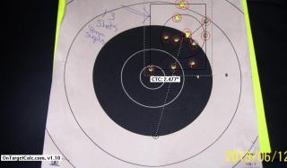

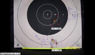

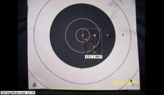

    First off thanks to you gents for the tips. This old war dog has a little life left. Im not looking for a tac driver. I dont mind tinkering with these old irons. Helps me improve my skills. This might be a a new barrel project as soon as my barrel vice and action wrenches come in? Also like to thank majspud for this link. http://forums.gunboards.com/showthre...ussian-capture
    Tutorial: How to restore accuracy to your Russianicon capture.
    This was very helpful and also lead to some more good links. I did everything mentioned except any trigger work. Its a heavy *** trigger but breaks nicely and is smooth. Im used to heavy triggers. I also did the 11' DIY recrown with tool from midway.
    All groups are @ 50 yards. I did play with elevation on some of the reloads. Next outing will to be to correct windage a bit and find a "best" of reloads to work with. So far im happy that I at least got it back to MOP, minute of pumpkin.
    This is the 1960s surplus I got with the rifle had 2 duds in the 15 rnd box. many delayed ignition. Not a terribler hang fire but enough to notice! Not a spectacular group but considering I could fit 13 shots on the paper to not even finding the 5 shots from the first test...huge improvement
    This is PPU new production "match" ammo not to bad
    This here is with reloads. used nosler 200 gn FMJHPBT custom comps. H4895 powder useing Hodgdon DATA for reduced loads with H4895. They where very nice to shoot. Not powder puffs but very pleasant. I will be exploring these loads a little more. The verticle stringing seems to be alot better also.
    I plan on doing some more reload testing. With the lands being as worn as they are at the muzzle im a bit shocked at how well this grouped even at 50 yards....now if the range lake would dry up I could do some 100yd testing.
