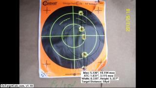

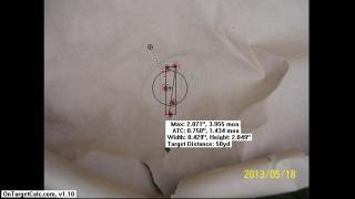

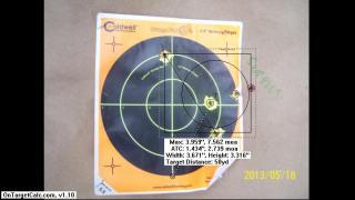

The 1st thing I did was headspace check and run a jag/patch through it and shoot it. Bore was dark but "looked" strong. I shot everything from a lead slead rest with 50lbs on it. 3 5 shot groups. 2 groups of surplus which I couldnt fit into one picture.....horrible. Then the last 5 shot group with PPU match 200gn the aim point was the blue pen X

I understand what your saying but I was useing a lead sled with 50lbs of lead on it. I shot a 80 rnd xtc earlier that day and had my routine and eye sight doing well.

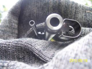

heres the crown redo i did with hand crowning tool. the before pic was lost in the transfer from camera to PC? rifling looked strong before deep cleaning, it now appears thin at least near the muzzle. If i can get this thing down under 6moa Im a happy camper. if not it will be a parts gun.
