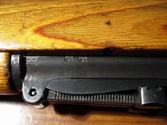

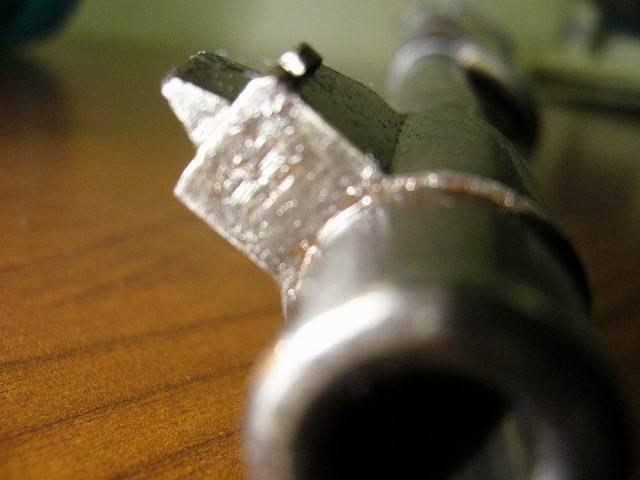

    I compared all your photos with my rifle, just the external parts since I did not remove its stock yet.
    The extractor brings serial "69" while my serial is ending by "62".
    How can this be explained ?
    Did they fit by mistake the extractor of another rifle during factory process ?
    Has the extractor been replaced later ?
    Or ... ?
    Salu2 a to2
    Bizio

    The bolt group is not original for this rifle. Someone has reprinted the serial numbers in order to make them same as the receivers ones.
    I will return the rifle back to the man who sold it.

    Nice looking rifle, however i think that both rifles have renumbered bolts. There should be a trough at the base of the handle, next to the bolt body. I can't remember ever seeing an original bolt that did not have that feature.

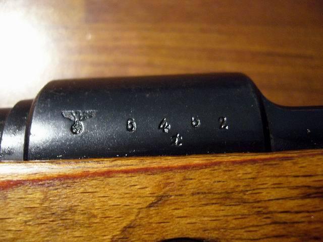

    I finally decided to buy the Mauser K98icon.
    Here are some pictures.
