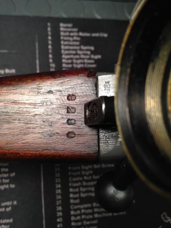

    Surpmil - Actually the butt stock seems tight into the socket. I can't imagine it would/can be any tighter, but since this is my first Enfield, you guys will have to let me know. It's on so tight, I was disuaded from removing it and looking for a serial number. Would love to know the serial number lurking underneath!
    I tried in a very discrete spot to remove the gray with thinner and it is not coming off without some serious effort (e.g., blasting). At this point I think I'm going with Ridolphe and leave it as is since it is part of the rifle's history. It would be a shame to spoil its history if in fact it was performed by a Belgiumicon armory. The application of the gray was very well done since there is no flaking, runs, etc. so I'd be shocked it being a bubba job ( I've seen them bubba jobs since I'm living in the heart of the South). If anyone out on the forum can verify the coating as challenged by Peter, I would really like to know.
    As per everyone's feedback and excellent support, it seems it is a legit No. 4 MK 1 (T) so I am very pleased with the rifle. I can deal with the gray versus a suspect (T) rifle. Picture below is of the index mark for the barrel where the serial number is stamped (see picture below). Looks like its been on there since 1945, but you guys will have to let me know.

    Gentlemen - Any useful information on the underside end of the barrel?

    Are there any US import marks on the rifle and if so are they under this grey finish or do they penetrate it?
    Where the grey is worn off, does the metal underneath appear to have been grit blasted or can you see the original finish?
    If it seems clear that it has not been grit blasted and that the original "blue" is still underneath the grey paint or whatever it is, you might consider removing it chemically. Of course being sure that however you remove the grey finish will not harm what is left of the original finish.
    I can't see a military outfit refinishing just the barreled receiver and not the bolt body at least, though it should be noted that H&H did just that during the war, after the conversion work. In that case however, the polished bolt body was the standard finish at the time, with the exception of the handle and the tops of the recoil lugs.
    Please disregard my earlier comment on the buttstock; the previous photo suggested there was a problem, but there obviously isn't.
