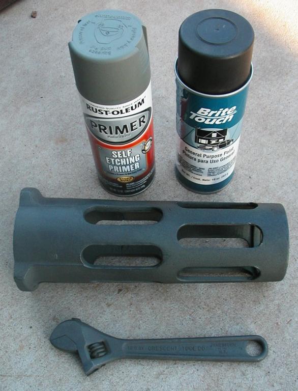

    I think you could get very good results with car spray paint on the body.

    I have read all the comments carefully, but as I said at the beginning , here I only find products like Perma Blue. I have searched and read many google sites on how to make a proper treatment, as usabaker comments, but I do not feel able to do something like that. For now I will start cleaning the entire surface of the receiver, while analyzing what kind of protection against the rust applied. I have possibility of using automotive paint, although I prefer the spray can.

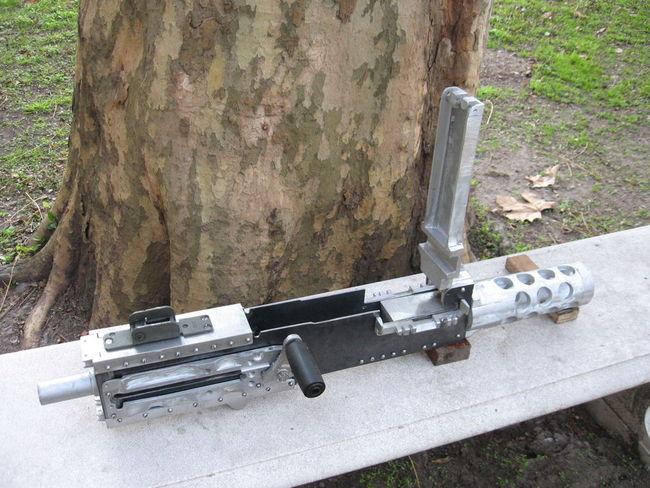

    I have other gun project.... a M2HB Dummy ...
    and years ago i read about how pain this MG, with this paint
    How will the Bren look with this painting?
    Luis

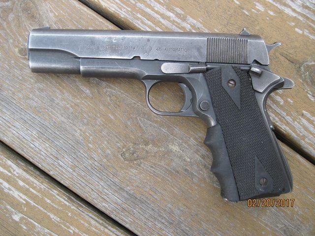

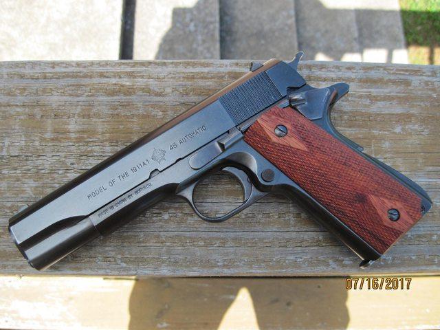

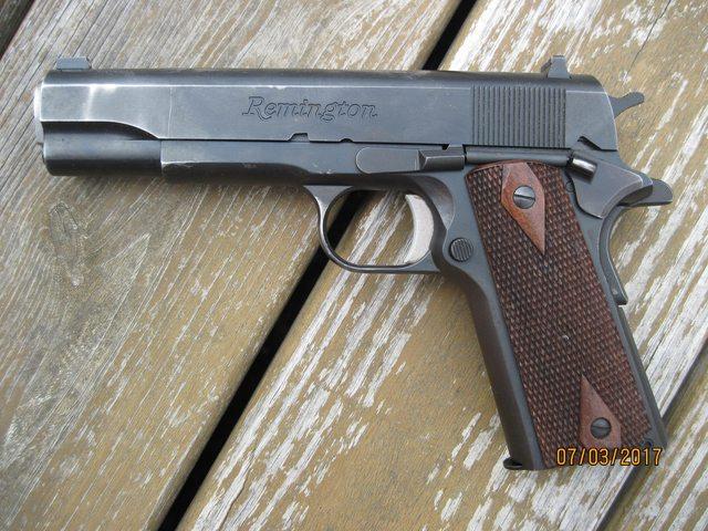

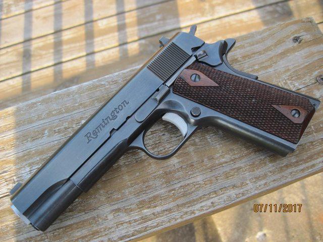

    Can you get Mark Lee Express Blue #1 in your country? If so, it's easy to use, and gives excellent results.
    Oh gee.... (Rust bluing refinishing thread) - 1911Forum
    In the above linked thread there are a lot of pictures will be dead links because of Photobucket's recent stunt, but the instructions (and results) are very good nonetheless. I've rust blued four 1911 pistols, and have been very satisfied with the results. Bluing instructions at the below link.
    https://www.trackofthewolf.com/pdfs/...structions.pdf
    Before and after below of the two most recent I've done with Mark Lee Express Blue #1.
