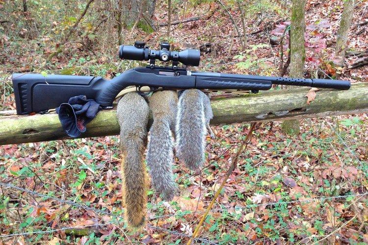

    I hunt with my 10/22 Takedown LITE with a suppressor using sub sonic ammo exclusively with no problem. I have tried over a dozen different flavors of sub sonic .22LR ammo and the ones that I have consistently good performance are listed below:
    - Remington SUBSONIC 40 grain hollow point
    - CCI SUPPRESSOR 45 grain hollow point
    - Fiocchi 40LHP subsonic 40 grain hollow point
    - Gemtech Silencer Subsonic 42 grain round nose.
    I tend to like the CCI SUPPRESSOR 45 grain hollow point the best.
