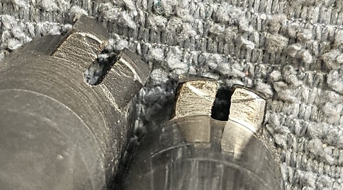

    bolt setback on a 1903. is from the bolt being opened and slammed back into the ejector, if you look at the back of that lug, it may have a dent or divot from doing so, common issue, that dent, lets the bolt set back, and can give headspace issues, if another bolt works and gauges well, then id bet this is the issue.

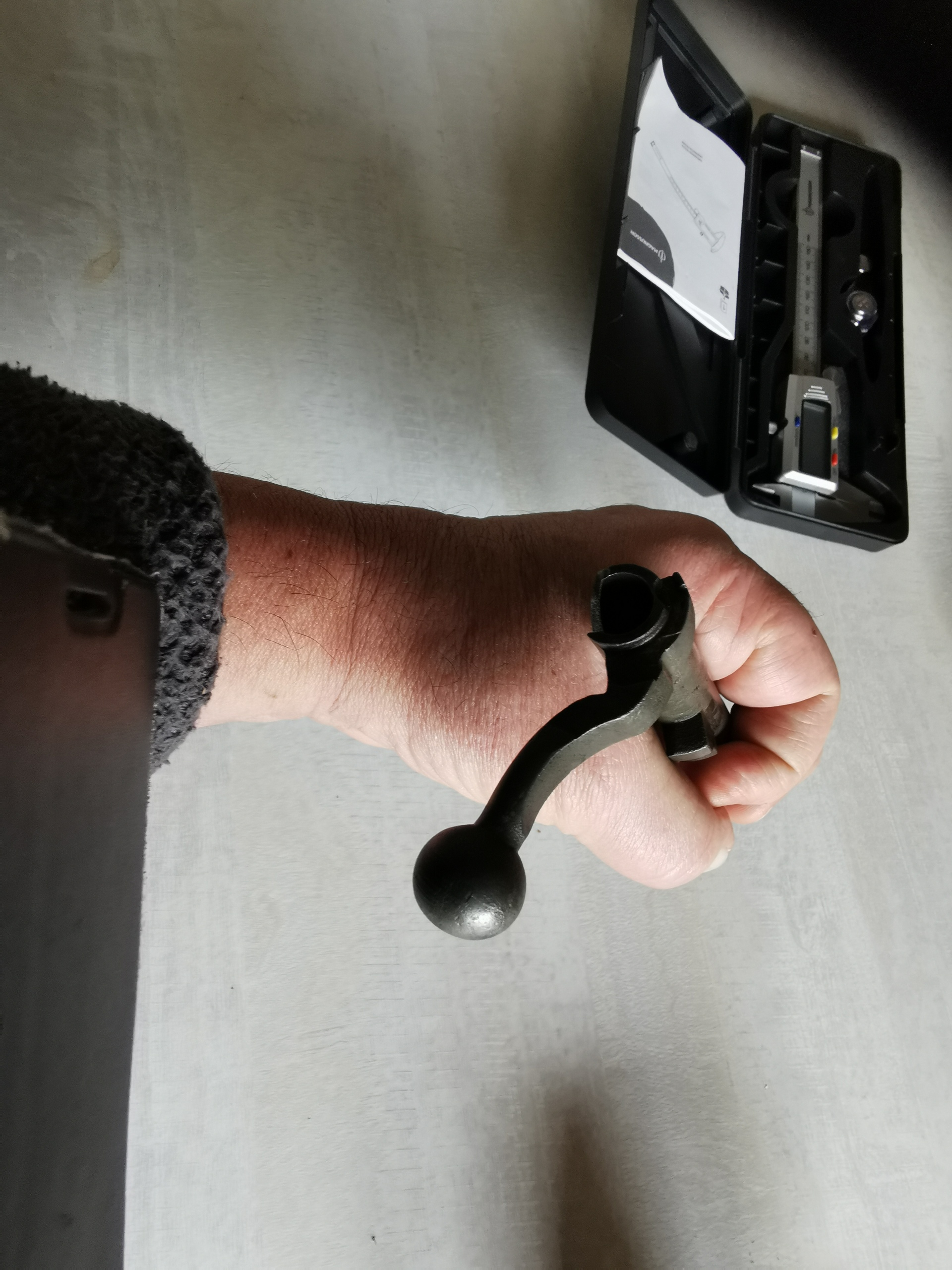

    Thank you for the offer of help that you could give me at the time when you were traveling in the EU. And thank you all for your comments.
    I am not looking for an A3 bolt body but an A4. The cocking lever is positioned well like the rear lock. This can only come from the front face of the bolt body. If I put an A3 bolt body, the headspace is OK: the GO gauge closes and the NO GO gauge does not close; for the A4, GO and NO GO close.
    The photo is indeed a cheap body bolt but I have the A4 bolt body which is authentic. My A4 comes from WW2, left in a family barn in front of the Vosges front (by the 79th DIUS or the 501st RCC (2nd DB)).
    I respect my armament and I do not slam a gauge when closing the bolt. I know how to use this equipment having been a specialist non-commissioned officer in armament for my unit.
    I found a Frenchicon importer and now I need to find a body bolt A4.
    Thanks for your interest

    bolt in your hand is not a genuine A4 bolt..

    Whatever you say, it's a bolt A4. This A4 has been in the family since 1944.

    whatever i say? maybe take some better pictures of what you have?

    think iv handled a few A4s over the years
    lets talk about headspace, beyond your bolt.. first, failing no go, isnt a end all, failing field reject is, are your gauges current made tools? forester or Clymer? or are they G.I.? is your gauge 1.496, 1.497 1.498 or 1.950? all of those are no go specs,
    is the A3 bolt your trying an original Remington or SC bolt? or is it an R marked with R3 R4 or R6? as those are longer in the bolt head then a standard A3 bolt .
    is the A3 bolt a CC marked bolt? most of those are known to be out of spec, is a BF marked bolt?
    does the original bolt have bolt set back, as iv touched on before? dont know? look.
    Forester and Clymer gauges are known to be undersized.
    have you fired the rifle, after you gauged it? and used factory ammo? not reloads. what did the case head measure? did the primer back out? these are important questions..

    bolt on the left has normal set back, bolt on the right has unsafe set back
