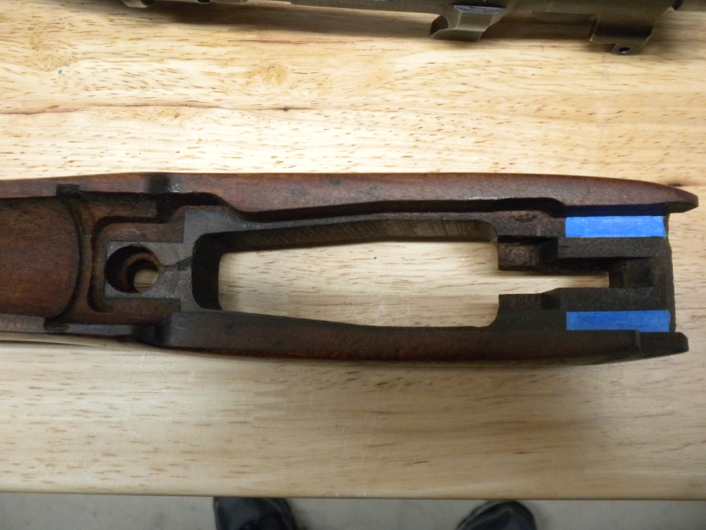

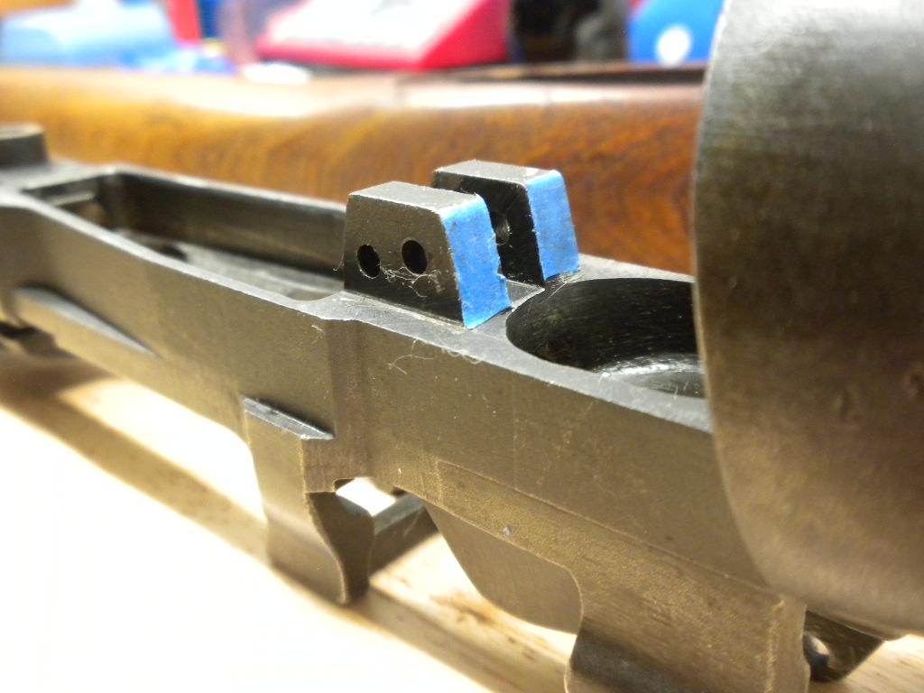

    Peter
    Sending the whole kit to Brian might be an option in the future. I wish we had discussed it when I sent him the barrels and action but alas it didn't occur to either one of us I guess.
    So onwards, or should I say back to the beginning.
    I've been messing around with the fit at the draws. I had inadvertently left a small amount of tape on the action behind the draws and reassembled it. The fit was fantastic at the rear with no back and forth movement at all. I wondered what had changed and when I took it apart I realized that I had a tiny bit of tape on the back side of the draws. Well an experiment was in order so I put 1 layer of tape (about .0045") over the entire face of the draws (picture 1) and reassembled. Fitting the fore-end again the fore/aft movement was completely gone as well as the side to side at the draws. Hmmm.
    Putting everything back together resulted in some other interesting things. The gap between the collar and the trigger guard is almost completely gone and now I'm getting contact at the muzzle. Not much, only about 0.5 pound but it's better than the negative value I had before. As for the collar I can only guess that there was something protruding from somewhere that was keeping the fore-end up a bit. That seems to have resolved itself anyway.
    Now that the fit at the rear seemed to start cooperating with me I turned my attention to the muzzle. As I said I am now getting positive contact at the front end now. So another experiment was in order. As the front trigger guard screw is a pivot point instead of removing material at the barrel reinforce I added more tape shims to the back of the fore-end (picture 2). A temporary measure, If I don't remove any wood, I won't have to put it back! I added around .018" at the rear and that brought the muzzle force to around 1.5 pounds. Admittedly a bit on the low side of the 3-7 pound range but at least I appear to be moving in the right direction.
    Got to fly the jet for the next week so I won't be able to work on her for a bit, but as always your comments are greatly appreciated.
    Stuart
