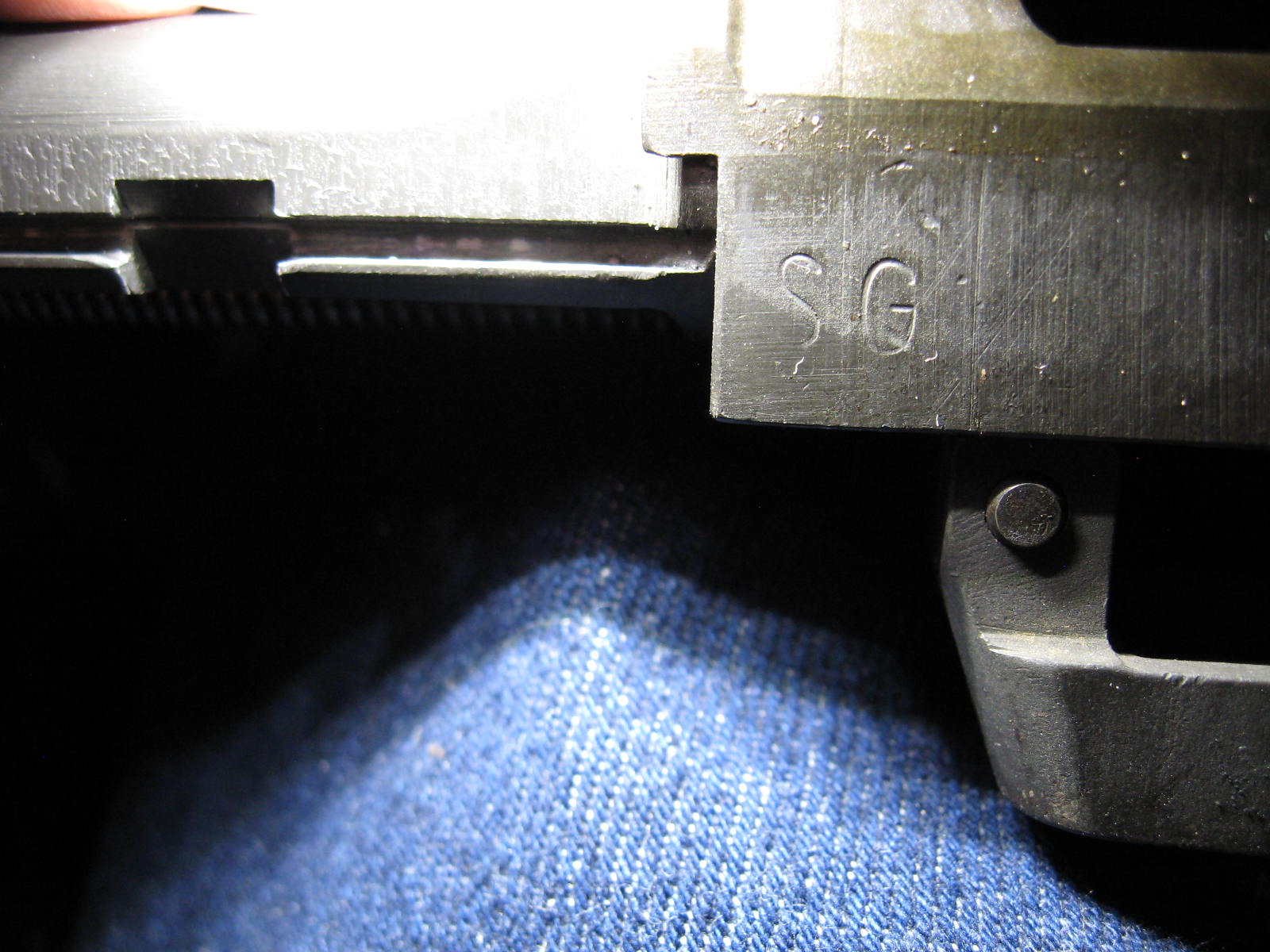

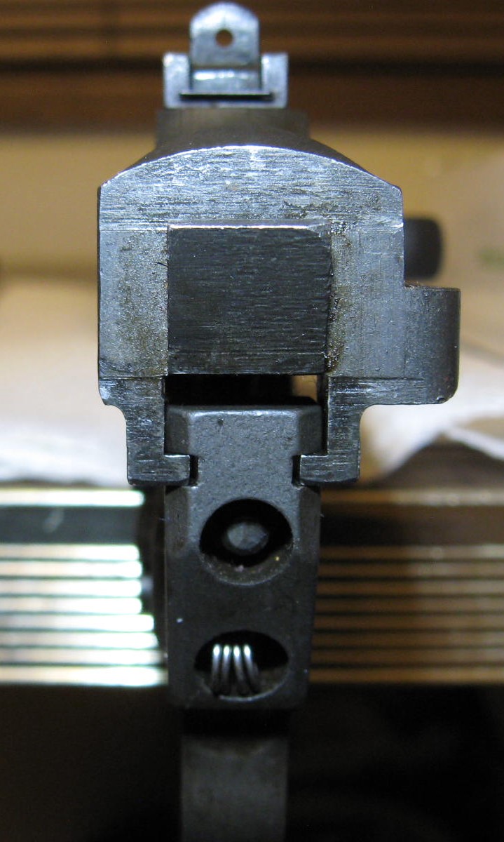

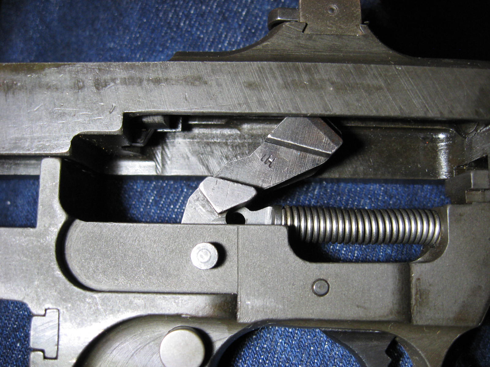

    Well, I'm a little late too - nice day here yesterday for a change and I worked outside most of the day. Did take that Inland out of the safe last night and have a couple pictures. Don't think I ever had the action out of the stock before though, believe I would have counted the coils for the hammer spring first thing. Question for those knowing more about these SG receivers than me, how come mine has a narrow tang? My receiver does have a small hardness test mark on the RH side directly behind the operating slide channel. JD, the punch mark ahead of the rear sight is placed after test firing of the carbine. - Bob
