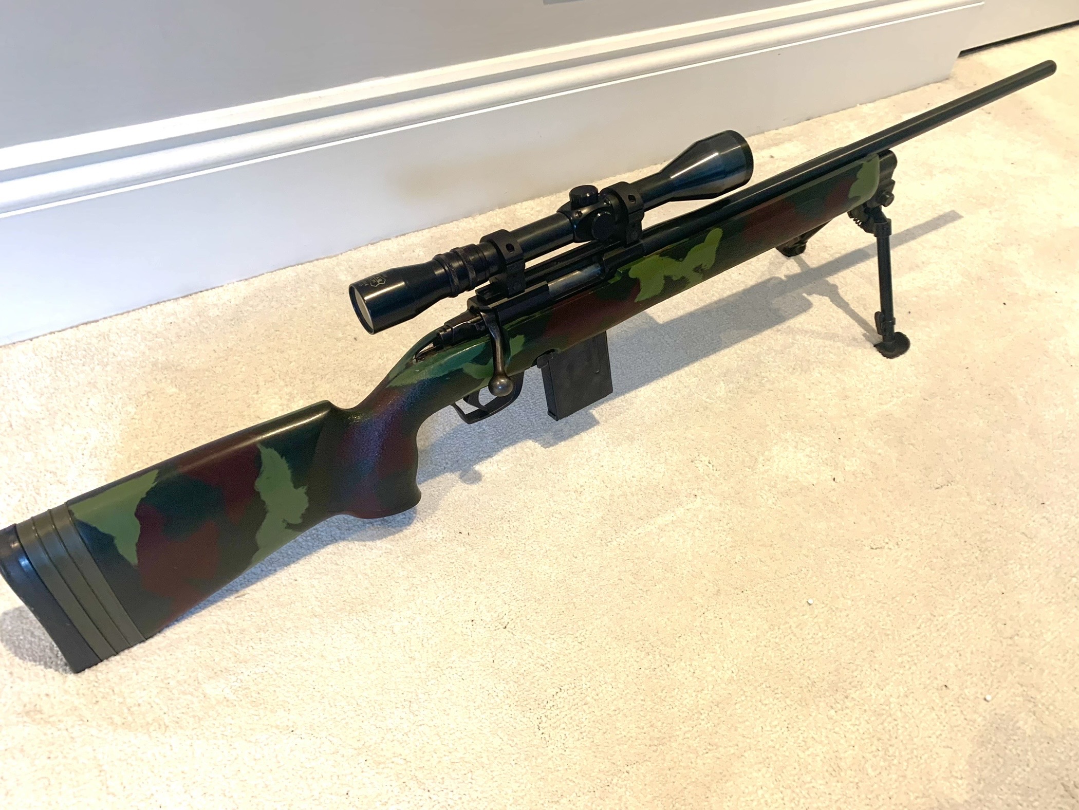

    Apologies for jumping in before Gil or John reply but I wonder if you've seen the info Holts published on that rifle when they sold it in 2020? The below is from their catalog listing.
    'A RARE 5.56x45mm NATO CADET GENERAL PURPOSE TARGET / SNIPER PROTOTYPE BOLT-MAGAZINE RIFLE, serial no. CGP0005,
    23 3/4in. unsighted nitro barrel, fitted with a Pecar Berlin Variable 4-10 telescopic sight, no safety, folding bipod, detachable magazine, synthetic stock with camouflage effect finish, weight 12lb. 15oz.
    Provenance: the1980's saw the adoption of the 5.56x45mm Nato cartridge as the second standard service rifle cartridge for NATO forces as well as many non-Nato countries. One of the forward thinking military research establishments of the time proposed a 5.56mm sniper rifle so that every member of the squad in the field would use the same ammunition. Unfortunately a lack of suitable ammunition at the time meant that this concept was dropped. The appearance a few years later of the Australianicon-made 62gr SS-109 projectiles together with the new F1 5.56 cartridge cases later prompted a conversation that would see the creation of this rifle. Parker-Hale had done some preliminary development work on a Cadet General Purpose rifle for school cadet work. The MOD dropped the proposal leaving Parker-Hale with a few prototype actions but no barrels. Greg Matthews was a former rifling subcontracter to target rifle manufacturers MAB Engineering and consequently had a few 10" twist Delta blanks available. These were sent to Englandicon and the result was a 5.56 CGP target/sniper prototype capable of 0.5" groups at 100 Metres.'
    Legacy Member Jacob's Avatar
    Sep 2021
    09-15-2024 @ 08:14 AM
    Wiltshire
    50
    Jacob
    05-10-2025
    04:49 PM
    Thanks Desperatedan, I have seen that before, I bought the rifle from Holts a few years ago! Would be interested to see what info is on the PH records if it's on there.
  7. Thank You to Jacob For This Useful Post:
    Apr 2013
    02-12-2025 @ 05:16 AM
    4,772
    Gil Boyd
    05-10-2025
    03:49 PM

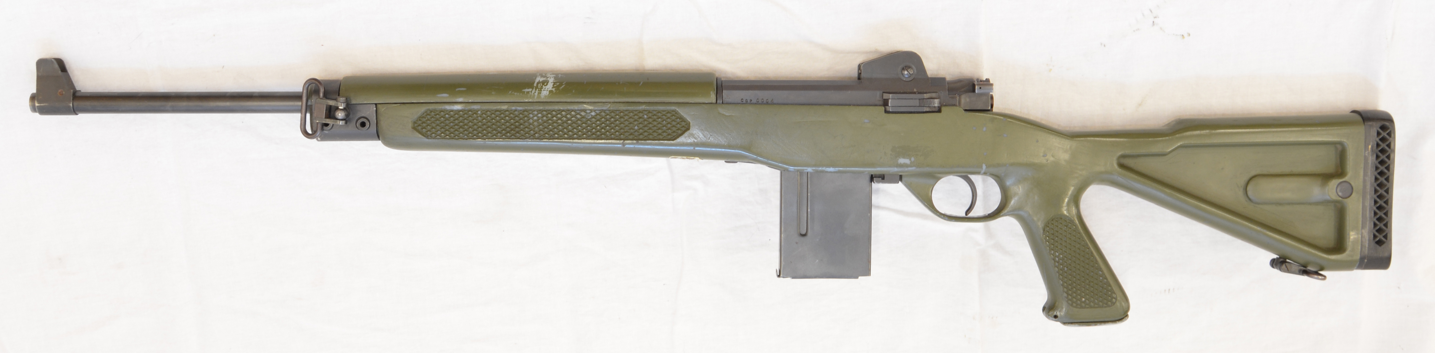

    This is number CGP 0004 in the photo below
    Reference CGP 0005 AT ENTRY 542 in trhe records it simply says: 5.56mm Alloy Bipod NO SAFETY in M85 Jungle Stock no scope fitted. Australiaicon for tests Page 67 in Bill Smallwoods Cambridge Book in the records

    I was also given this article about the rifle when I got it too. I have also added a photo of mine.
