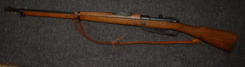

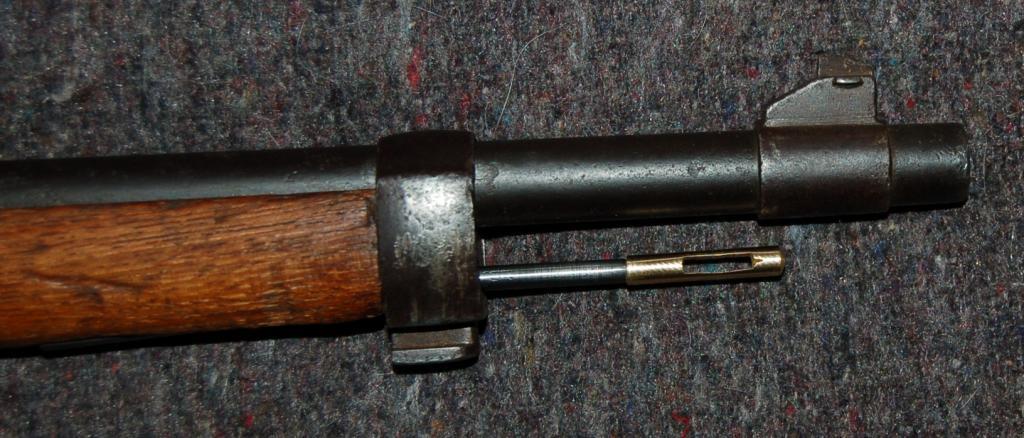

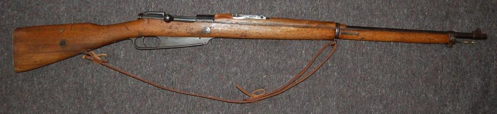

    Here are some updated photos. I'm happy with it. I made the cleaning rod out of a stock piece of steel rod and a brass bolt filed down to size using a file and a drill and then cutting the center out with whatever worked, drills files, etc. It is screwed onto the rod. Rod fits both ends. Hand guard came from Numrich and started life as one of the Turk Mauser hand guards but I don't know which one. It took a lot of fitting but is shaped to match from photos of others I have.

    That turned out very nice!

    I agree, overall well done. However, I would replace the brass butt plate screws with steel as was used on the original construction.

    That is something I might do. Brass were used on a lot of Turks and I had them on hand. If I come across some steel ones I'll replace them.

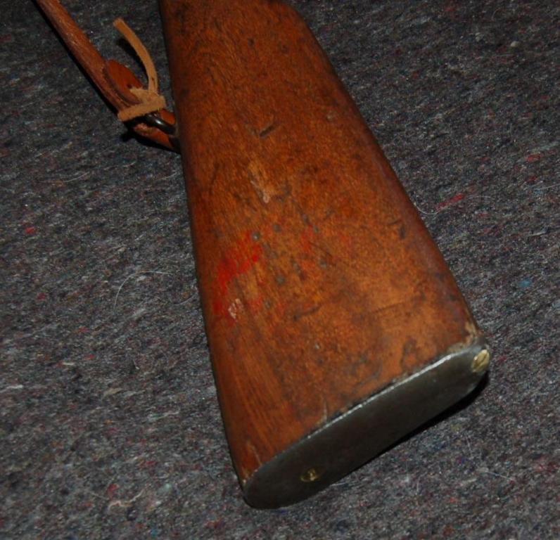

    Aragorn243 -- I happened up on this post whist doing research to support some repairs I am doing on a Hanyang 88 rifle I recently acquired.
    The buttplate on your rifle intrigues me. Did it come with the rifle? Or did you source it from somewhere?
    My rifle evidently had a buttplate at one point ... but it was later replaced with a piece of sheet metal, which was nailed into place.
    I intend to drill-and-dowel the original screw holes (which are all rotted out) and then install a replacement buttplate, but I am having some difficulty locating a buttplate that matches the contour of my buttstock.
    Ostensibly, any "flat" Gew 88 or Gew 98 buttplate should work as a replacement, but that isn't proving to be the case. My stock -- like yours, it seems -- lacks the slight curve inward designed to cup the shooter's shoulder, and no buttplate I've ordered has proven to be a good fit. Even a buttplate sourced from another Hanyang 88 didn't match up.
    Any suggestions?
