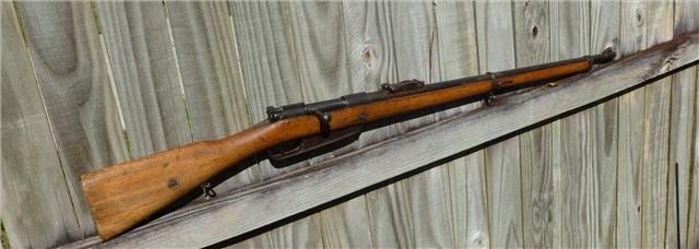

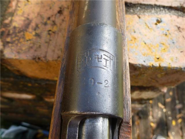

    I've been watching for these on Gunbroker and they are either beat to crap with what I consider a very high price or just an even higher price and still beat to crap, just not so bad.
    There's been a "Wall Hanger" listed for the past week and I was the winning bidder today. It has issues but supposedly has rifling which is a plus.
    It looks to me like someone tried cleaning the stock and cracked it in the process. As I need one to stick my bayonet on and point and say, "this is a Chinese Mauser" it should be fine for my purposes. Can't wait to get my hands on it and see how bad of shape it's in. Compared to most I've seen on there it doesn't look too bad. Hopefully it is functional or can be made to be functional. It at least looks complete. I don't know the condition of the stock beyond that one large crack. He said it has lots of cracks but the other seem minor.

    Hanyang

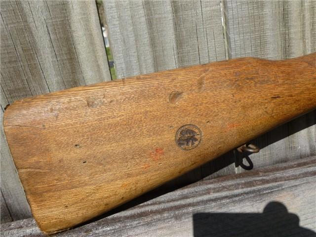

    First - and most important to the Chinese - the swastika is the mark of HANYANG (the usual transcription), the city where these rifles were built, not Hunyaug. Maybe it seems a bit picky, but Han is the mythical ancestor of the Chinese, so this is a pretty basic element. Or what would you think of a Chinese who wrote that the Statue of Liberty was in Naff Yolk Hardboard? Stick to the standard transcription - it makes it easier to find information.

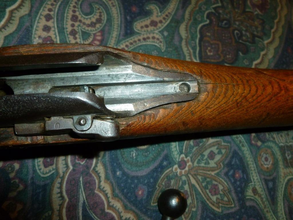

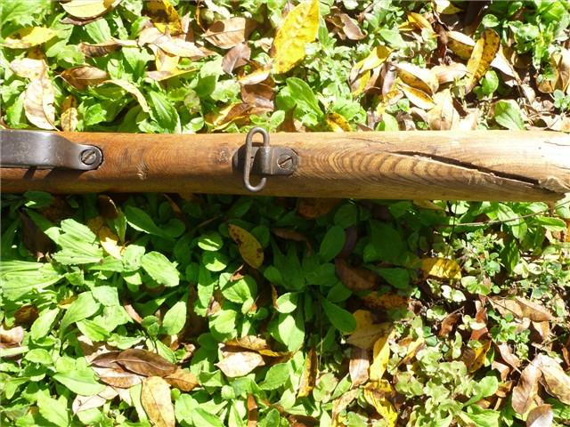

    Second - I once had to scrap a Chinese Mauser, for the same reason that is apparent in your example - the wood was appalling. Obviously not properly matured, and a poor cut, developing shakes from the shrinkage and a twisted grain - as you can see at the back end of the butt. This looks horrible, but is essentially cosmetic.

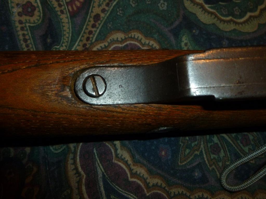

    But the crack that would soon become dramaric if you were so adventurous as to fire it, is the one that starts behind the tang.
    I do not think so. This is the classic Mauser split (not only in Mausers, of course) caused by recoil that is not being adequately taken up by the recoil bolt behind the front trigger guard screw. Wood shrinkage means that the tang, which should have a visible clearance in the recess in the stock, is tight against the stock and acts like a blunt wedge when the improperly located system is rammed back by recoil.
    Over-enthusiastic restorers please note: this effect is the reason why you should NOT use force to try to remove the recoil bolt. All you will do in most cases is loosen its fit by the twisting action of unscrewing, which - if it is to be a shooter - may lead one day to such a crack. If it is stuck, let it be and clean around it.
    But that is academic in this case. I would not even attempt to fire it. Based on the example I had in my hands and the photos of this example, it is strictly wallhanger material.

    I picked it up today. Definitely a wallhanger. The front of the stock is cracked nearly halfway. The crack at the tang doesn't appear to go that deep but the stock itself just feels light and looks like it might have worm damage. Bore has rifling but not much near the muzzle. Did not try putting a bullet in it yet. Barrel has some pitting on the exterior but not as bad as my Swede. I need a hand guard and a butt plate for it. Looks like there might be some parts interchangeability with some other types, have to investigate this.

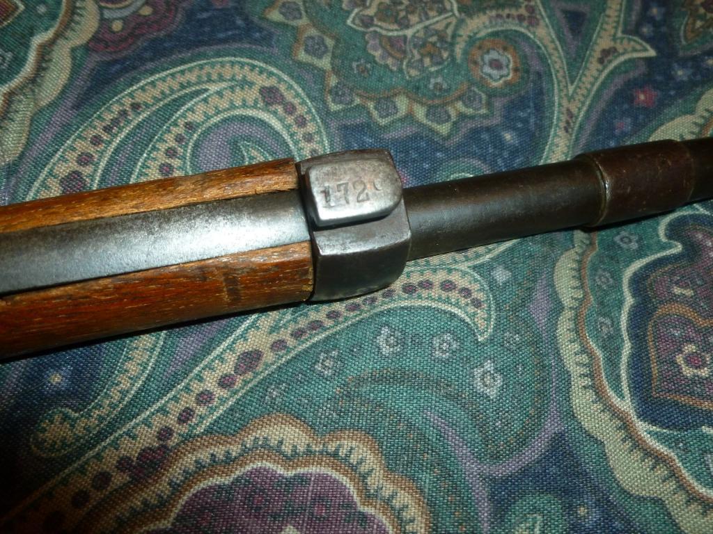

    Forestock is cracked 8 inches, basically split down the middle. Wood is not oil soaked so something should stick. I need to build up a few areas on the inside where there is missing wood.
    Missing the hand guard. Turk hand guard will fit perfectly with shortening about an inch and removing some wood from the interior rear.

    Minor cracks in butt I can glue shut, big crack I'll probably fill.
