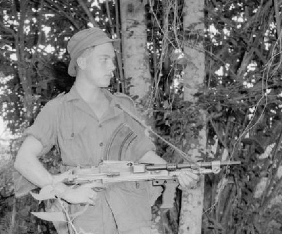

    Cheers! I'd seen news reel with Aussies advancing to contact with Brens held at hip height so thought it must have had entered doctrine for jungle fighting. I think Kev sent me a drawing of a Australianicon proposed forward hand grip to fit on the Brens folded bipod to make this easier.
    Somewhere I have a pic taken during the Malayan Emergency where the slings been rigged for firing from the hip, there's a 100 round mag fitted and the bipod has been removed or at least stripped down to lose weight and reducing snagging. I vaguely remember it had a modified Owen fore grip fitted. If I could remember the unit I'd probably be able to find it. You kinda suspect it was loaded with tracer ( there was no raised sights) and on contact the gunner just emptied the lot to keep the CTs heads down!
    ATB
    Tim
    06-06-2025 @ 12:18 PM
    16,667
    06-11-2025
    07:27 AM
    According to the Far East EMER, the modification (called a FEMod) whatever it was of 1952 (or was it 1954...?, don't have papers handy) gave the details for the modification. It entailed drilling a hole into the trough at the front of the butt slide - that is covered by the ejection opening cover - and fitting a specially made* pistol grip that was available from Ordnance, the bolt from the Mk2 type grip and a nut. I have a very feint copy of the original xerox local EMER. I have seen photos of others but the real thing was much further back and you could fold the bipod rearwards and stiull use the fore-grip.
    The trouble with the 'others' and those 'lovingly recreated for the discerning re-enactor' touted on those auction sites are too far forwards and not rigid enough. The very last thing you need on a rock and roll Bren is a sloppy fitting grip, believe me! And don't forget, the reason it was positioned some 3.5" rearwards of the front mounting pin hole was so that the shortarsed Gurkhas, Malays and Fiji etc etc troops could use same.
    *The EMER spec/authority for the modification says that the grips were a specially made or new pattern but according to two old Armourers from the Armourers Association I corresponded with both separately stated that they weren't new but just modified existing patterns, chopped and shaped to suit. The FEMOD doesn't seem to include the small steel anti-rotation peg either but maybe it's there but doesn't show on the flimsy xerox copy I have. It would always be worth looking under the butt slide of Mk2 or 3 butt slides/guns to see whether any trace of the larger (and smaller anti rotation peg) holes are present or have been welded up.
    Legacy Member Kev G's Avatar
    Mar 2008
    03-18-2025 @ 09:32 AM
    564
    06-11-2025
    06:27 AM
    While the subject has gone on to forward grips :-) has anyone a clear pic of a Bren in Malaya that has a forward grip that ISN'T off an Owen gun ?
    Pic above has forward moded Owen grip but no flash hider,bipod or rear mounting bracket.
    ATB KG
    16,667
    06-11-2025
    07:27 AM
    Those omissions beg a lot of questions KG! Doesn't look like it's got a backsight either so how on earth do you aim and shoot a sightless gun? And why on earth would the bloke be holding a duff Bren by the (soon to be glowing red hot) gas cylinder instead of the pistol grip. But there's more.......... If my old eye's aren't mistaken is that an original two-vent gas cylinder. If it is, you haven't got a Bren machine gun, you've got a Bren straight pull single shot rifle. Scaling up the barrel from the gas block forwards it looks like it has been cut short too. Maybe it's just me but I think we need to see a bit more or know a bit more about that, er....., thing!
