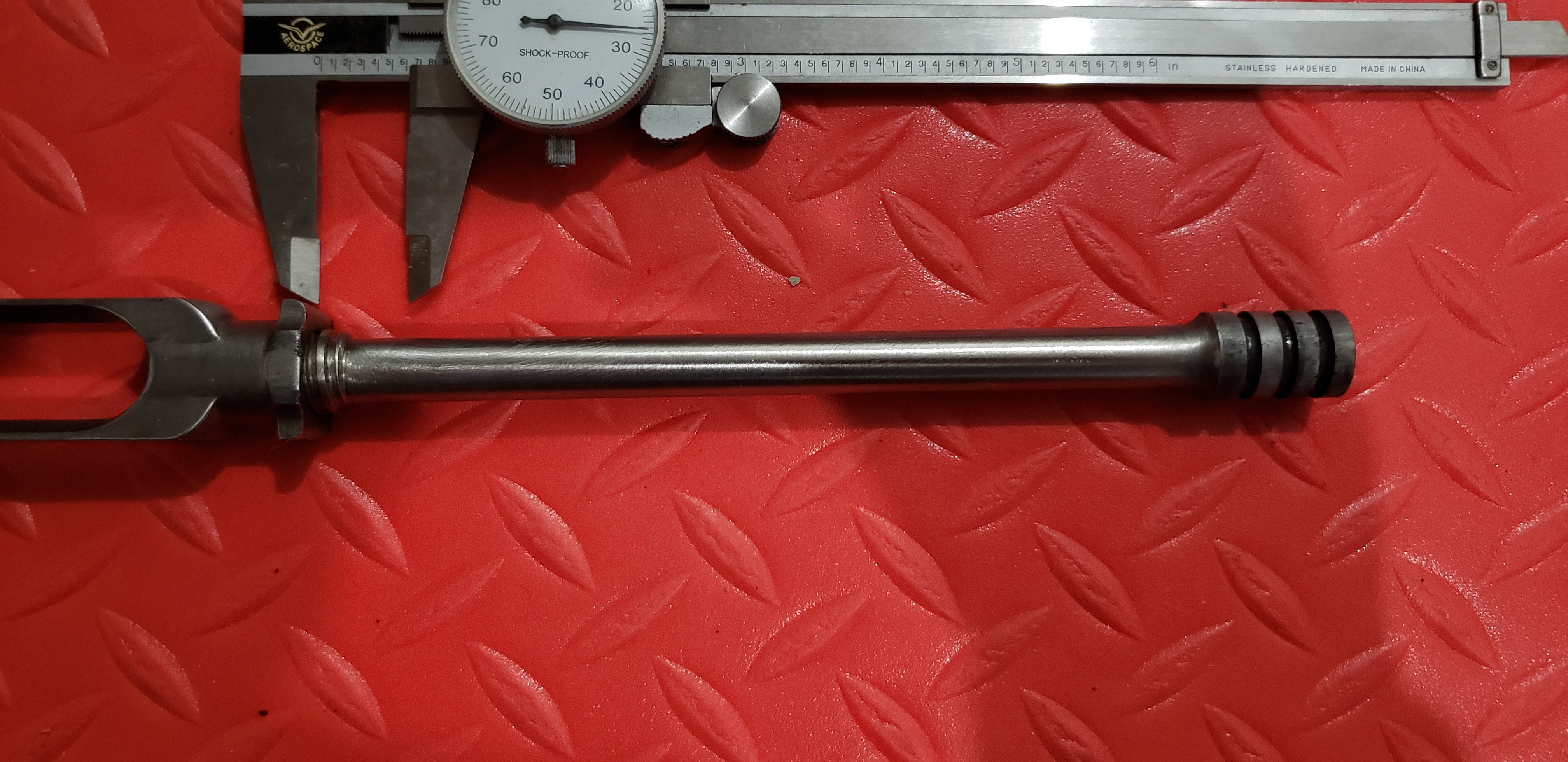

    The gas cylinder ID .634" +.003".
    The piston is scrapped if the head is .618" or less.

    I measured the OD of the piston head and it is 0.625, so should be in spec. I measured the front of the piston, behind it seems slightly larger at about 0.628.
    I attached a photo of the piston on the op-rod. It isn't screwed in all the way and has a slight wobble to it. I assume this is correct because there is a pin going through it and I would guess that the pin is only in a certain spot. Please correct me if this is wrong.
    I don't have cold blue at present time, but could check it in the future. For know though, I'm still on the hunt for the reason why this thing is having cycling issues. I haven't had it out in a while and will try to go to an indoor range here in early February. Following the move I no longer have a go to range, which has been making things difficult. I found a place in town which should work. However my time may soon be occupied since my wife could have our second child at any moment and I may lose chances to get this figured out.
    Since it has been a while as a reminder, the problem now isn't the cases rupturing. That seems to be fixed following headspacing. The issue is either short stroking with occasional stovepipes (underpipes?), vs overgassing and the same issue. On 2, it won't cycle and pick up a round, on 3 it is jamming. Since it is having an occasional stovepipe, I assume it is overgassed on 3. I have calipers, but not sure how accurately I can measure the ID of the gas ports. If you have measurements to compare I could check those. Seeing as this is an HA gun, it sounds like they are usually reamed/drilled out a little already.
    As always, I appreciate all of your help and will hopefully have this thing working again in the near future.
