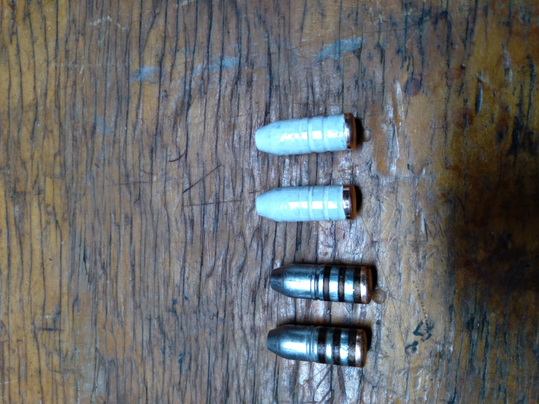

    Thanks for the offer BJung I purchased a toaster oven at Walmart for 20.00 and have some bullets cast from the Lee molds they worked fine for me.
    I have some powder coat from Harbor Freight and used some plastic BBs they don't look pretty but have the coating I think will work.
    I also have some lubed so I'm waiting for a good time to get to the range and see what the results are.

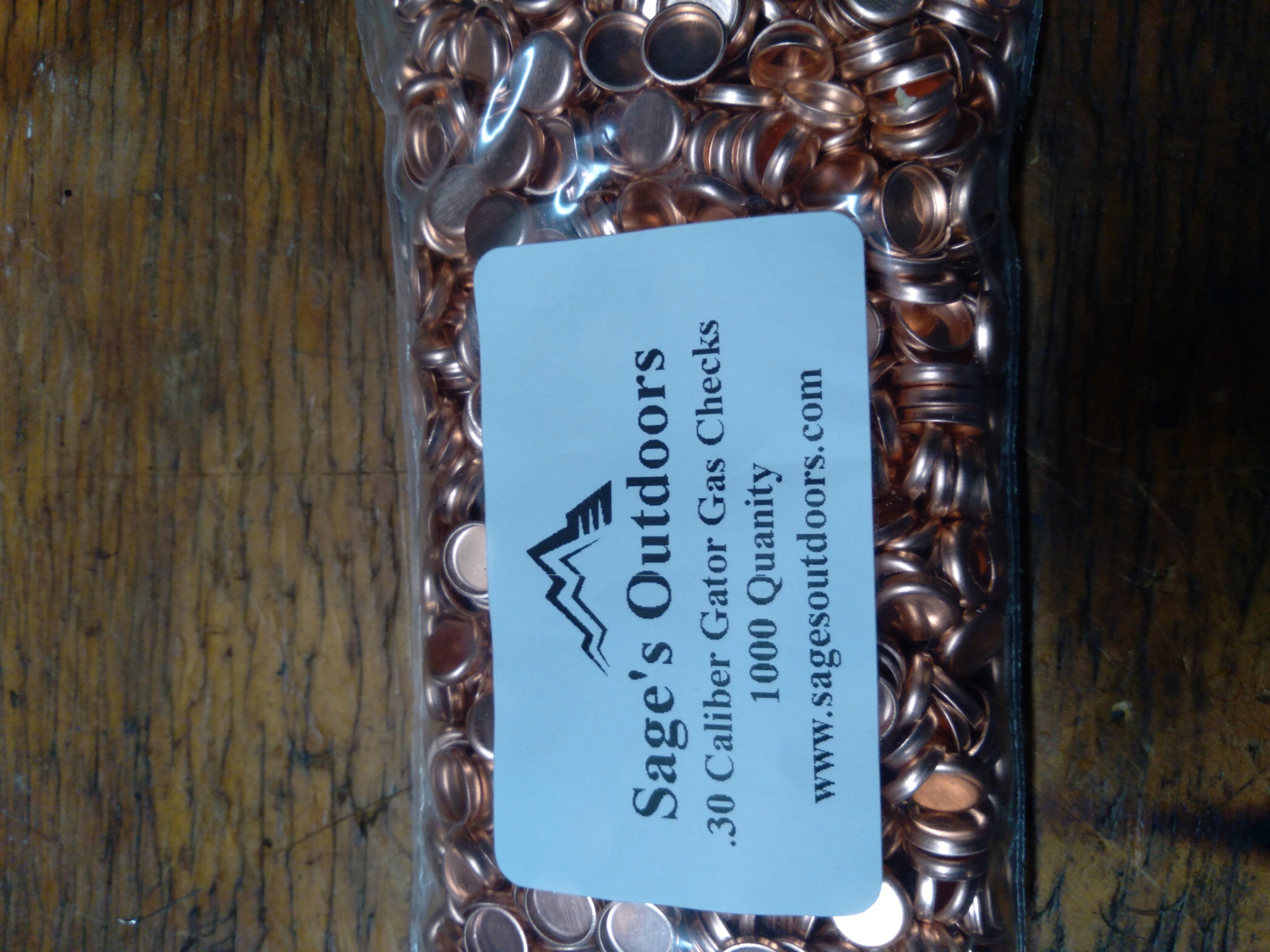

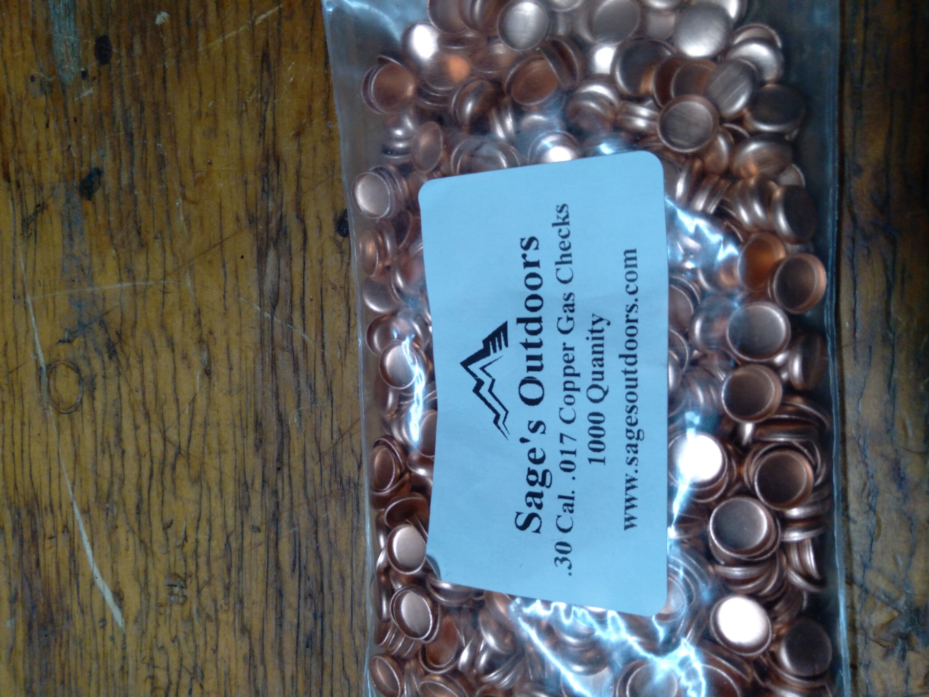

    Here is some gas checks I found at a good price.
    The copper checks were 28.00 + Shipping
    and some finished bullets
