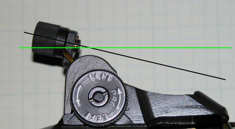

    The base of the rear hooded sight is not ground down. To remove the sight I have to remove the whole sight base. I cant just run it out by going up all the way.
    Perhaps I've misunderstood the change I'm contemplating. If I lower the front blade and leave the rear sight height unchanged then effectively I'm moving my impact point out to a further point because I now have to raise the front up the amount I shaved off.. Right?
    So if I remove material from the front blade and lower the rear sight height (assuming the ~8mils of material per moa) I can then have say 6-8 clicks up for 100 yards instead of the 12 I'm at now. This also means that when I attempt to shoot 1000 yards my sight height isn't up as much as it would have been before I lowered the front post.
    Currently, with the sight the way down the rear sight comes up 51 clicks to the 1000 mark. From there I have about another 15 clicks before the sights reaches its max height.
    With the sight up 51 clicks the rear aperture beings to oblong and depress in the hood as seen through the rear sight. I believe this is do to the change in angle of the hood which is now pointing down somewhere mid barrel. And I'm not looking up through the sight looking for the front blade.
    Here is a photo.
    Ideally I'd like both of those lines to be the same but I'm only willing to remove so much front sight...
    Anyways, that's the game plan. So far.
