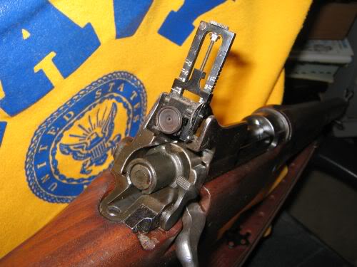

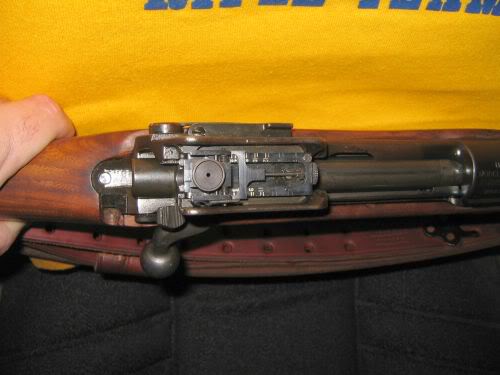

    Yes, the National Matches were fired in 1918. However, the prescribed Service Rifle was the M1917, NOT the M1903. It was also also the year of the first Small Arms Firing School. The purpose was to familiarize shooters with the new M1917 rifle.
    Pix are of an experimental rear sight for the M1917 that is believed to have been the prototytpe "National Match" sight. It has one minute click adjustments for both windage and elevation.
    The sight was not produced in time for the matches; in fact the only other example of this sight that I have seen is one fuzzy picture in one of Bruce Canfield's books. The matches were fired with the regular issue service sight. Data books printed for the matches had graphics illustrating the "hold off" required for various strength and value of wind.

    Quote Originally Posted by Bob S View Post
    Resp'y,
    Bob S.
    Bob,
    The sight on your rifle looks like it may be a Britishicon sight. I note in your pictures that it appears taller than a standard Model 1917 sight. I speculate that the range graduations (elevation) do not match those of a Model 1917 sight.
    J.B.
  8. #7
    Rick the Librarian's Avatar
    Nov 2008
    04-09-2023 @ 08:59 PM
    NW Washington State
    75
    2,301
    Rick Slater
    12:02 AM
    For what it is worth, the rear sight on Bob's M1917 appears to be the same as an experimental sight described and illustrated in Bruce Canfield's "US Infantry Weapons of the First World War", p. 84.

    Rick:
    Yes, that's the picture that I refer to.
    John:
    Definitely not a Britishicon sight. It's made on a standard US sight leaf.
    The Marine Corps shop that was near the Boiler Shop in PNSY also started development on an "improved" sight for the M1917 when it appeared that the M1917 might supplant the M1903 as THE Service rifle. The Marine Corps sight was not a "match" sight, but it did have windage adjustment. I have only seen fuzzy pictures of it, no physical examples, but the sight looked a lot like the last sight that was used on the BAR, with the windage knob through the right "ear" on the receiver bridge. (The first BAR's had the very same rear sight leaf as the M1917 rifle).

    Fine looking sight. How does it shoot?
