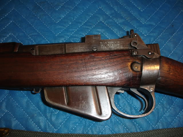

    Which factory made this No. 4 Mk I?
    I have a well used No. 4 Mk I that I can't clearly identify which factory/armory made it. I'm hoping someone on the forum can help.
    The No. 4 Mk I marking on the action body is very faint, as is the serial number. The date - 1943, is the strongest marking, and as best I can make out the serial number is 7x12 or 7x42, with no prefix being present. The second number is most likely an 8, but could posssbly be a 5 - it is jsut too faint to be sure. There is a stamped letter "B" above the date on the buttsocket and on the barrel. On the action body next to the safety catch slot, there is a stamped letter "M". Note that the "M is covered by the safety locking bolt when the safety is in the off position. There are no conversion or FTR makrings that I can find, but there are numerous Britishicon accpetance and proof marks.
    Pictures are attached.
    Thanks in advance for your help.

    Most probably BSA.

    Yup, I'd also say based on the marking it's a BSA. The position of the 1943 and the 'No.4 mark 1" look typical as does the hole in the bolt handle.

    C.I.A. is Century International Arms. It's likely one of their 'assembled out of parts bins' rifles. Check the headspace before you shoot it. Century used no QC of any kind. Not even checking the headspace to ensure the rifle is safe to shoot.
    Once you've checked the headspace, slug the barrel(hammer a cast .30 cal bullet or suitably sized lead fishing sinker through the barrel with a 1.4" brass rod and a plastic mallet and measure with a micrometer). Barrels can measure between .311" and .315" and still be considered ok. Over .315", the barrel is shot out.

    and portions of the safety are missing.

    Well spotted. In fact it is the important 'portion'.

    I think jbrid just removed the safety for some photos so the ‘M’ underneath it could been seen. The safety is present in other shots.

    The part that is missing is not the operating lever of the safety, it is the safety catch. (The part that engages with the the side of the bolt. It is clearly missing from the two photos in which it would be visible. It should protrude from the hole to the right of the letter M and is obviously not there. (It would not need to be removed in order to photograph the letter M.)

    It's a wartime No4, the safety catch is most likely missing because the locking bolt is a Mk2 and was never threaded for the catch.

    It is there in one of the other photographs.
