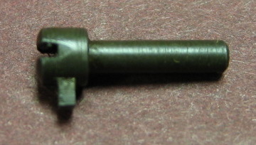

    Even though it is slotted that is not a screw in the magazine release. It may be broken off down in the mag release by someone thinking it was a screw.

    If the magazine catch operates normally, the slotted part of the magazine catch lock may be broken off. If it just doesn't have the mcl, the magazine catch shouldn't stay in the receiver.
    If the slotted part is broken off, you may have to drill out the part that has lock on it in order to remove the magazine catch to install a new one. The mcl has a pretty stout little spring on it.
